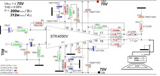

i just have to mention....
i changed the output resistor into 5W and if he's gonna burn gonna raise to 9W..
the resistors Wattages from the schematics are the Minimum i took for my circuit...
he rated the output for ~320 W / 75V / 4ohm load
i use 30 (27V onload stable) / 60-80Watts / 16ohm load

university courses began monday...so i don't have so much time now...otherwise i'm still thinking...If the max power at 8 ohms is 100wrms, this means that the chip will deliver 5A max with a good thd, and this means only 50Wrms for a 4 ohms!!!
not good...so I'm thinking to use a 4050...opinions?

dual mono...
thanx stuart, but my idea is to realize a dual mono, so to use 1 toroid for left, and one for right, so I can't use a stereo amplifier...(damn, it will cost less!!)This means that I must use the 4050...but i've seen a 4060 and a 4065...do you know anything?or...do anybody know anything???

4065 is 25+25w for car audio applicatiobs, and I don't think its what you want.
4067 is a another special for car amps, rated to drive 50w into 1 ohm.
Can't find anything on the 4060, other than it has been discontinued, so you'll need to check with your supplier for datasheets, availability etc. I should add the official status of the 4050ii/v is discontinued...
You probably already spotted this, but if you end up buying it, and you care about specifications, you might want to make sure you get the 4050v, not 4050ii, the latter has 0.4% distortion, the former 0.08%. If Sanyo has released one the 4050x or 4050xi would probably be better again, since every other part in the series is 0.008%...
Another part that might work for you is the stk404-140, it is rated to put 180w into 6ohms, with lots of distortion, but obviously the current capability is there or it would be smoked. Plus this part has a simpler application circuit, you could build it on the pins of the device. Plus this is shown as available...
Stuart
