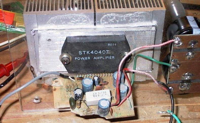

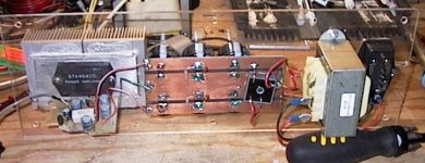

hey stuart, any chance of some pic's? and where did you get your boards? ill try and get my camera working so i can finaly post some pics.

The sad part about the boards is I just hacked up the main board from the car amp, literally...Used a dremel to get each of the 2x2 section that the module was mounted on, I just finished screwing the stuff together on a piece of perspex, or plexiglass as they call it here.
I could easily have proto'ed the board but in the end my lazyness and coolness of re-using the existing board won out...
I've taken a couple of pics, of the hacked board and the final assembly...
Stuart

heatsinks are a pair of athlon CPU coolers on a scrap of aluminium, used thermal epoxy to attach the scrap to the sinks, seems to work very well.
So far total investment is approx $35 per channel...single most expensive component is the xformer, 120va, just adequate for one channel...
Best part is that as a full range amp it actually sounds pretty good....
