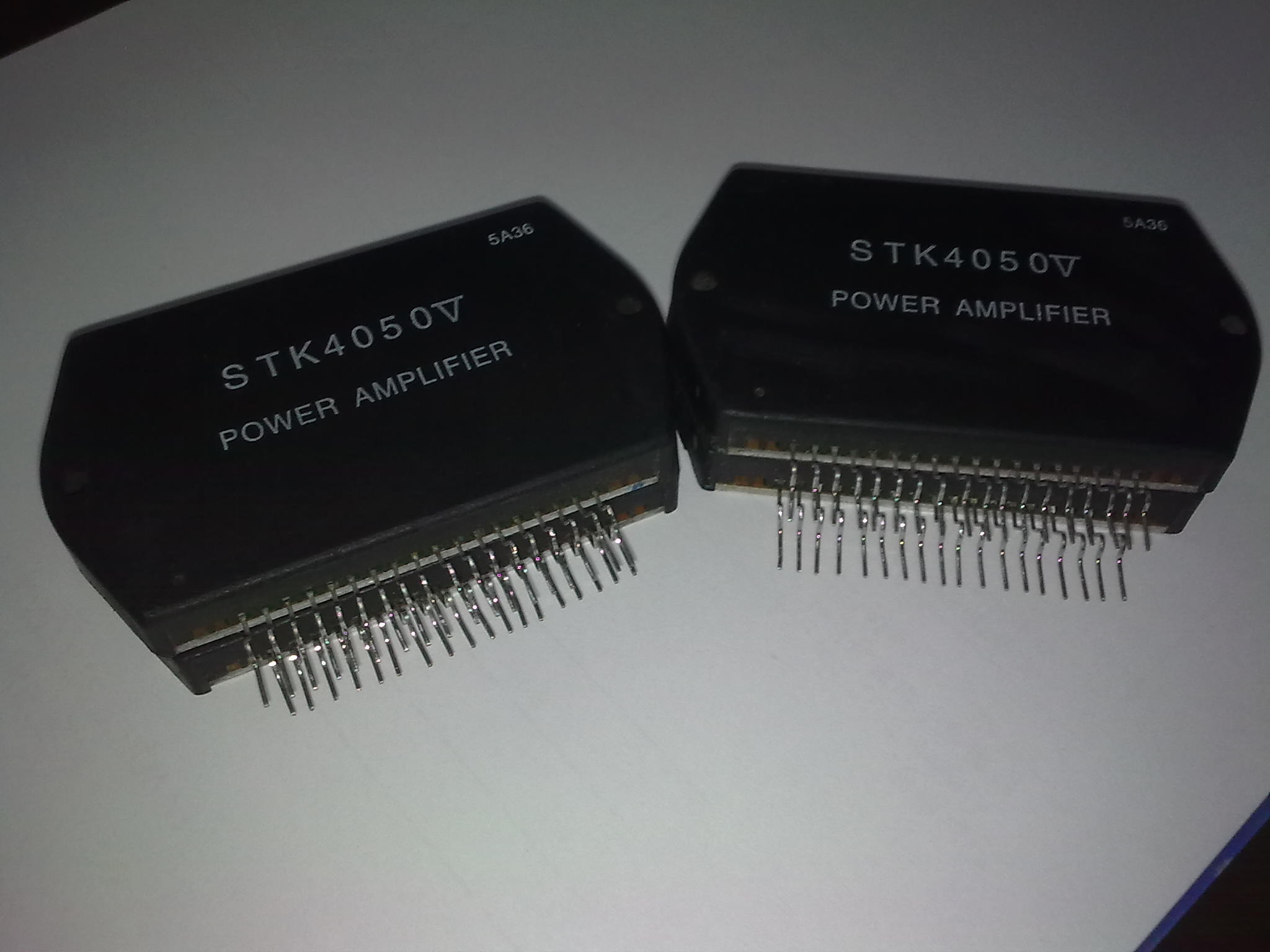

Hello Metal... Can I have your email...I have a couple of IC STK4050V with me and I purchased those from china supplier... I guess it's not the original IC from sanyo. Hoping I can have your support coz I'd like to build an amplifier out of this IC. My email is y2kact@yahoo.com. Please refer to attached image for the IC.
Thanks & regards
