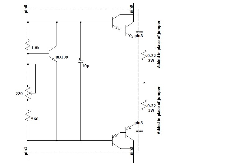

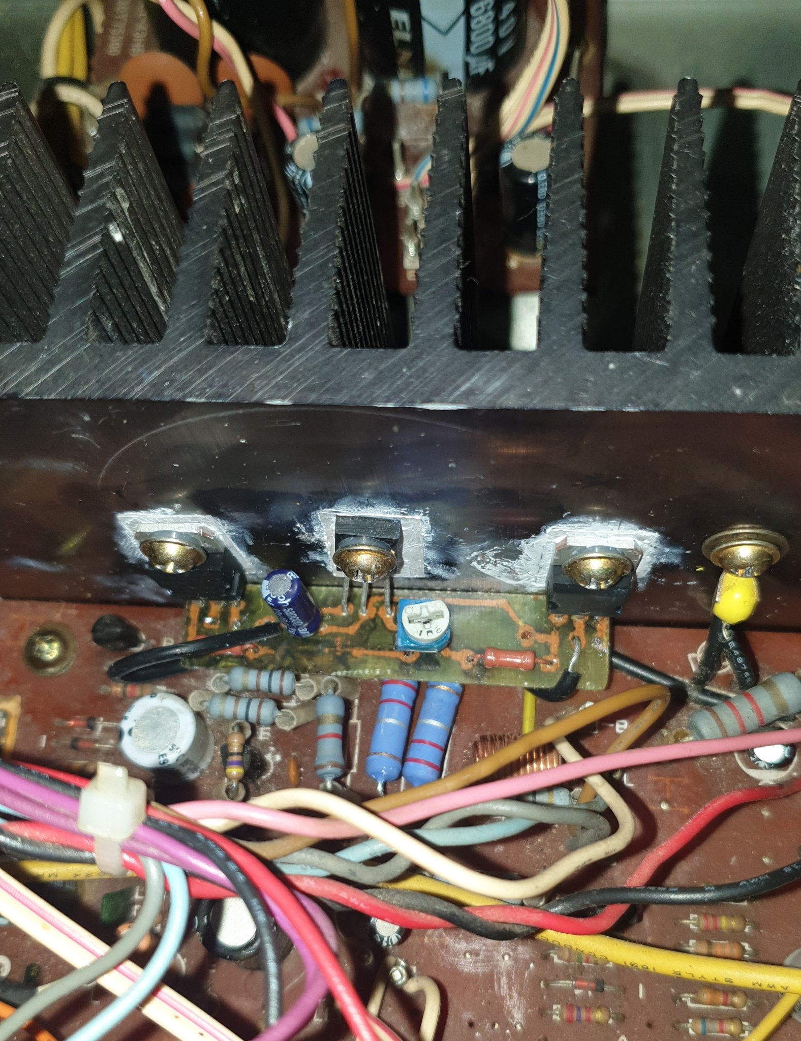

Hello,
I just revived my Nordmende PA1100 by creating my own ST0039 replacement even mine is more similar to STK0040 (fully complimentary).
Idle current is adjusted to 25mA (11mV across Pin8 and Pin3).
My amplifier had initially jumper wires instead of emitter resistors R782 / R783 so I decided to go with 0.22 Ohm 3W.
I used darlington BDW93c/BDW94c output devices to simplify and minimize construction efforts.
Works and sounds fantastic. Posting my schematic and the ST0039 discrete replacement I built,
