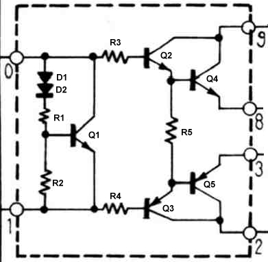

Hi people, would anyone care to comment (out of experience, preferably) on the STK0050-II? I have two of these in a Marantz SR5100 and am just curious at the way Marantz wired it up to the two transistors... Do they use the transistors as protection?
thank you
ps: sorry for some odd reason I am not able to upload a schematic. maybe it's IE9...
