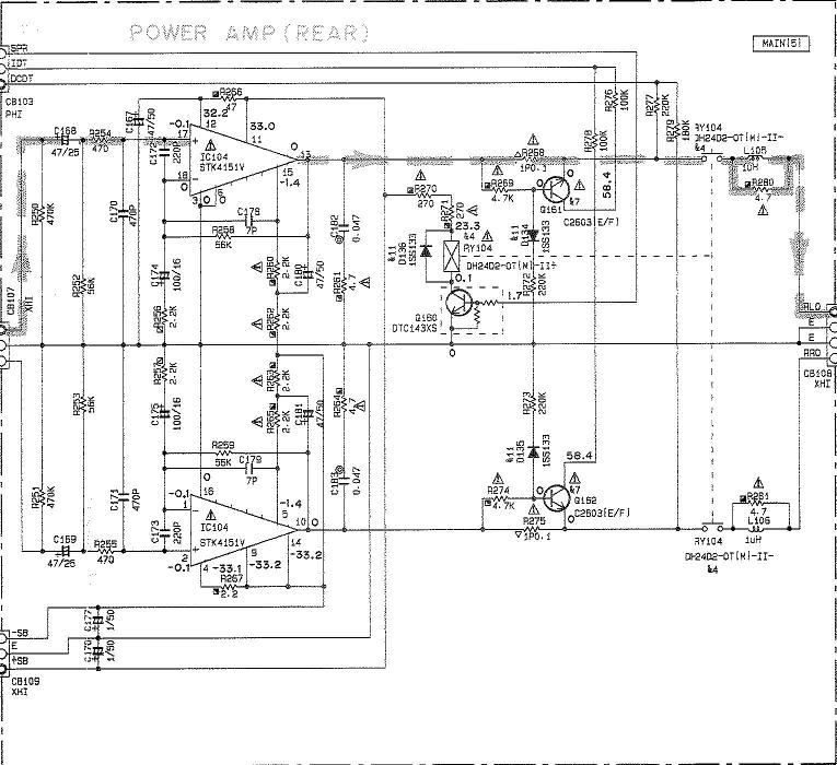

I have a yamaha rx-v870 that I believe has a bad stk 4151v chip in it. If that board is plugged in the amp never comes out of protect. If that board is un plugged the amp doesn't get any signal to make a sound but does come out of protect.
I am thinking that is the culprit, but can someone point me to where I can test it - like pin 6 and 1 should be 3.3 ohm, not 0. Like that.

You can check some of the STK module's transistors with a multimeter. Usually the output transistors short or open. Also look for matching multimeter readings comparing between channels.
Multimeter (+) to the first pin in list.
Meter on diode test:
Pin 13-12 and pin 13-15 open. Pin 12-11 and pin 15-16 open.
Meter on ohms:
Pin 13-2 and pin 13-21 high on ohms (I'm not sure what R9,R19 are on the chip)
Pin 2-7 and pin 17-21 some R reading (not open)
This works for STK4141,STK4151,STK4161,STK4171,STK4181,STK4191,STK4201,STK4211 family... STK4151 datasheets pdf

OK I got the new stk4151V chip and swapped it in.
The amp turns on and stays on if I leave connector "CB109" - Bottom left of pic unconnected.
If I connect it it turns on and 5 sec later shuts off. From past experience it has been a transistor shorting to ground, except in this case, the stk4151 has not even been screwed into the heat sink, I have tried it off the heat sink and it still shuts off.
Unplugging or plugging in any of the other 3 has no effect. What could be going on, and I also have a stuck relay RY104 - Its stuck open, not closed. So I thought it would just not make sound, but can that cause the amp to not stay on ?

Try a few things
CB109 is the power connector for the STK modules. If it's unplugged, RLY104 doesn't have power and can't pull in. CB103 is to the speaker protection logic and if it's unplugged, RLY104 won't get the signal (SPR) to pull in.
With CBL109 and CBL103 in, ensure the STK's have around OV on their outputs. Otherwise, DC voltage there will go through DCDT on CBL103 and tell the protection logic to shut down.
Check R275, R268 as these look like fusible resistors.

The protection relay - we're not even going that far as yet, with 109 plugged in, the amp turns itself off 5 sec after you put it on.
With 109 unplugged the amp stays on, but safety relay doesn't click.
Now the RL104 is stuck, I doubt it will ever click on ... I have in fact opened relays and seen them work, or in fact not work, they are typically blown up or have burnt coils or something, however this guy is stuck, well, I am probably going to check for voltage on the coil and worry about getting a replacement.
Anyway, plug in 109 and the amp turns off.

Pulled off
OK I pulled those resistors off the board and they read 2.0 ohm on my inaccurate DMM.
With those out and c109 connected the amp still shuts off.
Then I pulled out the stk4151. The amp still shuts off when c109 is connected.
I am now thinking the problem is ahead of c109. And this is where it connects to the rest of the amp.
I am thinking it could be either of the 2 caps or that rectifier bridge - I should get clean DC out of those right - what happens if its not good DC, like its got too much fluttering (what is the right word for ac mixed in with DC ?)

OK The voltage @ cb109 is +/-60v, Its supposed to be 33.
Its getting from the trafo 45vct, like 22.5 and -22.5 Its a bit low, supposed to be a bit over 24. Anyway, and out comes 60v, so what can cause the voltage to shoot up like that - bad rectifier bridge ?
Basically in that pic, where they is supposed to be 49v ac, I got 45v ac, and where there should be 33, I got 60. What could be going on ?

OK I removed that rectifier bridge, the cap with dodgy soldering, re soldered it and I got ... whopping 0 volts @ c109.
I believe I have to get a new bridge rectifier.

There is voltage about the right voltage @ TE107 but not @ c124 and c125.
That has to be the rectifier bridge right ?

Check for bad solder joints on the transformer wiring (especially center-tap on the varnish), and both fuses F103,F104.
Voltages will be a bit higher because there is no load, with the amp modules disconnected.
The rectifier could be open - can your multimeter do diode test?
Solder joints have been fixed now, but before they were fixed I got 60v dc where I should have 33.
Transformer taps show the right voltage. Rectifier bridge tested good however I am not sure if it is good under the load. Fuses - I will check now.
