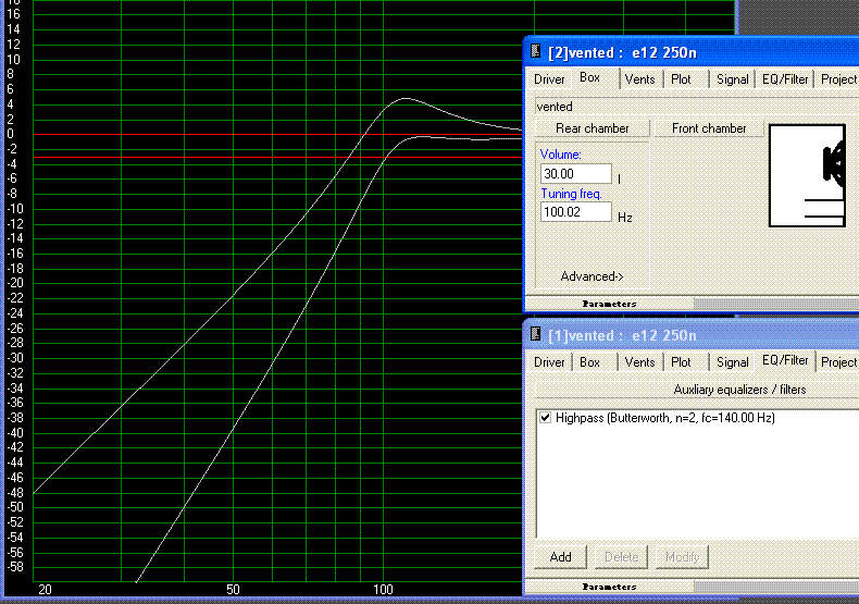

The only program I use is winisd.
Just put in the ratio between the drivers fs and the f3 you want, this is given in the tables.
Note that alignments are not chiseled in stone and there is quite a bit of leeway, for instance with that p. audio driver the alignment is close to the f3/fs one at 2.118, needing a Qt = .294.
If you use a 30 litre box tuned to 100Hz. with a filter at 100Hz. with a q=.5
For an input of 250W. the cone excursion is around 1.7mm. max.

Hi Robert,
I'm wondering if we should hive this off into another thread? I think I'm going to give it a go. I played around in WinISD a bit last night and It's still not clear to me what I have to input into WinISD apart from the box volume, tuning frequency and EQ/filter. My inability to make sense of your tables maybe...
I have a 50L box with a adjustable 80mm vent. I could reduce the volume of the box by adding some "bracing", or can I align to the larger volume?
Adjusting the EQ/filter in WinISD doesn't seem to change the modelled response?

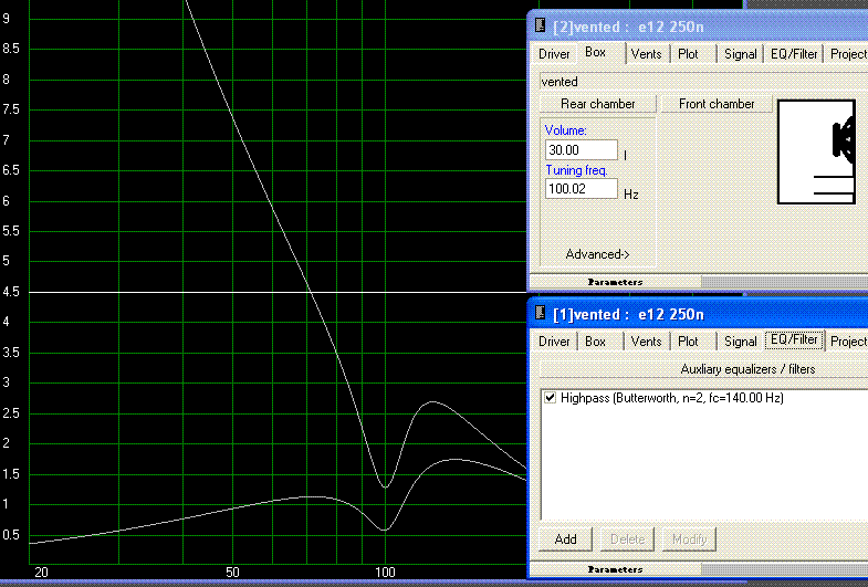

These are winsid simulations of a 30 litre box tuned to 100Hz...
For an input of 250 Watts the cone excursion is as shown, and the spl over this range is 120db.
The input filter has a q=.5, this is a second order L-R, it can also be done with two capacitors somewhere in the signal chain.
