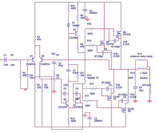

Maplin power amplifier circuit
Hi Craig405
Your circuit looks like a Hitachi appl. note circuit that was the first power amplifier i built. I used the newer flat-pak Hitachi made 2sk1058/2sj62 i used 1pair at first that gave me about 80watts. I wanted more so i paralleled another pair for 100watt/8ohm. I don't know if i could parallel more pair of mosfets and increase the power supply for more power....iam no amplifier Guru..just a guitar player..thanks to MR. Hendrix and Albert King .......anyway i added aclip circuit so i could see if i am getting to close to running out of headroom...(one of the good things about all tube amplifier.....soft-clipping)....also this is another reason for wanting a250watt amplifier...more headroom...and no power tubes to replace. A simple circuit few componts...op amp front..mosfets output fewer parts less headach.......i am not anti- tube amplifier......i use ahomemadetube pre amp in front of the power amplifier for overdrive and tone.....also i have a homemadeall tube Bassman based on the 1959 fender /Western Electric circuit.....i just don't like replacing power tubes. ........Fact the great Albert King used solid state amplifer and imo he had GREAT...tone
PEACE
