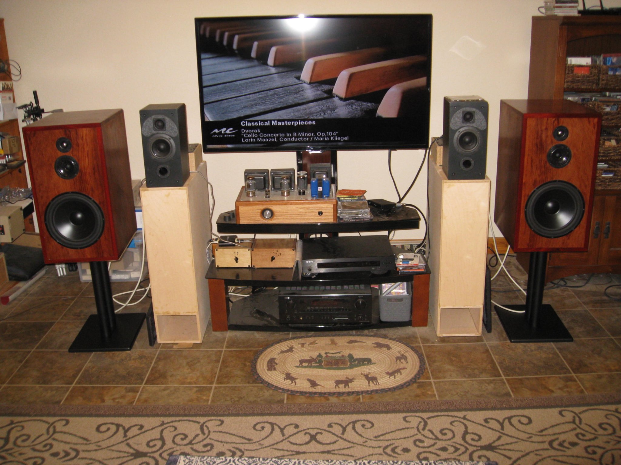

It's a nice little midrange. I have used it a couple of times, most recently in the 3-ways shown.
An oldie, but goodie.
Uncoated they were used as high power tweeters in PA systems.
The coated ones are excellent mids, small excursion so crossed fairly high, 500hs for low power, 800-1k for higher spl.
10F & 11F were made for many years.
