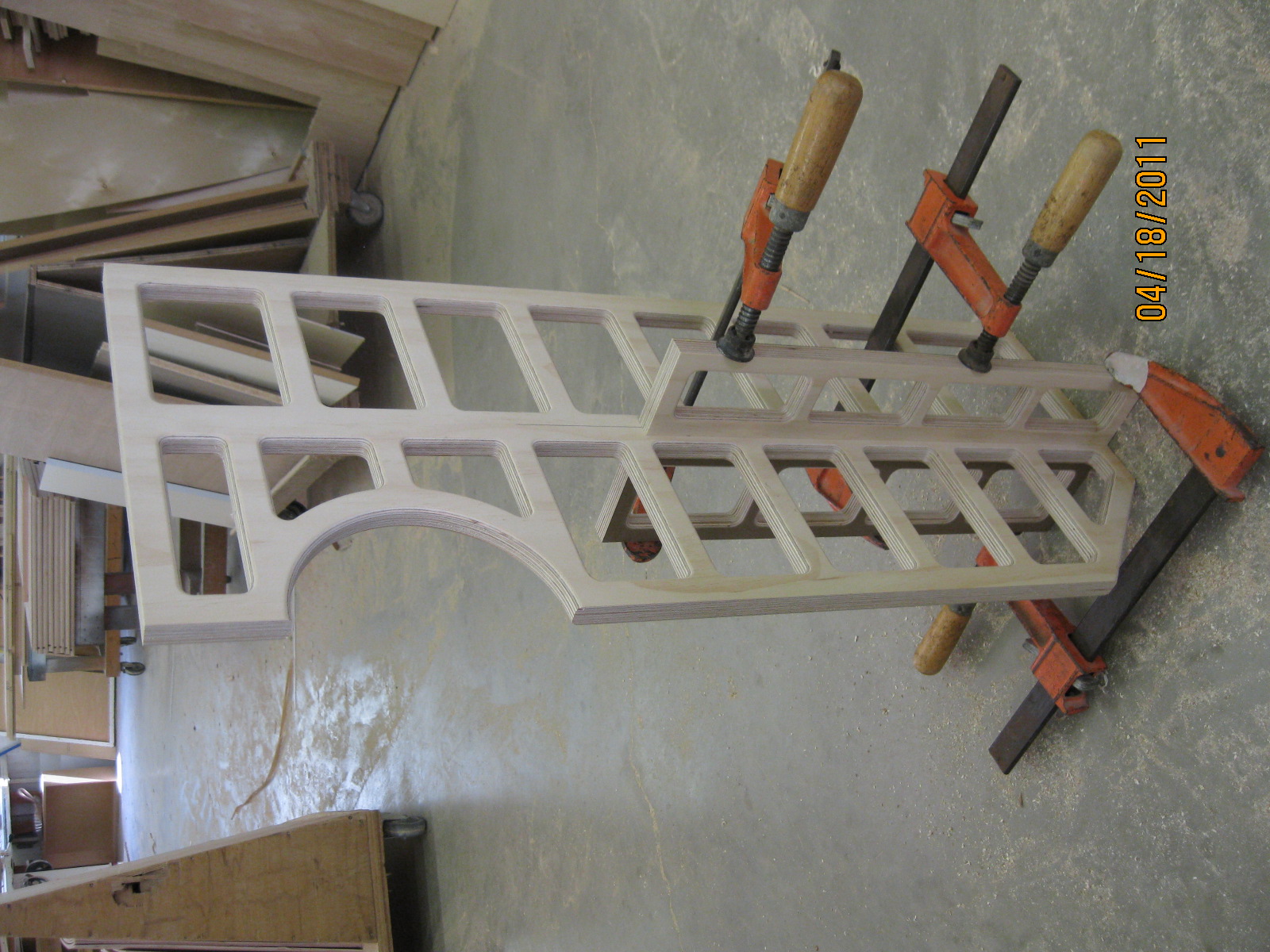

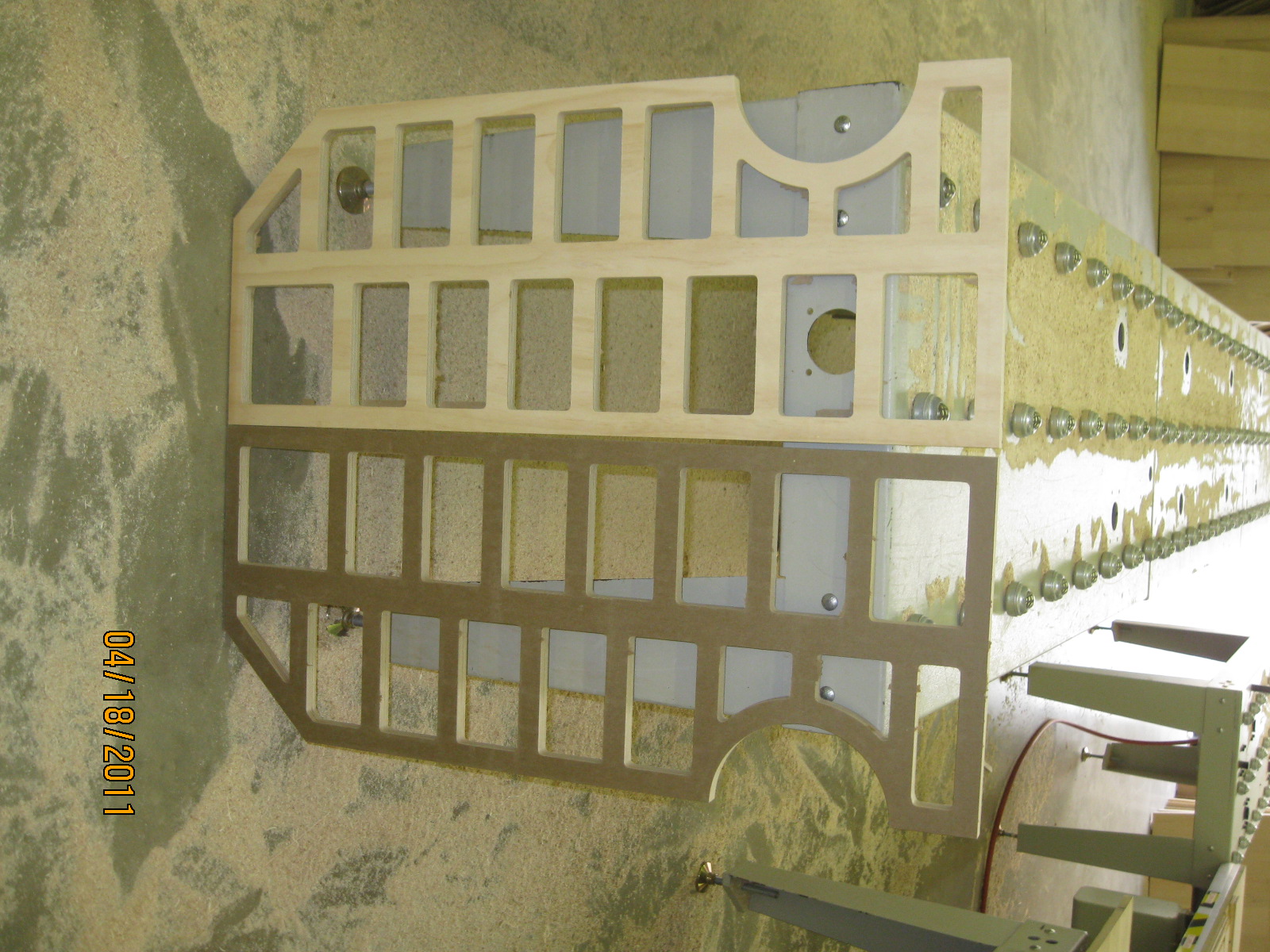

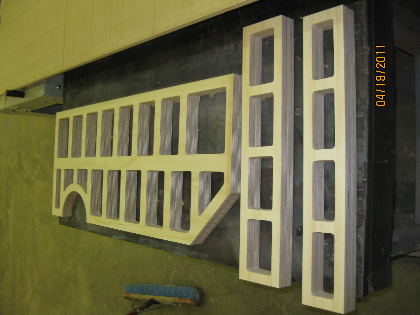

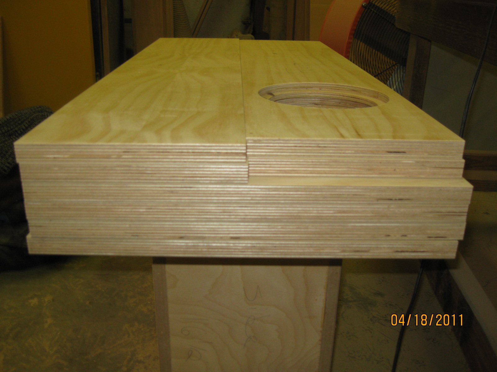

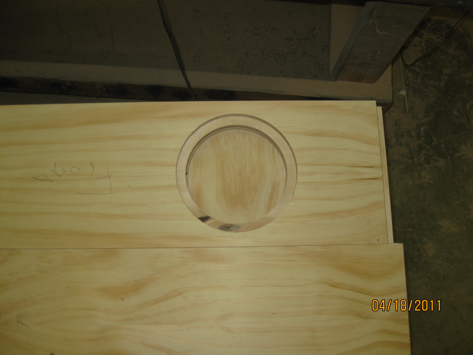

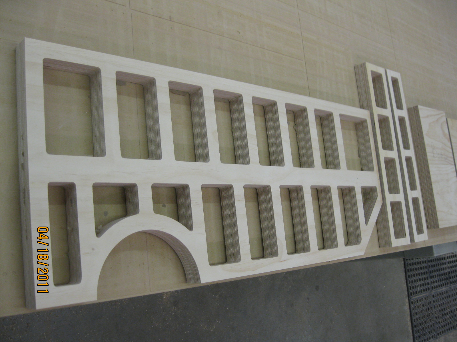

Looks like the problem has been resolved. Here are the first pictures of the raw material after being cut out. I'll upload a couple more when I get some more time.
Nice work Steve - particularly on the grain alignment on fronts & back - how much juggling did it take to get yield above 60%
With our commercial CADCAM software ( CutPlanner), it's more of a fight to override the yield optimization for any grained material than to just hand bomb the layout for grain /pattern matching. Of course if post veneering, you've just transferred that issue to another material .
The ribbon grained mahogany with natural lacquer or conversion varnish would make for a stunning look on these - that's likely what I'll be doing with an upcoming FH32 build in the next few weeks. With any luck, some pictures of the build this time.
I actually didn't bother with alignment of the grain. Though it did take a few minutes to place by hand all of the parts on the sheet correctly. Here are a few more pics. I'll upload the completed photos in a couple of hours.
