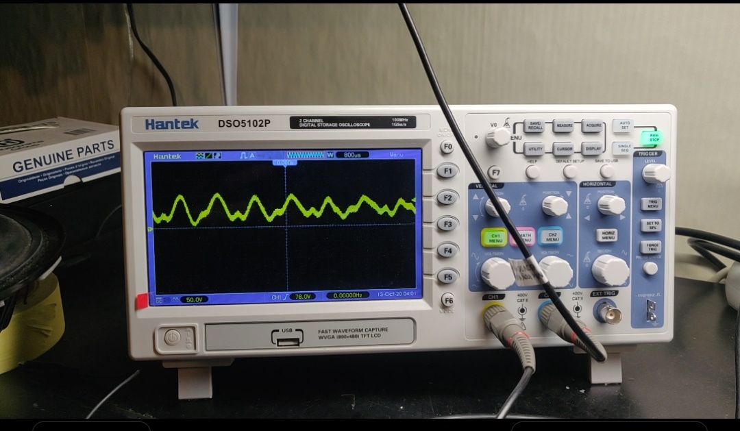

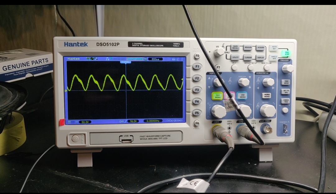

Second problem is when unplugging remote theres a weird noise/sound in the output and speaker is slightly sucked in. On the scope you could see something close to sinewave at the output right after the remote is removed and its present on both "channels".

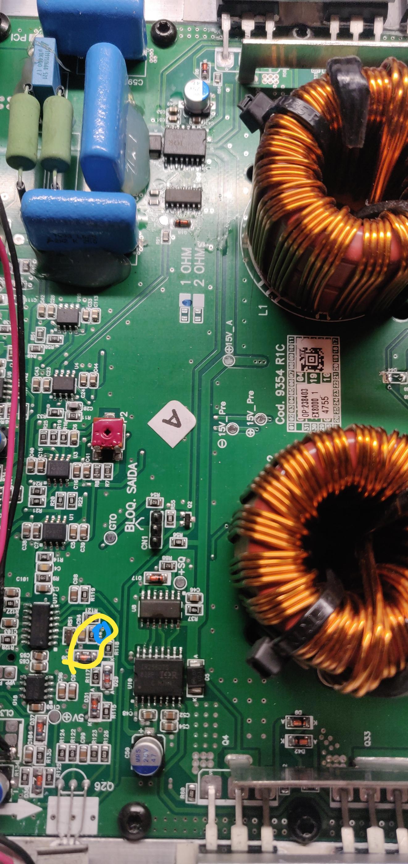

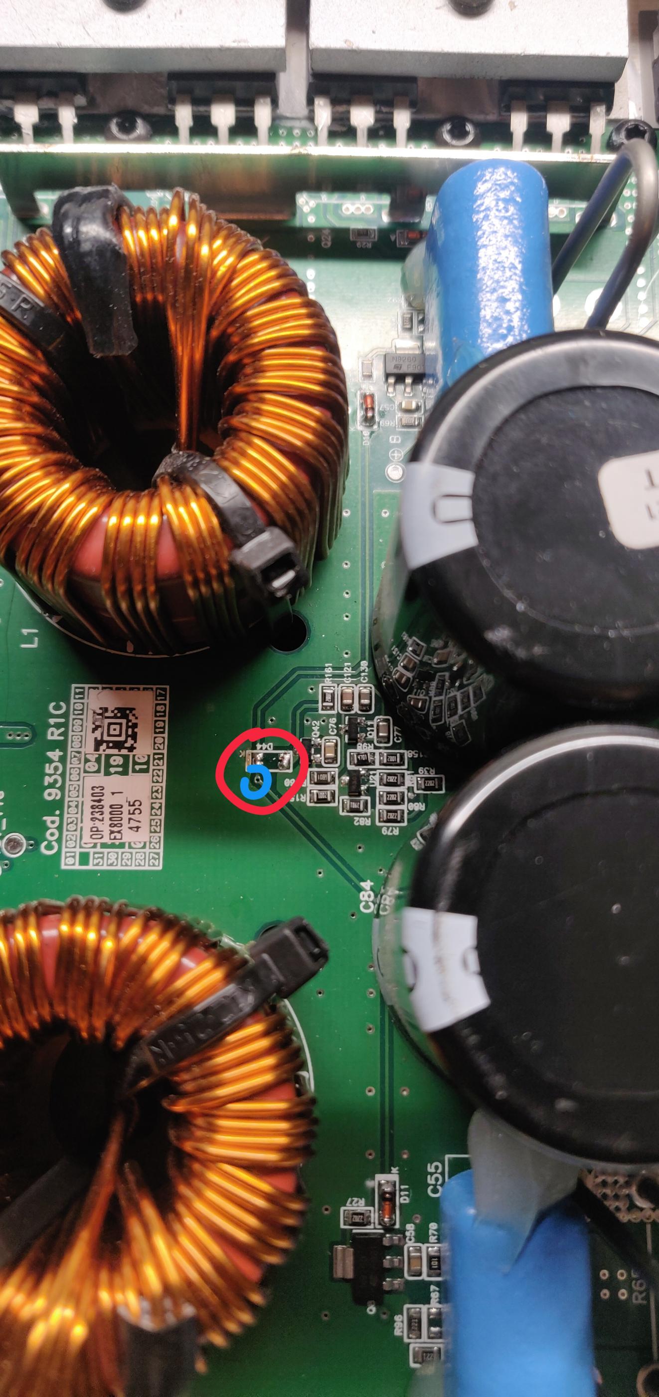

I did some quick testing in the morning. Found out that when D44(circled red) is removed then amp turns on even with 0V in the rails. When D44 is soldered in and removing 2 (D10&11) diodes on the same trace(next to both N9260 pnp's) amp still protects.
So i pretty sure i can leave D10&D11 out of this.
The via that goes through the board at D44 connects to via circled in blue at the PIC ic. Trace is grounded with 4.7k resistor which is parallel with ceramic cap and a diode. Other end of the trace goes to PIC ic pin nr 4. I will look into this in the evening.

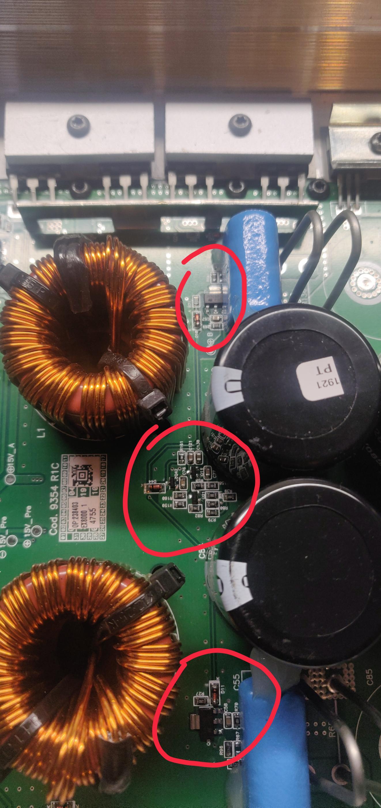

Hmm strange. I desoldered all the components next to the rail caps one by one to measure them outside the circuit. I guess they and two N9260 at the top and bottom of the picture are responsible for the overload circuit? Anyway i checked them all and found nothing wrong nor out of tolerance.
I guess it had to be cold solder or maybe water+dust residue or something because now the amp fires up every time no matter the voltage in the rails.
If nothing changes i think i can count that problem solved.

I tried to capture it with phone. When amp is turned on there is 0v dc offset. Both terminals sit at the same voltage(~57v atm) but right after turning off it turns into --> see the pictures.
Right after removing remote theres no more than 0.1v dc offset between two terminals. Both sides generate somewhat the same signal.
