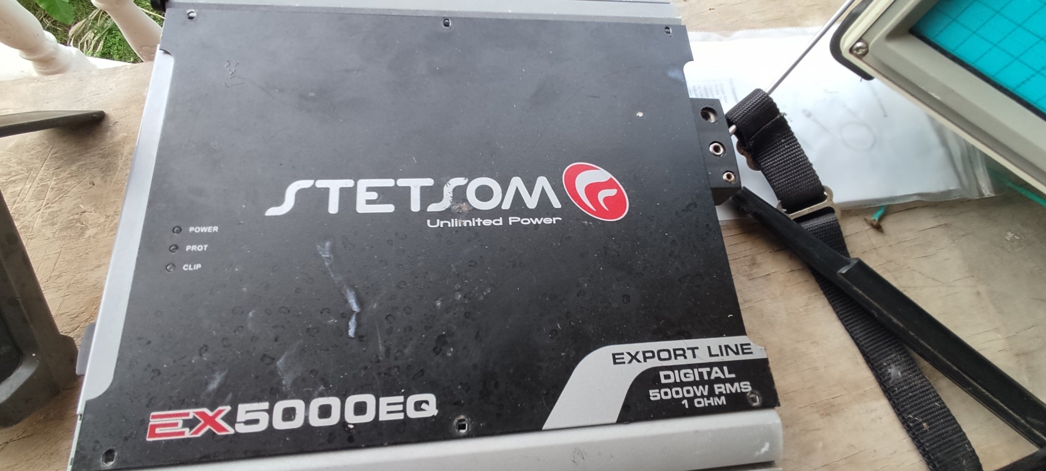

Hi there,
Can anyone assist me with a Stetsom Ex5000Eq amplifier that give out DC on the speaker terminals? The positive terminal has over 40 VDC and the negative has 3.8 VDC. I checked the voltage at the power input stage and there is a voltage drop of over 4 voltes. All of the Power FETs and output FETs give an ok reading during testing.

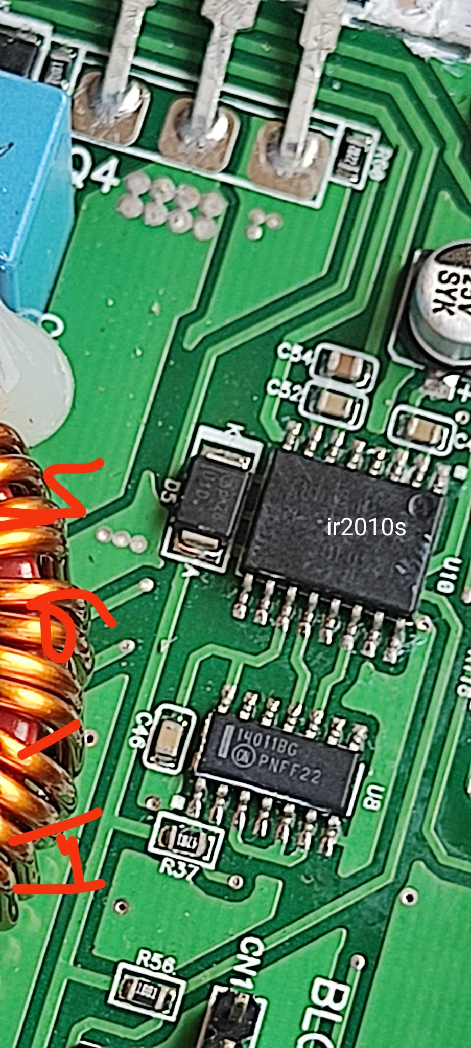

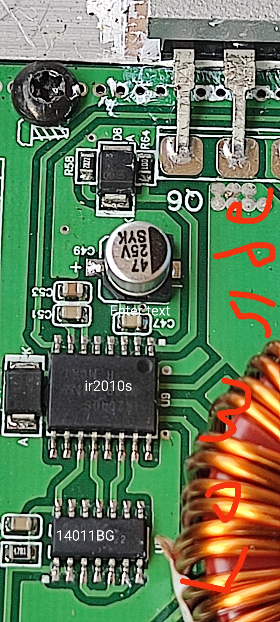

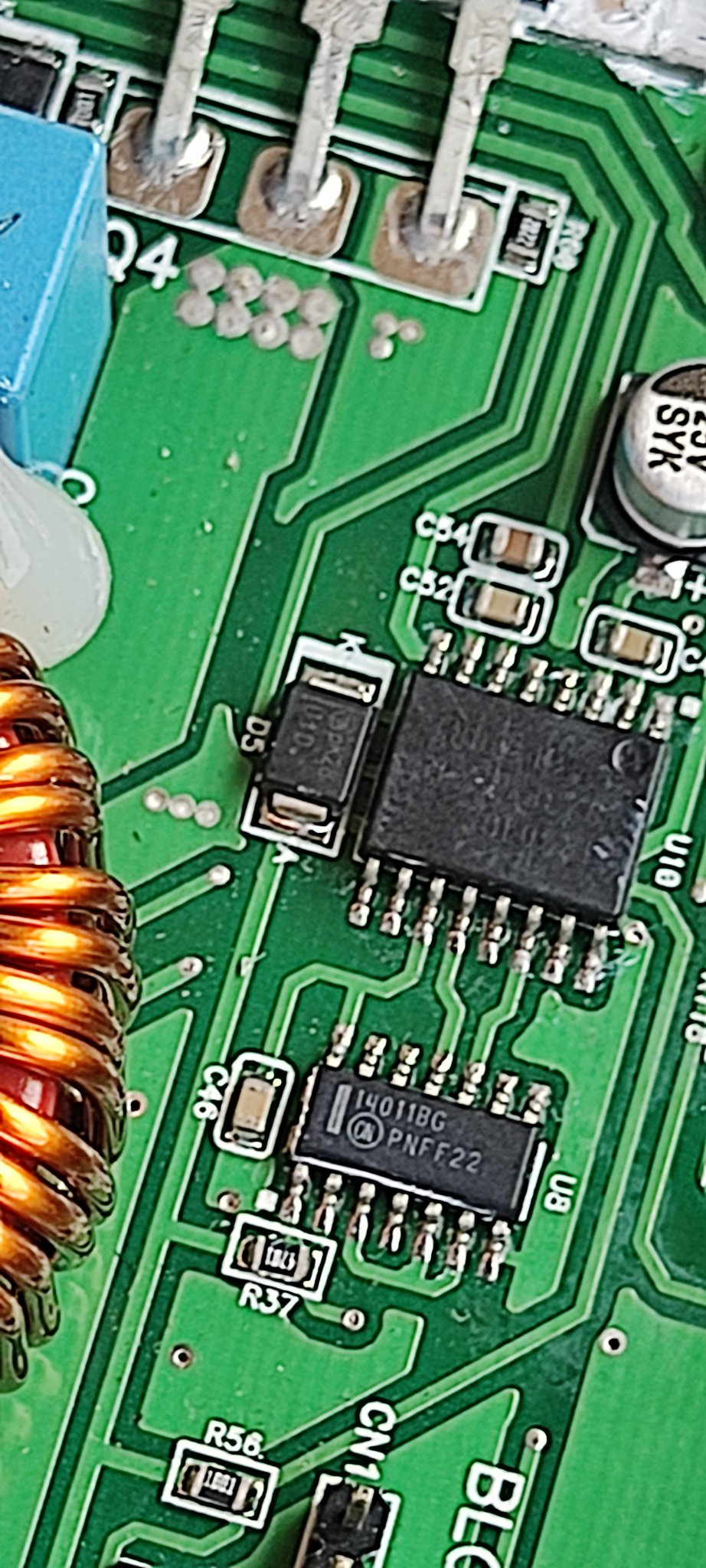

the output driver is IR2010s U9 and U10 but there is an IC 14011BG U7 and U8 in the same circuit and connected to the IR2010s on pin 3 I think. I will give better info and take photos of same and post them in the morning.
Yes, I know about the Driver ICs BUT the specific word "Floating high-side" I never heard before.
The low-side driver section is referenced to the negative rail (ground, here). The high-side driver section floats with the source of the high-side FET and has a floating supply.

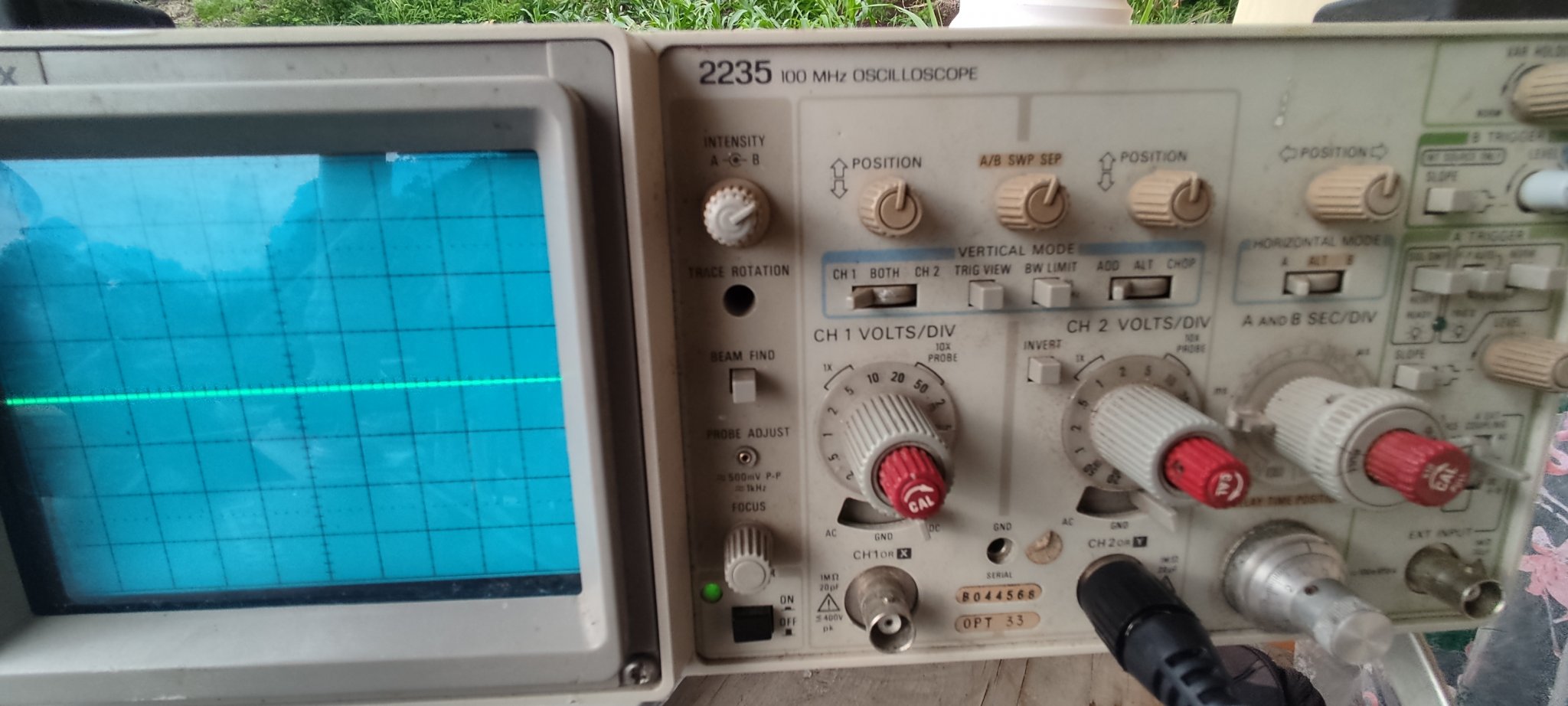

Do you know how to use your scope in differential mode?

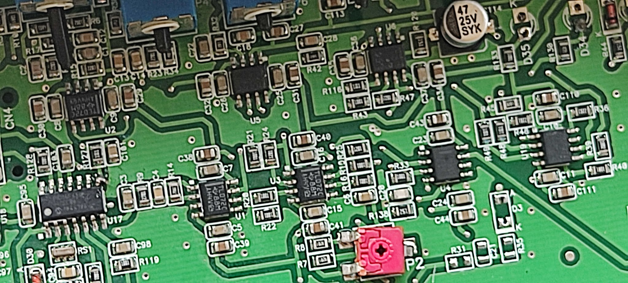

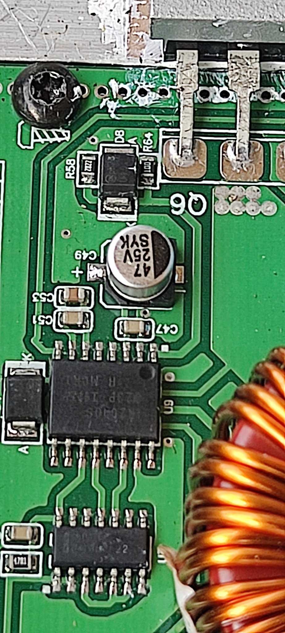

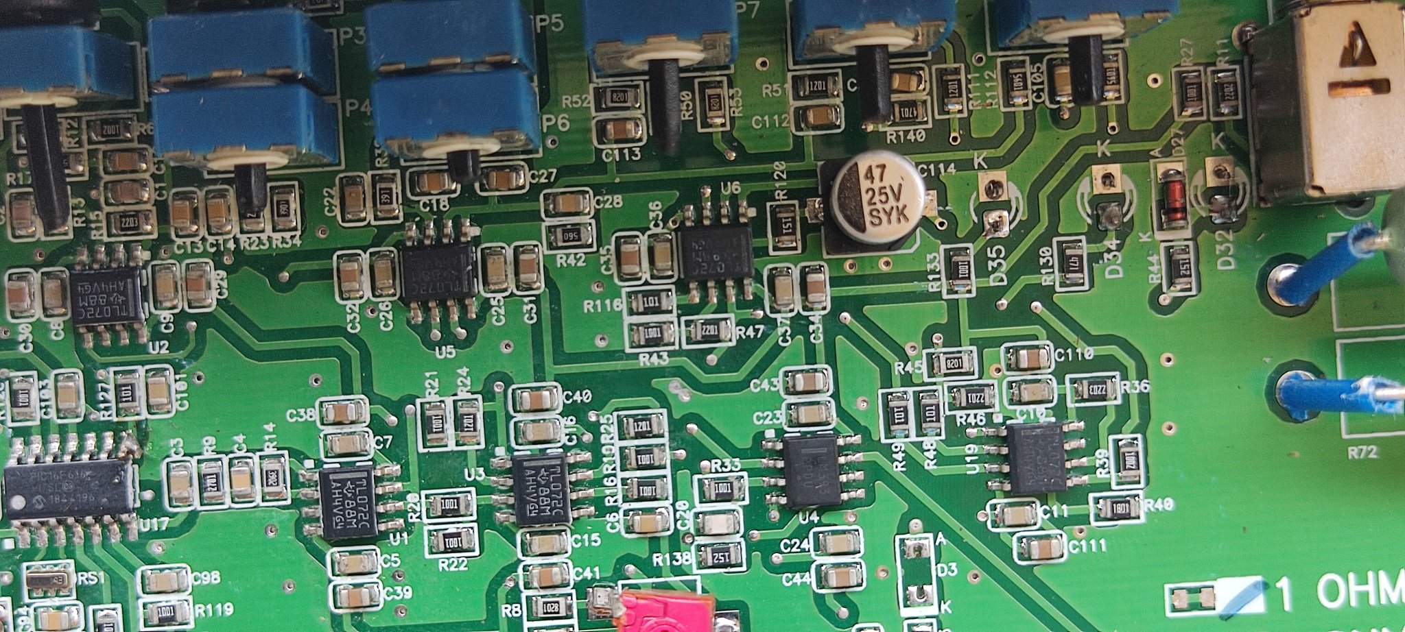

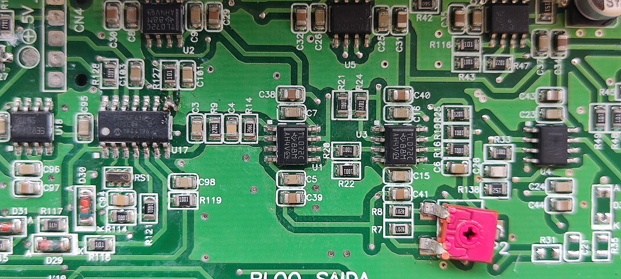

Good day Mr. Perry.

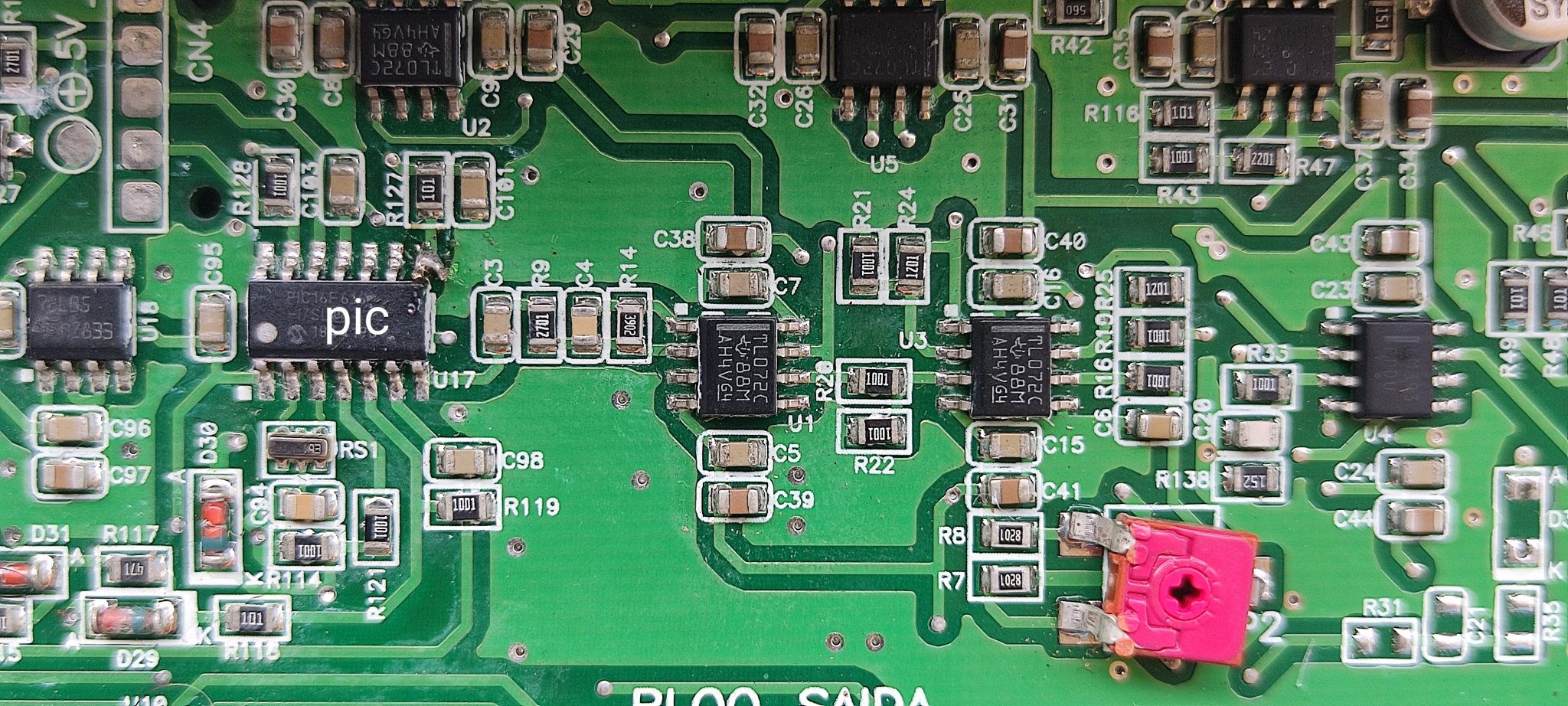

These are the photos as promised.

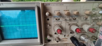

(Deferential mood)I not sure if you are referring to switching channel 2 to add and pressing the invert switch down to avoid contact with ground when testing using both probe

For what you marked as low-side, do all of the source legs of the output FETs read 0 ohms to ground?
For those not familiar with differential mode:
A differential input uses two inputs to produce a single waveform. The simplest way to get a differential input is to use a differential probe. A differential probe has two signal leads and a mixer amplifier built into it. It feeds the scope a normal signal (a composite of the two signals input into the differential probe). The problem with differential probes is that they're expensive.
The alternative is to use two scope probes and and both inputs of your oscilloscope. This is how you have to set up your scope:
Two probes
Both scope inputs used
Input set to add
Both channels set to DC coupling
Both channels set to 'cal'.
Both vertical amps set to the same voltage
Ch2 input set to invert
Bandwidth limited (works best for most measurements in car amps)
Trace aligned to the reference line on the scope's display
Ground leads for both probes connected together (not always necessary)
After setting up the scope, you need to confirm that it's working as it should. With the vertical amp set to 5v/div, touching the probe that's connected to Ch1 to the positive terminal of your 12v power supply should make the trace deflect about 2.5 divisions up from the reference (like it always does, seen below). Doing the same with the probe connected to Ch2 should make the trace deflect down about 2.5 divisions. Touching both probes to the positive terminal of the 12v power supply should cause no deflection. If it does, something isn't right.
I know that this may not be as simple as the isolated scope but if you take the time to learn it one time (even if it takes an hour or more of your time), you have that knowledge and this tool to use for the rest of the time you need to use a scope. Using the analog scope will give you much larger and cleaner waveforms.

I setup the scope in differential mood but when I power up the amp this morning it had a huge voltage drop of half the output voltage of the power supply and it power cycling where by it appears that it is shutting down and restarting within a spit second. All voltage and wave form will go down to 0 the shoots back up within a second.Do you see any rail-rail oscillation on either group of output transistors?
