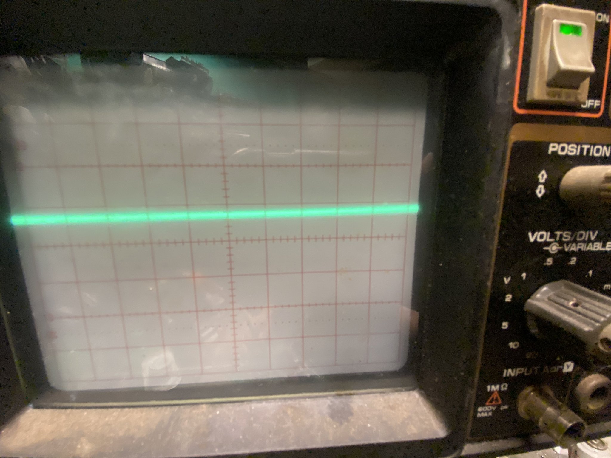

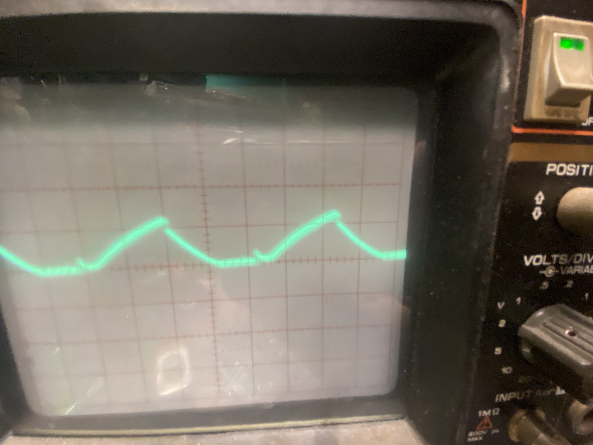

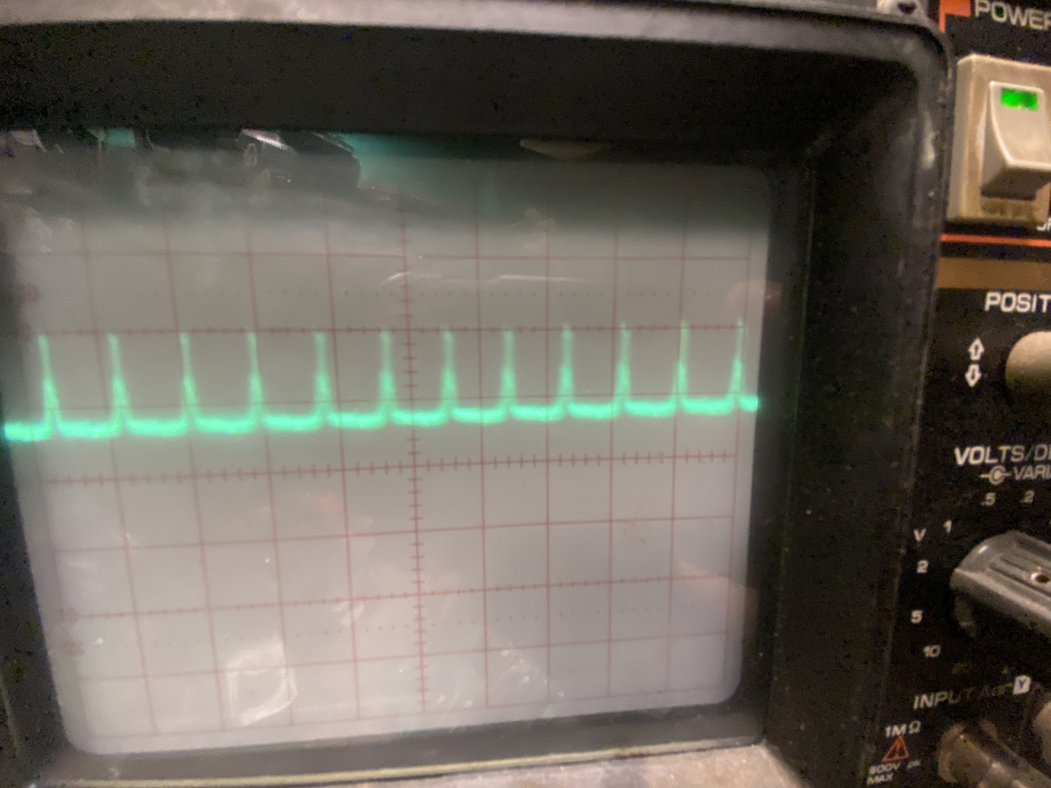

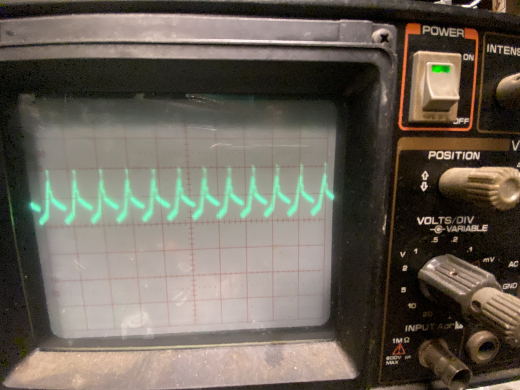

U1
Pin 1:0.44
Pin 7:.48
U3
Pin 1:0.31
Pin 7:0.49
Pic 1: pin 1 of U1
Pic 2: pin 7 of U1
Pic 3: pin 1 of U3
Pic 4: pin 7 of U3
Scope set to 5 us .5 volts div

I think U1 may be defective. I'm not absolutely certain about this but it's a common IC so you should have it in stock.

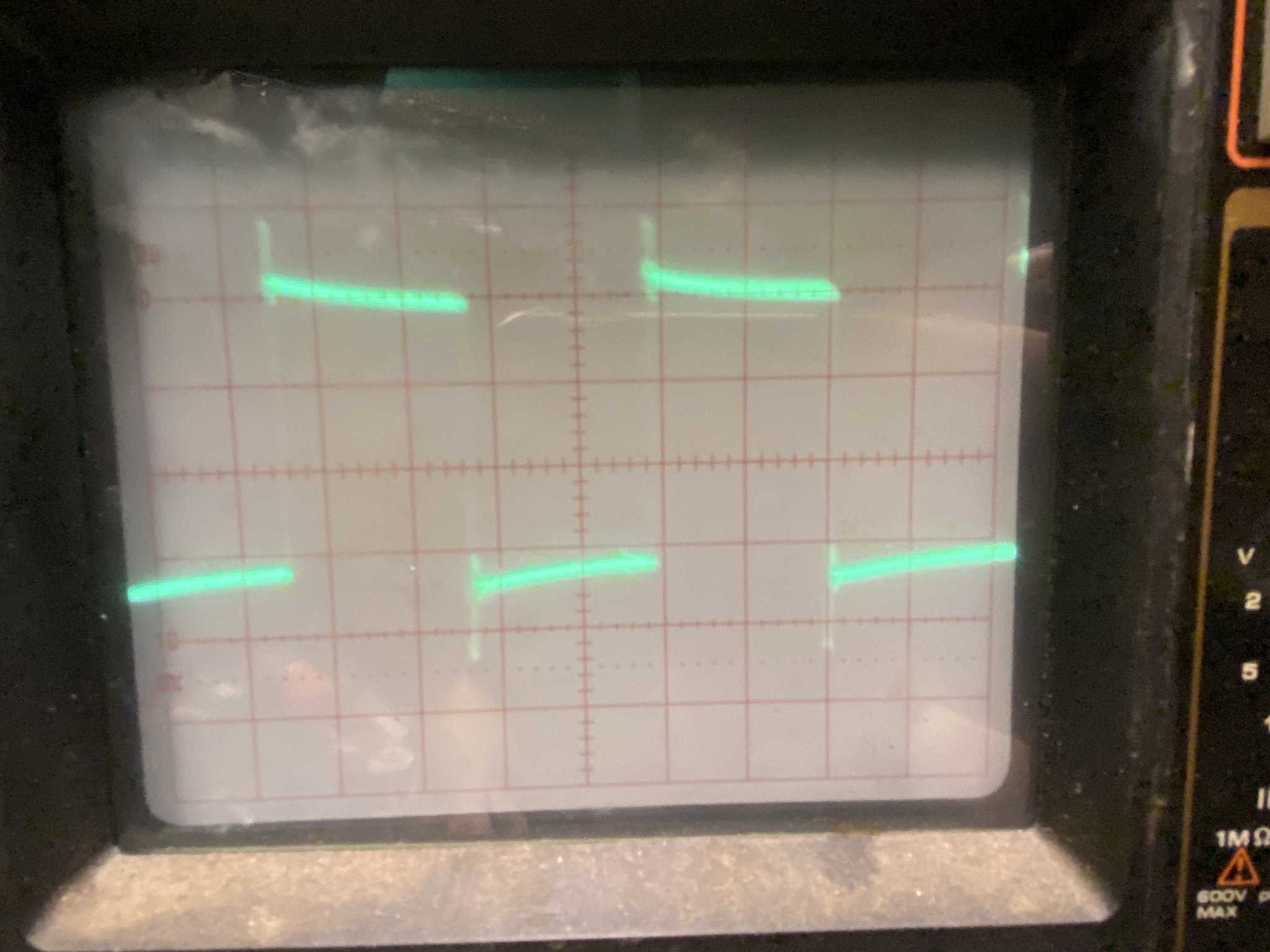

Do you have any other Stetsom (or other Brazilian) amps that use this configuration at this point in the circuit?
What does the output of U1 look like? Still the same?
Output still looks the same
And I do t have any other Brazilian amps here that use the configuration right now

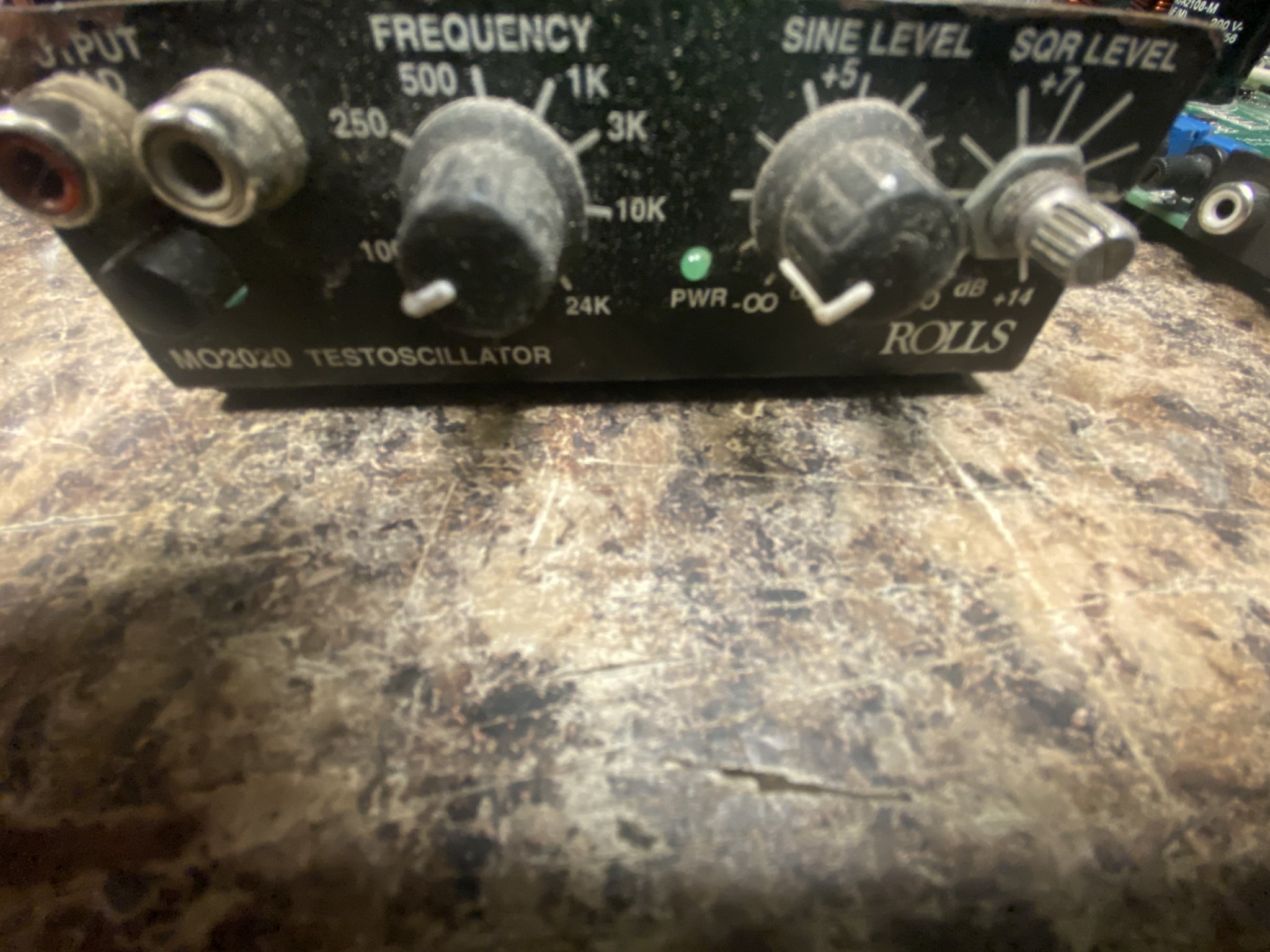

Remove U1.
Drive a 100k 1v sine wave into the point where R19 and R20 connect.
What do you see on pin 1 of U3?
