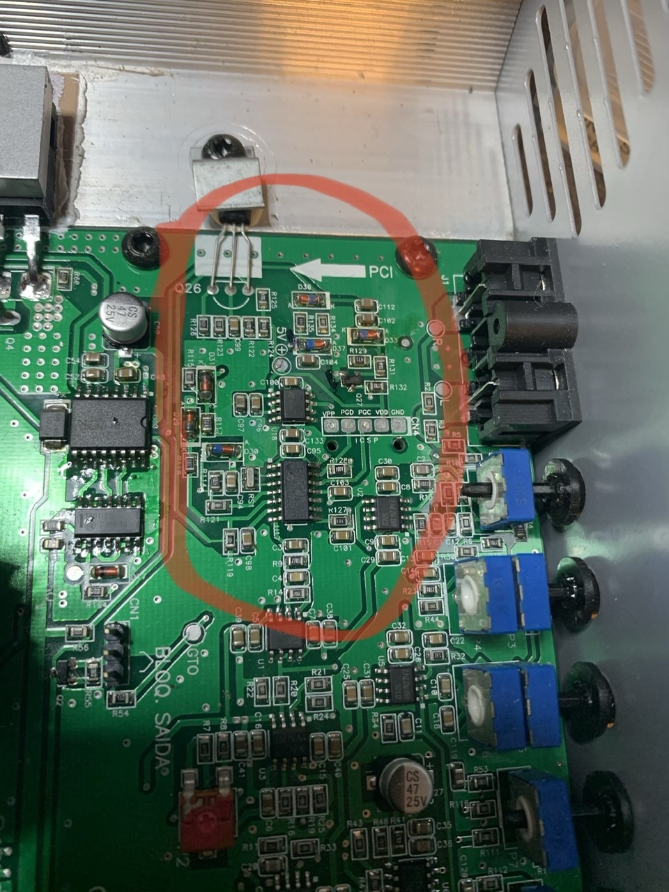

I am including a photo of the area in question.

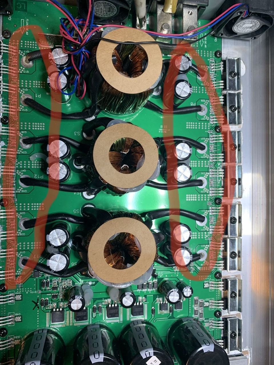

I’m feeding the amp 14.5 volts and no current limiter. The amp is drawing very minimal current. The only thing running are the fans. I get B+ voltage on the the areas circled in the power supply. They feed B+ to the center legs of the power supply mosfets. I also get battery voltage through the small circuit in the picture up to the black x marked on the board but nothing to the large and small voltage regulators which figures since the power supply is not oscillating.
The other picture is of the PIC16 and the undervolt circuit.
I get B+ voltage at the cathode of D36 and D33.
I get 6v on the anode side of D36, 5.82v on the anode side of D33, 6v on the cathode side of D37 and 0v on the anode side of D37.
D31 I get 13.5v on cathode side and 9.4 on anode side of D31. D29 I get 3.8v on cathode side and 0.0v on anode side of D29. D30 I get 4.12v on cathode side and 0.0v on the anode side of D30.
On the linear regulator in front of the PIC16 I get 13.5v in and 4.95v out.
I got lucky and got a Stetsom 8k into the shop that I just repaired and it’s working fine. So I took some voltage readings in the undervolt/overvolt circuit.
Feeding the amp 14.5 volts
D36 K 13.5v A 0.65v
D33 K 13.5v A 5.23v
D37 K .065v A .064v
D31 K 14.09v A 9.95v
D29 K 3.87v A .064v
D30 K .064v A .064v
Linear regulator 14.1 volts in and 5.05 volts out
Q27 B .067v E .771v C .064v
The emitter is connected to ground.
Test points next to the linear regulator
VPP .078v
PGD .075v
PGC 4.9v
VDD 5.0v
GND 0.0v
So I’ve got some good numbers to go on now. Maybe I can figure this thing out.
