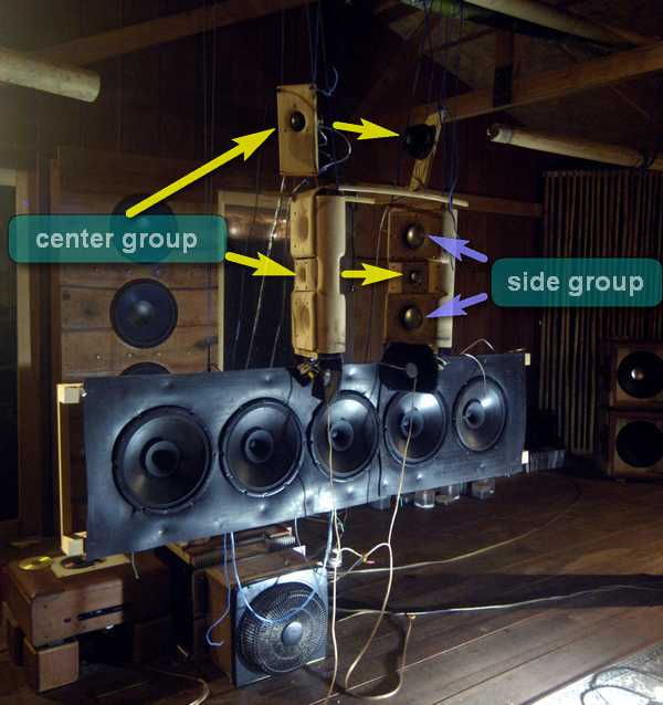

Directional properties at the low freq depends on the speaker. For example dipoles are directional down to DC. SSS is also directional at bass due to the vector steering of the matrix. The directionality depends on the recorded stereo material: If bass is mono in the recording, SSS reproduces it as absolute mono. If bass is coming from one stereo channel, SSS will aim the energy to that side.
For a practical construction integrating SSS bass, of course the bass elements should be placed in a separate enclosure. They should operate with their own matrix. Cross over connects the two matrixes together at the amplifier terminals. One stereo amplifier is enough for a passive implementation of a two way SSS.

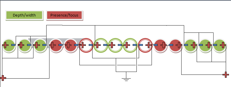

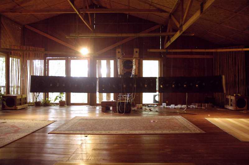

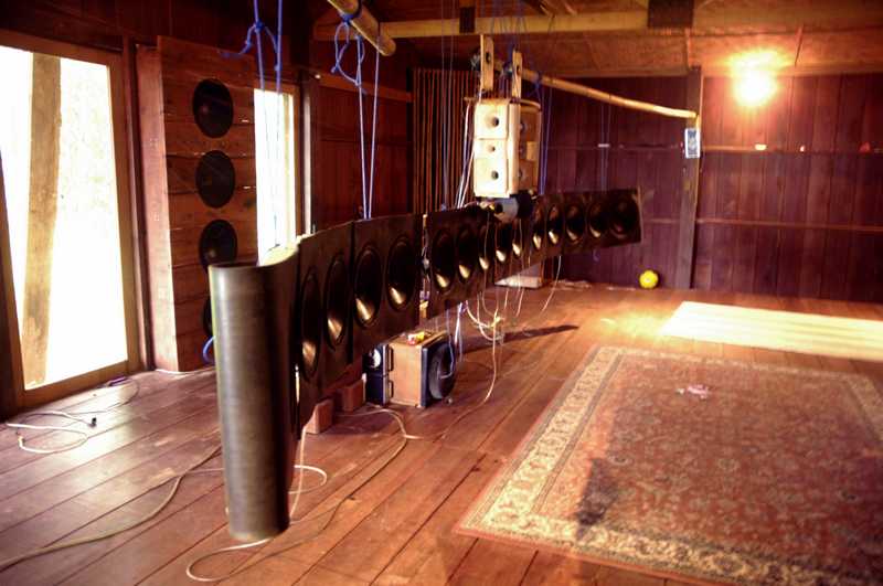

Next step for me and now in topic because it's (almost) from a single loudspeaker following Elias's definition.
Interestingly a "traditional" mapping with L-C-R banks does'nt give as good results than the vertical arrays. But my plan was to try some other combinations, this becoming possible when using many drivers (but I will add more).
Here just a wiring sample between maybe one hundred possible variants, without even thinking of delays or curvatures. Arbitrarily the green an red groups have some optimistic names, but it's close to the reality. This is done by the relative impedances and efficiencies. Elementary, but it works already pretty well for a new born.

15 12inchers array in a 'single' loudspeaker, and you called that 'elementary' ?! 😱
So, now I may see this monster as 2 sets of overlapping SSS. By intuition, it might be preferable to arrange the one with larger x on both ends and midway (between center and side); and a smaller x to the other set for the center and slightly inward side units.
Does that make sense?
OTOH, this might conflict with the doable wiring scheme under the considerations of x factor and SPL distributions. Delimmas everywhere, as always.
Already mega impressive anyway. And it's a large playground (both in space and this platform of array) for future development. I bet you'll have a lot of fun along this wonderful journey 😀
The principle itself is elementary, only one amp for the mids, no line circuit. It's better to keep the things simple for the early development as many usual old behaviors have changed. I dunno exactly yet what makes sense or not.

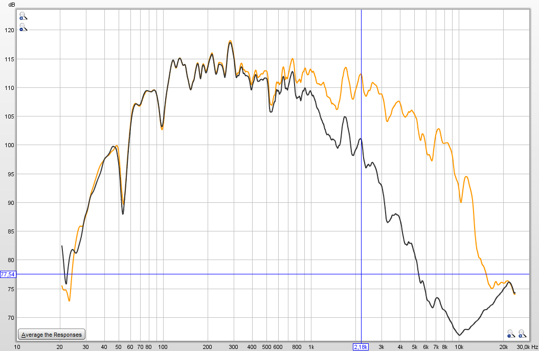

For instance there is a clear limit in the high pass of the mids : over it, some localisations clues are ambiguously on both sides when is only one side on the record. Under the limit it's suddenly OK and also becomes wider.
I join a plot where the optimal maximal curve shows a roll off after 1000 Hz. Has this something to do with the ITD/ILD transition ? Or more simply a directivity related issue ? Or something related to the mapping ? Or a reflection problem, as a too uniform floor bounce ?
