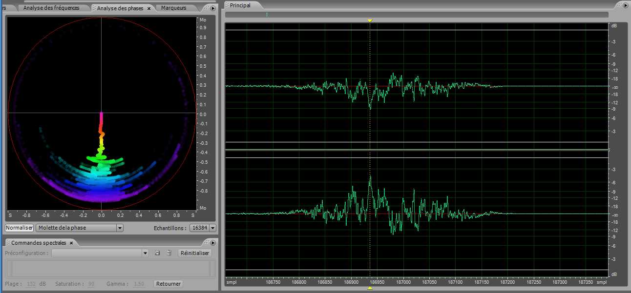

The signal is "processed" (big word for this) in Adobe Audition : two identical tracks, then stereo field rotate.
This is phase stereo, and can be seen in a zooming of the sequence : the intensity is roughly the same but the tracks are in phase opp, confirmed by "molette de la phase" on the left.
I'm not an expert, but I've always seen this phase shift in the authentified binaural records.
