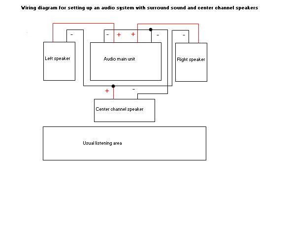

Vintage amps often had instructions on how to wire in a center channel speaker. Below is an example. But you should know if there is a hole in the center of your STEREO image there is something else wrong.
