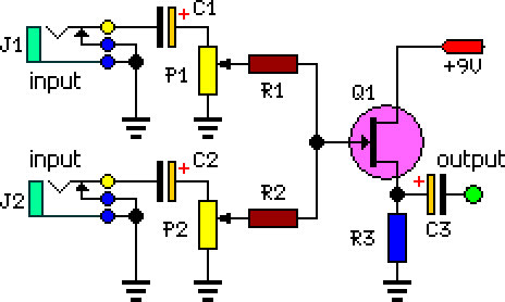

Here's my problem: I'm trying to find a 0.1uF 25v capacitor, but all I can find is 50v ones. Is it ok for me to use a 0.1uF 50v capacitor instead of the 25v one?
I read somewhere on the net that it is best to use the capacitor that is closest to the amount of power coming in (+9v).

Your link didn't work for me, but I don't see any reason you can't use a 50V cap instead of 25V. Don't worry about the 9V in.
Without knowing the purpose of this circuit it's hard to comment much, but I'd have to be really armtwisted to use any input capacitors at all (or even any active circuitry at all, as nigelwright7557 says). If they were necessary because of possible DC voltages appearing at the inputs, I'd want much higher voltage non-polarized caps and some kind of overvoltage clamps, maybe zeners. What kind of guitars is this to be used for?

I wasn't actually planning on using it for guitars..... I just needed a stereo to mono circuit to convert a stereo line to mono.
The reason I picked this specific schematic is because it is possible to add as much "channels" as you want.

No problem using the higher voltage caps.
You want to look up "summing amplifier". That's what this is and what is used in mixing consoles, for example.
0.1uF sounds a bit low depending on the value of the pots. The effect of the cap is to roll the bass off because it forms a high pass filter.

Same goes for C3, as the load impedance you hang on the end of this circuit also forms a filter.
I would use small 4.7 uF electroylitics all round I think (watch the polarity), and it would be good practice to add a resistor to ground across each input and also across the output to "charge" the caps at switch on.
