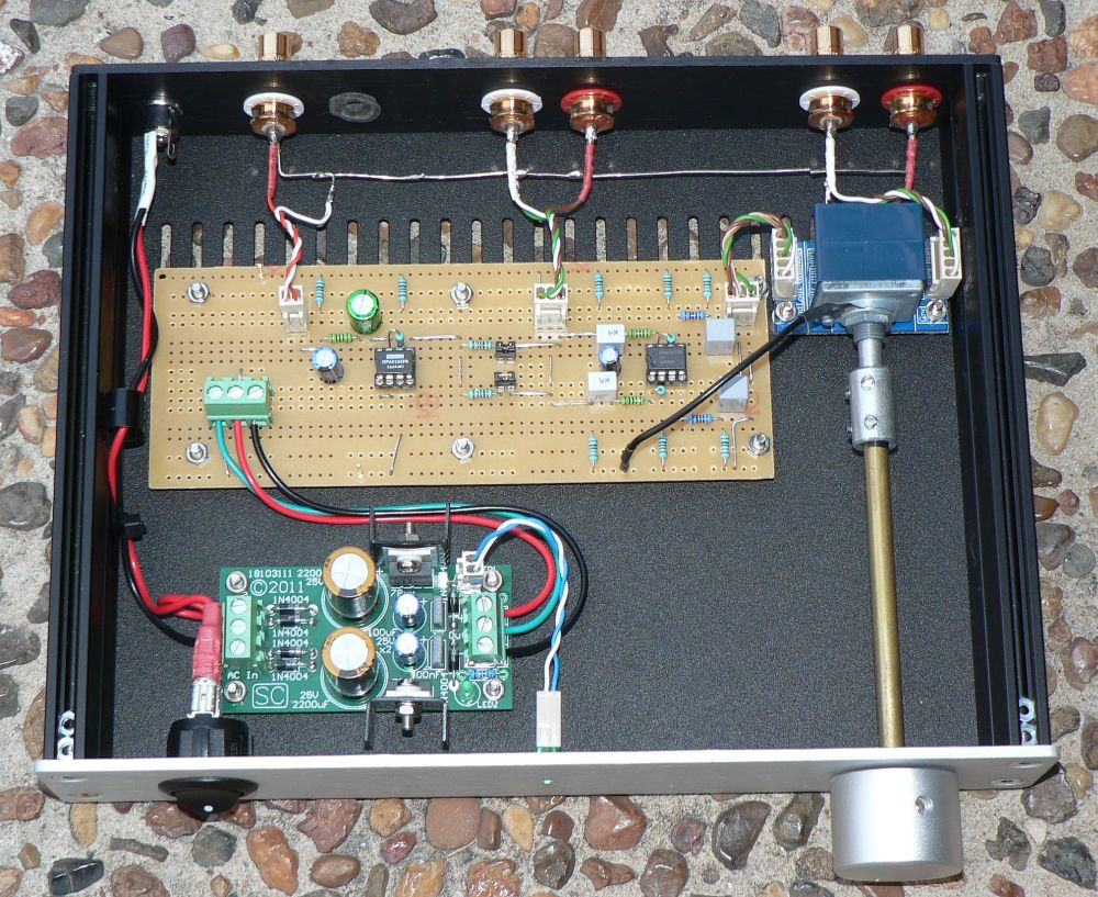

The attached file is the KiCad drawing of my 5.1 preamp for our TV. The top left corner U4 A & B, U5 A & B and U6 B
do what you're asking. I got the values for the filter wrong so it's 100Hz. To change it to 80 Hz change R20 and
R22 to 39.2K. Gain is unity.
I did one last year that was basically part ESP P88 as a stereo gain section and a mono mixer. See the following thread and I had to use a FET in the mixer stage due to DC offset. You can always add a pot to the mixer.
Active pre amp DC offset increases with 2 modules used

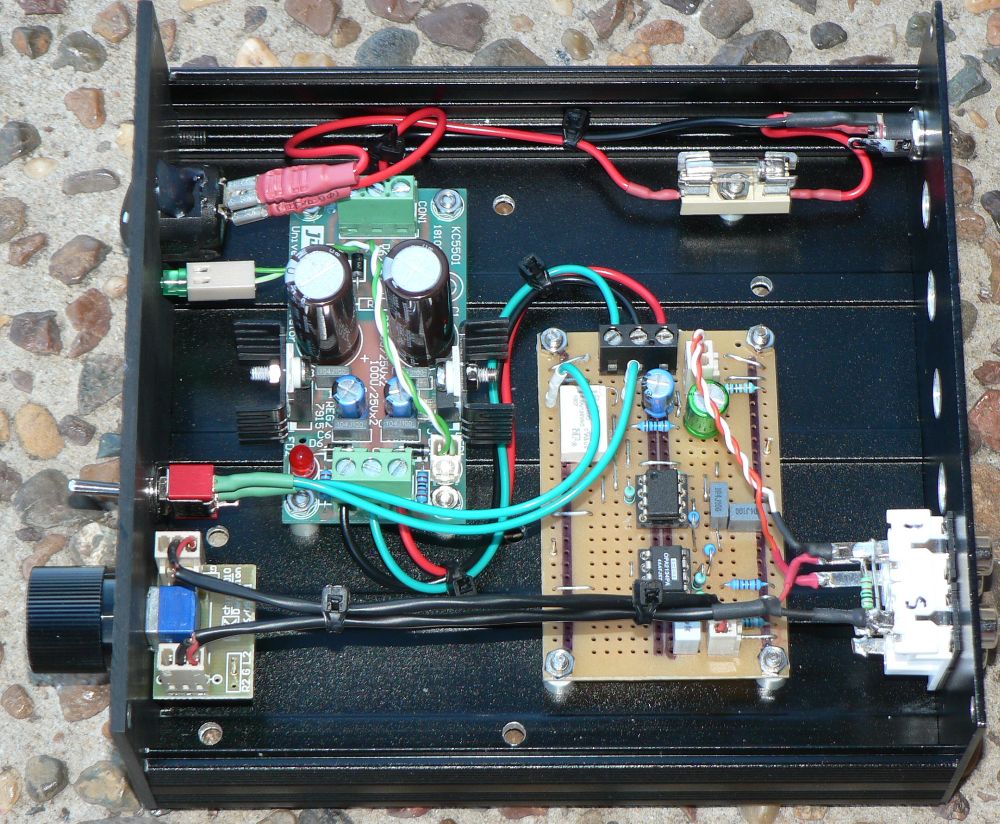

The mono stage can be replaced with the LP section of ESP P81 and I've built those as a separate unit. This gives a buffer (I added gain to U1A), a filter (I used 80Hz) and phase change via a relay. I did have some noise and added 100K to ground at the end of the circuit after the 10uF cap.
12dB / Octave Linkwitz Riley Crossover
If you have a look around at the ESP site you can mix and match stuff to suit.
