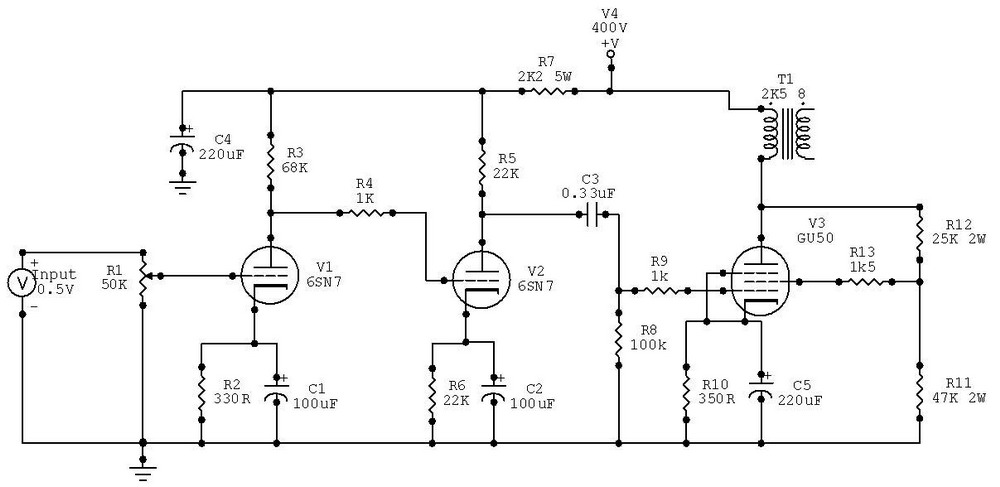

did any one try a gu50???i was reading about this tube and it seems to be able to replace the kt88 [different tube sockets needed ] and some other changes but not to masure , i gives a lot of power and its really cheap to get on ebay
it is suposed to give 10 watts se in triode
any body any idea what will be the pro and cons of this conversion ?
grtz ko
grtz ko
grtz ko
The GU50 cannot replace the KT88 because it is a rectifier tube. It may be able to replace the 5U4G but I am not even certain of that. Besides, even if it could, it is probably the ugliest tube I have ever seen!

hi jeff
i was thinking to use the end of this schematics and keep the 6n1p from thew original schematics kt88 ,whats your opinion ?
i got intresting after reading the article [see previous post ] from jac music
where they say that this tube beats a kt88 easy

I really can't comment, I just am not too familiar with this tube, even after I read a few of the links you gave.
Have you built this amo (KT88SE) as-is? If you really want my opinion, I would first builkd this amp as-is on this thread then try to modify it later.
I find this amp has plenty of power and drives my Proac 2.5 Response clones much louder than I would want to listen to. I certainly think I don't need any more power. You could always try to adapt this front end to the GU50 but in the end you will have basically built an entirely different amp I think. That is just my opinion but, you did ask for it😉
Sorry I can't help you more.
