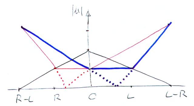

from a Japanese. This is the simplest matrix for common-ground signals, "matrix" because it connects several in- to several outputs black-box-style. If all loudspeakers are equal, its transfer function can become described as
Ls=(2/3)*(L-R/2)
Cs=(2/3)*((L+R)/2)
Rs=(2/3)*(R-L/2) .
This is also known as "0.5 matrix", multiplied by a factor of (2/3) for its passivity. Following are an interpolation (solid lines) and a derivation (dots) of the positive output |U| of Ls (red), Cs (black) and Rs (blue) as a function of panning from R-L to L-R:
attachment.php
Phase reverses in the aisles of the dotted lines.

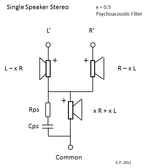

I cannot see it because i have no https. But i saw elsewhere, that you used a capacitor across the center driver. Let me elaborate on electrical filtering: If using a crossover of first order, highpass-filtering the center and lowpass-filtering each side, the beam points to the side, strengthening directivity of the back-tilted sides. This is quite contrary to a subwoofer/satellite setup, in which the sides have the trebles, and the center has the bass. Both setups are imperfect, but that is the way it is.
I don't think the center is high pass filtered - the cap and resistor in series and those in parallel with center channel shunts HF to ground as determined by RC constant. This reduces the HF's reaching the center - it's a shelving filter not a low pass or high pass. Here is circuit so you can see.

A choke there would force HF's to go through the center channel accentuating the effect of the center channel wouldn't it? I think the point of the psychoacoustic filter is to soften the HF's of the center so that the stereo localization is more dependent on the L and R channels. A choke and resistor in parallel and that in series before the center channel would be a HF shelving filter, but would also need a padding resistor to decrease the 3dB gain that the center channel has with respect to side channels as all current flows through the center channel otherwise. But that would then limit the max current that can flow through the side channels.

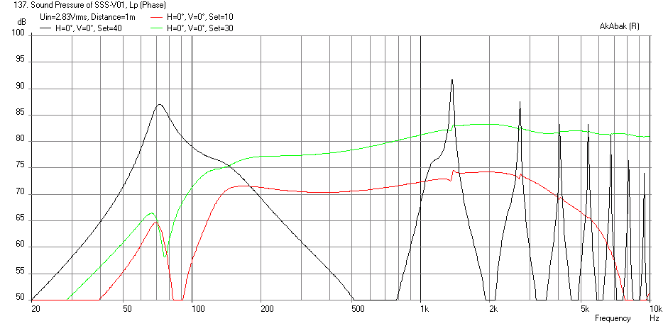

I simulated the response of the network and acoustic effect at 0 deg incidence with Akabak and it is good. You can see the falloff of the center channel.
More on the sims of the SSS here:
http://www.diyaudio.com/forums/full...xed-single-stereo-speakers-7.html#post3962898
The black is the BR output (in reality with stuffing the higher frequency peaks do not show up), the green is side, red is center channel:
424030d1402920189-master-nagaoka-tetsuo-explorations-matrixed-single-stereo-speakers-sss-front-right-vent-freq-1m.png
In the trebles yes. But it would also turn phase in direction, that stereo beams are further tilted to their sides in the transition frequency range of the filter. This highpass should be stopped at -4,5dB or so, so the center loudspeaker would still get some midrange and bass.
