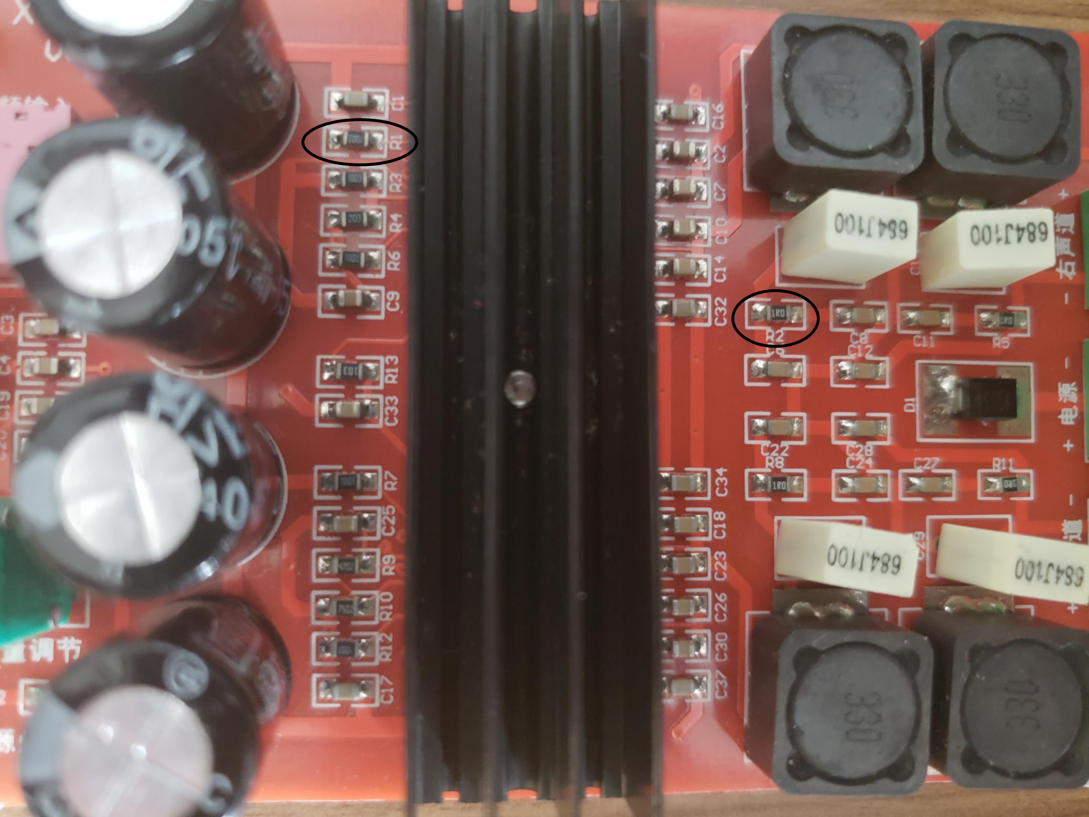

Hello Flo,
Thanks for the message good of you. Not the two resistors you mention please leave those. Look for these two together 473 (47K) and 753 (75K) you will find two pairs of them one for each amp. Remove the 753 and the hiss will go and the hum will be all but inaudible, and the pops at startup and switch off will go as well.

The master/slave configuration is various combinations of resistors, the chip recognises which is in place.

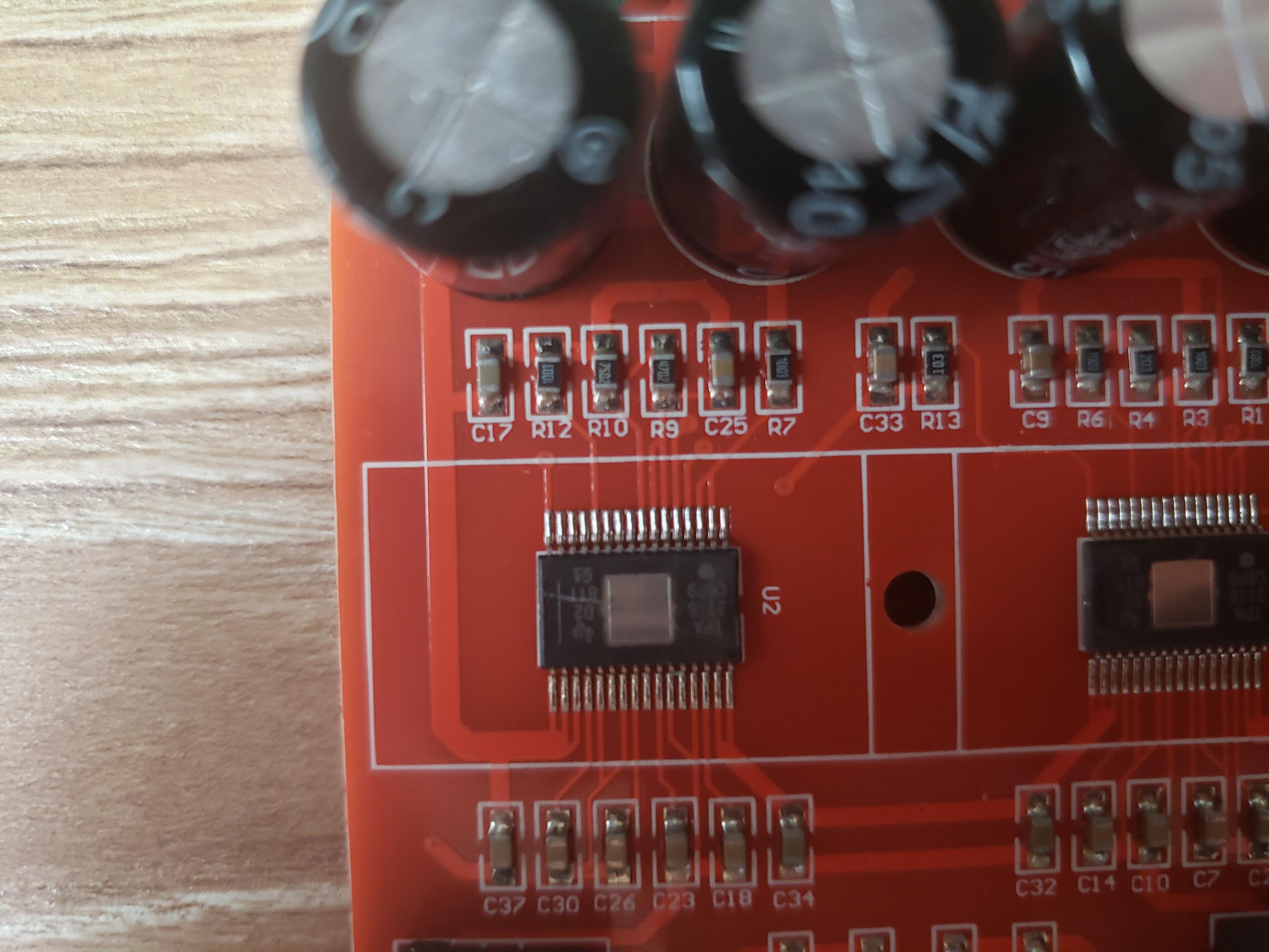

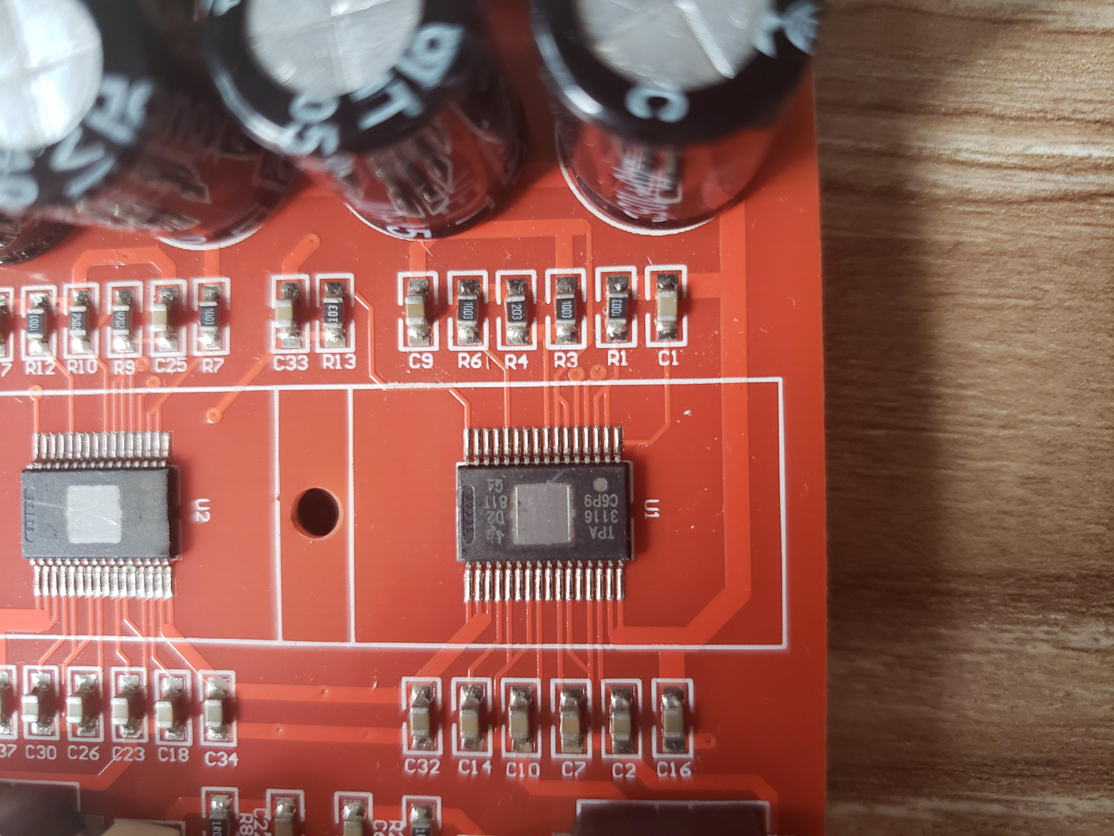

flo777, would it be possible that you remove the heatsink, takes of close-up photo of the two TPA3116 ICs and the resistors around? Your board is different from ours. You write that yours is a XH-M190 while ours are XH-M590.
Hello Flo,
Just to make sure here's a couple of pics of my board yours will very likely be similar
The group of three is duplicated above the highlighted group and these are under my heat sink.
and a close up
Hope this helps.
Cheers - Jem

Sure, please see the attached photo.
How can I get the minimum 20db gain (since I'd like to use a preamp with it), and do you think that will also improve the low frequency response along with removing the hiss?

Hi flo777,
On your board, U1 is set as "master" with 26dB gain (100K/20K) and U2 as "slave" with 26dB gain (47K/75K). The two ICs are synchronized.
If you turn the volume potentiometer fully down, do you still have much hiss?
