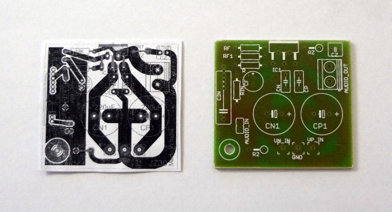

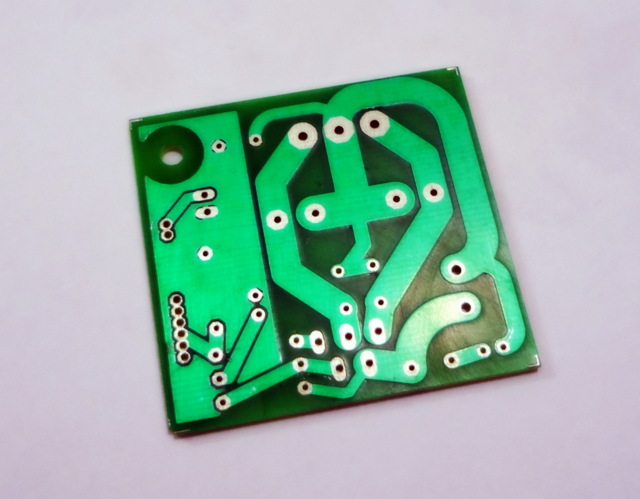

@Kuldeep, This PCB seems to be really large. I do know you have the power supply on board, but consider a perforation in the board with jumper links (Peter does this beautifully on his LM4780 boards) so that the PS can be removed, and also along the length to result in mono boards. The reason is that this has possibilities for DIYers to integrate these into compact PC theater solutions in multichannel configurations. The way you have designed it makes it suitable only for stereo applications, a little flexibility might help.
In any case your design indicates that solid wires will be needed to wire the supply to the amplifiers. I don't see the point of putting components on a board then using wires to hook them up.
On the board itself, it again seems overly complex. You may want to go down one size resistor (1/8W works great). My 1875 P2P builds usually never exceed the footprint of the chip. I do know you cant achieve that with a PCB - but maybe you can.
On your squiggle - I would suggest putting the resistor pads back, that way one has full control over whether they want it or not. A PCB trace modification is not as easy as choosing between a resistor and a jumper. Needless to say the resistor isolation comes with its own issues.
Connectors are much easier to access, connect and solder to free wires when they are at board edges. They also free up space within the board and make clean wire management a possibility. See if that helps you, I'm particularly thinking about the power and input connections. I would see that freeing up a lot your problems with the layout - but at the level of a single board.
The routing looks very untidy - on this I agree with everyone. Try drawing it first on a piece of paper. It will need to be rethought. Just moving stuff around will not work. I might suggest using more resistors vertically. The chip is divided into two 'halves', with the left handling the low-level signals and the right handling high currents. Visualise the flow of current and it'll be easier to crack a good layout. I would suggest staying away from planes for your first designs, and instead using two paths per chip, one for each kind of current and returning only those connections that are absolutely essential.
One reason I use few PCBs is that most are terribly designed, I only resort to buying PCBs for non-critical applications such as home theater. It's much easier to route currents when you do it by hand.

This board looks complex to you, its an easiest layout of which one can think of. I am using common available components, 1/4 w is most available. I have also made 1/8W for an another project, but i know how difficult was to source them.
I didn't get what you are trying to convey. Is it about Signal_ground resistor.On your squiggle - I would suggest putting the resistor pads back, that way one has full control over whether they want it or not. A PCB trace modification is not as easy as choosing between a resistor and a jumper. Needless to say the resistor isolation comes with its own issues.
All the other people didn't say it tidy or untidy, is the functionality that's important. And i will not use vertical resistors, every vertical resistor adds extra length of wire. And my design is same way as you have mentioned. Input on left side, output on right side and power supply in center.
The trickier job is to place 2 ICs side-by-side where output of left IC is closer to input of right. And i have kept maximum possible separation between them. And i feel its very much OK, considering the distances of wires & signal inside the Chip die itself.
You have completely misunderstood me. Please read my post again with deep breaths, and you'll see that I was appreciating your efforts. I see that you have taken offense and I shall desist from contributing on the thread.
As long as you're happy with the board, good for you. All the best with your project.

Thanks folks,
The tips i got are, i need to redesign the power supply layout by
1. the 100nF near the rectifier can be omitted and the 100nF near the ICs may be sufficient for HF suppression.
2. I need to divide the ground plane going to +ive power caps and the right channel output ground.
3. And the zigzag trace to be avoided, may be i provide a ground resistor of 2R2.
4. Provision to include different sizes of input caps & non-polarized zobal cap.
& May be a thicker "Audio output trace for Both ICs.
I'll update the PCB shortly.
