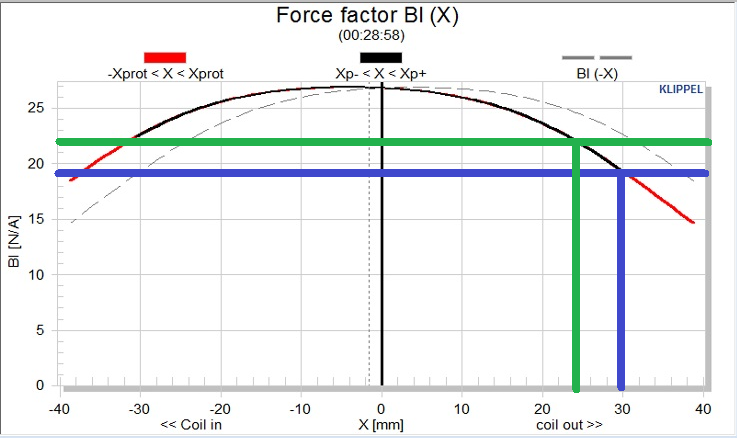

Our first motor iteration was Klippel'd at 31 mm and with the improved topology and longer coil that we are using on the 24 it will have 35mm or more one-way liner travel. We will be sending out the motor on a smaller 15" driver to be Klippel tested this week. It's hard to find someone who can Klippel test a 24.
Here is the Klippel graph from the first motor that we did not even put in to the prototype phase:

Now I'll be the first to admit that I'm not intimately familiar with the Klippel testing process, but don't you just have to mount the driver onto a rigid baffle and let the machine run it's tests? Why can't you find someone that will do that? And are you sure soft parts don't affect the Bl curve? Since you only showed the Bl, I assume you KNOW this will affect all the other Klippel graphs.
To be honest, I'm starting to question the xmax specs on all your drivers now. The level of scientific rigor here seems to be insanely low.
Just in case anyone doesn't know how to read a Bl graph, here's a quick explanation. (Some manufacturer's I've encountered don't even know how and present wildly incorrect info.)
The horizontal legend is driver excursion in mm.
The vertical legend is Bl.
82 percent Bl is the standard for 10 percent distortion, 71 percent is the standard for 20 percent distortion.
So determine Bl at rest position (0 mm) and take 82 (or 71) percent of that figure.
Then look to see where the Bl curve drops to that level (it's usually not perfectly symmetrical so it could be inward or outward excursion that first reaches the limit), and read how many mm of excursion the driver has at that point.
On the attached pic we can see that Bl at rest is about 27.
82 percent of 27 is 22.14, represented by the green line in the graph below.
71 percent of 27 is 19.17, represented by the blue line.
So we can see that at 10 percent distortion Bl is limited to about 24 mm and at 20 percent distortion it's limited to about 30 mm.
This is nowhere near the published xmax for this driver. (Not to mention this isn't even the production driver, it's a pre prototype motor on a 15 inch frame with all different soft parts.)
Furthermore, Bl is not the only thing that can limit xmax. IM distortion, compliance variation, inductance variation etc, can limit xmax to values lower than the Bl curve alone would indicate.

It was an assumption that I now realize is probably incorrect.
Bl - The product of magnet field strength in the voice coil gap and the length of wire in the magnetic field, in tesla-metres (T·m).
I probably should have known this and don't mind admitting when I'm wrong. Thanks for pointing this out and correcting me.
Regardless, it's still absurd to bolt a pre prototype motor to a completely different driver and present a single Bl curve showing 24 mm xmax as proof that the production model will produce 36 mm xmax, especially if IM distortion, inductance variation, and compliance variation can't even be tested.

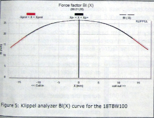

Other companies like B&C (since I've already mentioned them in this discussion) choose to present accurate specs. Below is a 3rd party Klippel of the 18TBW100 Bl graph (Bl was the limiting factor). They advertise 12 mm xmax and the Klippel clearly shows about 12 mm xmax at 82 percent Bl variance. They could have chosen to use 70 percent variance to show even more xmax but they chose the industry standard tightest definition of xmax as measured by Klippel.
Honesty is everything here. Xmax is measured in several ways by different companies so you have to know which company measures by Klippel (and what level of variance they use as a guideline, and whether they've actually tested a production driver at all) or by gap height (which is basically a completely useless spec) or by other means. There's already enough to worry about without having to try to sort through outright incorrect specs. This is a disservice to the entire market because EVERYONE wants to claim relatively high xmax and it leads to more and more cheating.
We should all be pushing hard for accurate specs, it's literally the only reference we have unless we can afford the time and money to just buy and test everything.

What is "absurd" is to question a piece of data that you clearly cannot read. The Klippel BL curve that I posted clearly indicates/shows a little over 31mm Xmax, not 24mm. Again, that was our prototype motor with a much smaller pole extension (larger pole extensions extend the coils immersion in the BL field which increases Xmax) along with a shorter coil than what we are using on the IB woofer (longer coils yield higher Xmax values). Combine the two pieces of information and you get higher Xmax. We have calculated the Xmax based on the results of fifty previous iterations of topologies that have all worked out to within a single mm or two of projected...which are backed up by Finite Element Analysis modelings.

I can read the graph just fine. As I showed earlier it has 24 mm xmax with 82 percent variance or 30 mm with 71 percent variance. So you are not incorrect here but you did use the most lax standard definition of xmax by Klippel standards.
What is not correct is to assume your production driver is going to perform the way you expect it to without measuring it and posting that info on your website. Bl is NOT the only thing that can limit xmax but you are not testing anything other than Bl with a motor strapped to a completely different frame with different soft parts. And at this point you are not even testing the production motor.
