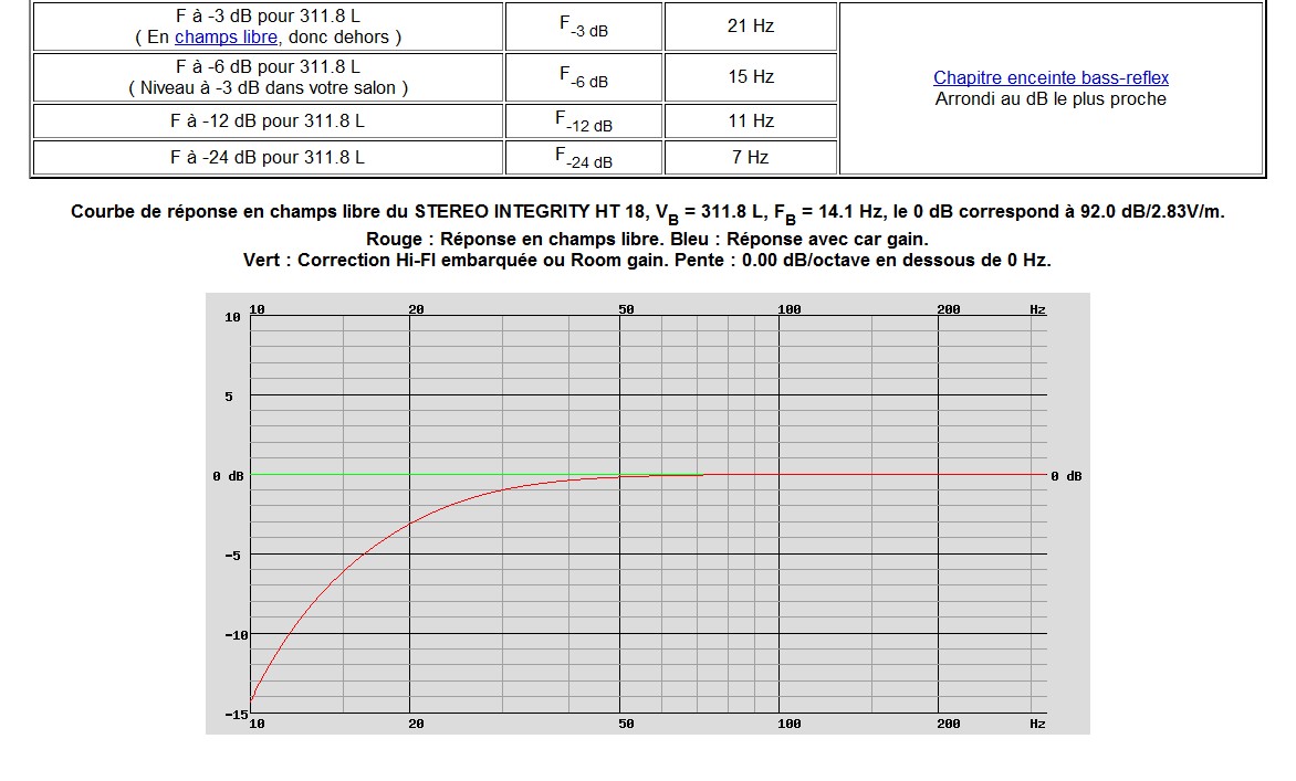

The 18 HT seems like value for money though, have not crunched the numbers yet, but you could probably reach 13-14hz f0 with one of Bjorno's designs.
SI 18 HT
Yes, it does infrasound in a easy way. Sim is in a standard (large) ported enclosure (with 4x~4"ports).
Or in a sealed type for QTC = 0.700 in a 200.0 L enclosure, F3=32Hz, F10=20Hz with only 660 W@4 Ohms. 😀
Will have a look at it when I have time on my side, maybe friday evening if I'm lucky. Key points are usually: lowest realistic goal frequency is 2/3 to 3/4 driver FS, between 1/4 to 3/4 SD, 2-3xSD. VAS gives indication of volume, but not accurate, variations of 100-200% VAS equals volume of box excluding material (pending on f0 goal). Aim for flat response but expect around maybe 79-81dB/2.83v at f0 with this driver pending on design choice and how low f0 is.
In my book the -3db point is not anything you should look at. Many port based enclosures will often start having breathing problems there because of various phase and impedance loading issues (most enclosures emulating closed box response curves usually excepted), not to mention velocity and possibly difficult room interaction pending on location of port.And I think a good practice is to have a HP at ~66% of f0 to slowly roll off undesired side effects. Unless you have allready taken usage patterns and the rest of the system into account.

That only applies to small boxes. I make large boxes designed for Sound Reinforcement applications since that is the field I’m in. The -3 dB point is standard and used by all reputable manufactures in Professional Audio for decades.
Very good. Most professionals would also use HP filters at just below -3dB, to dampen these effects, it is just good practice, leaving more power and headroom for frequencies above -3dB. So I still see this as valid, your input is appreciated.
You will automatically have more headroom above the -3 dB point if you design the box to have a flat response above the -3 dB point. Not sit a -3 dB and hover there a few octaves before collapsing down to -10 dB. That is the benefit of using a big box with a driver such a Stereo Integrity 24" IB.
