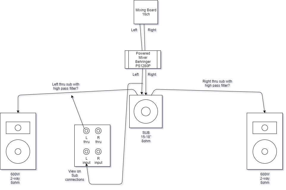

this is more of a theoretical question at this point but is it feasible to build a passive sub that takes the stereo line outs from the amp (600*600W), process the signal through a crossover and send to the FOH speakers?

I was thinking that as my PA is 2 x 8ohm sends that it would be better to divide them through the sub somehow to keep power levels even through the speakers.
Would it be noticeable/incorrect to have one side, say L with sub and 2 way (4 + 4 ohm) and the other side, R just 2 way (8ohm)?
The system is for live gigs (5 piece) and most channels are panned evenly or a little one way or the other but it wouldn't matter that much with bass freq's and I could pan them to the sub side if you think that setup would work.

The sub will need the highs removed to sound decent, and even then, will likely need separate volume adjustment from the main speakers. If you do want stereo mains, a separate amp for the sub would be best.
Your question could be answered better if you gave the model of the "PA".
Sounds like it is some form of powered mixer, you may have the option of inserting a sub processor/crossover on one of the amp channels, which would allow you to mix the balance of the sub, and only pan channels that could use it (like kick drum and bass) into the sub channel.

One way to achieve this is to phase invert one channel and then connect the sub in bridge mode + terminal to + terminal with a passive low pass filter. Inverting one channel might be as easy as swapping the wires on an XLR input. The mid top speaker wired to the inverted channel would also need the speaker terminals swapped over to restore the proper phase.
Although this will basically work, this might cause a few issues, not the least being the load on the amplifier as it would probably be seeing anything down to 2.7 ohms per channel. The overall response would probably be very bass heavy which might need some EQ to reduce the bass or passive high pass for the mid top speakers. The bass driver might get the full 1200w rating of the amp which might be excessive!
The only time I have seen this sort of set up practically used is with a car amplifier, which often have one channel phase inverted permanently to make bridging easy.
Thanks Art for your reply, yes, this is a powered mixer. I've attached a quick diagram of my proposed layout that should make things clearer.

That setup is not ideal. L plus R on one channel and sub on the other works though if there's little panning anyway.
