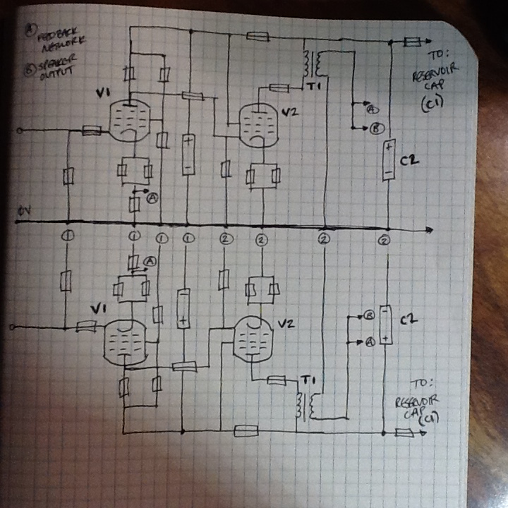

I have a hopefully, (final) inquiry into my first build- a stereo monoblock class A EF40/EL84, very similar to the classic Mullard 3-3.
I have built a working prototype and am hoping to reduce noise now that I have my head around the basics of building from a schematic.
I am using a PT in which I am sharing HT and filament windings between channels. I am using the 5V tap to power a GZ34 rectifier for the build. (Overkill, I am aware, and will be switching to diode FW bridge at some point)
I've attached a layout of my grounding scheme. With the constraints of the PT, would I be forced to share the 0V rail between channels, or should each channel have its own 0V rail, meeting at some star around each channel's C2?
Should the chassis ground point be placed as close to the L/R channel star point as possible as well? I was looking at Merlin's grounding page and his multi-channel section seems to indicate something close to this? But it says to implement with a 'hum blocker network'. What is this?
Hopefully the diagram is legible. I appreciate any help you guys could provide!
Key:
A. Feedback network
B. Speaker output (+)
1. First stage grounds
2. Second stage grounds
Assuming this stays in SE class A, the current from the supply feeding the output stage should be ideally constant (that goes away if the amp goes into clipping, but then a lot goes non-ideal if that happens!). So I think you'll find that having the supply grounds common there will be just fine since there shouldn't be any output signal flowing through the power supply.

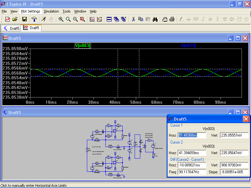

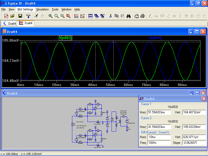

But -- the common supply grounds at the inputs isn't a great situation and is a recipe for ground loop noise problems (hum due to safety ground currents). It can be fixed by separating the L and R channel input circuit grounds from safety/main ground by some small resistors (say 5 to 15 ohms). Those shouldn't upset the biasing of the input stage, but would greatly decrease any noise current flowing in the input ground shields/returns. TubeCAD has several articles about his "Unbalancer" which is a variation of this concept, and I did a circuit analysis with some typical valuesto help understand why it works. It does work, and really well. Some amps of mine went from unlistenably hummy to silent background. See below about where to put the resistors.
Thanks for the reply. That seems to make sense. The input sockets are isolated from the chassis. As of now, the chassis ground is at the star with the PT CT, filament CT and reservoir cap (-).
I'm wondering if the grounds from the two channels should be on seperate buss runs from the first filter cap (C2) to V1's grid-to-ground resistor? I guess that's what I was trying to illustrate- should both channels share a common ground buss between them, with all of V1 (L) and V1 (R)'s grounds, etc. tied together? (Sort of mirrored, as illustrated in accompanying drawing)
Or, should the ground buss split after the reservoir cap, going to each channel's RC filter for V2? And then, does this mean the ground buss to chassis connection should be here where the teo branches intersect?
The Mullard 44 seems to do it the former way, with the shared 0V split right after the reservoir cap. Is this the best way to reduce noise?
This illustrate pretty well the issue.
i) Two input grounds connected to the same ground point on the PSU via L4 and L5 (just 50nH !)
attachment.php
ii) Two 10 Ohm resistors, HBRL and HBRR, between signal ground and PSU ground
attachment.php
In this case, this represents an improvement in hum reduction of about 56dB. :santa2:

I suppose I'll just experiment with jumpers for the best spot from 0v to chassis. My feeling is noise might be reduced if I place it closer to where the two channel grounds merge together before meeting power ground.
The only remaining issue to work out is whether there is an advantage in noise level in keeping the two 47uf decoupling caps grounds tied together as seems to be common with the earlier layout documentation I can find. (Can caps and the like)
But it seems like it would make more sense to have the second decoupling cap tie to V1's grounds and the one closer to the reservoir, (C2) to V2's grounds.
On that note, I imagine the entire circuit would benefit from additional smoothing or another RC filter- perhaps before V2's screen or T1?
