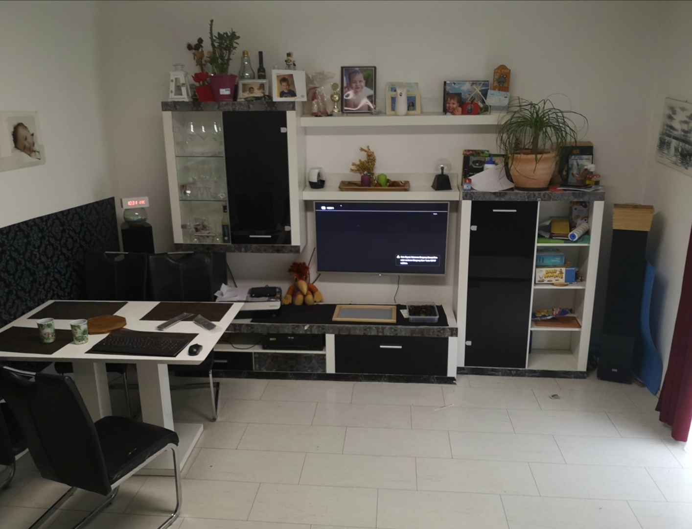

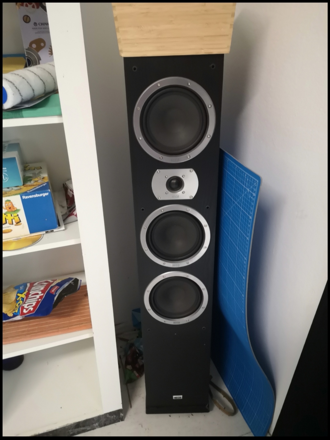

The thing is I already have 2 decent multi way floorstanders that fill the room. On the other hand they get a bit too much watching movies sometimes. Having two little kids doesn't help much either since I need to keep those pushed in the corners and there's where they get "boomy". Pulled away from the corners and walls they sound much more balanced but there are only rare occasions when I can enjoy the music this way. That's the reason I want to build something that will fit right under my TV and stay there and possibly produce half way decent sound. The space is very limited so I don't think having two separate enclosures will do much for me as there's really not much room to play with and that's the reason I went for the soundbar idea. I'm planing to use this one for background music and mostly for the movies when the kids are in bed so don't need much power here either. The unit being 1100mm wide only leaves 200mm space between those two cabinets and that would be the room to play with if I had separate enclosure which would also call for another enclosure to put amp and power supply in and more wiring.
Everything is being run off my computer so I got a decent equalizer there and I have the ability to play music off my phone where again I have the equalizer on hand.
