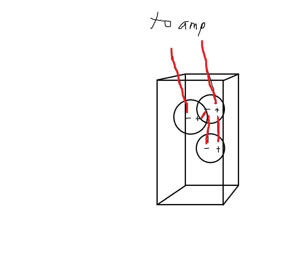

stereo 3 inch tang band computer speakers - two drivers in each speaker - W3-881SJF ?
Actually the speaker in this configuration would have 12 ohm nominal impedance.
I think all the drivers should receive the same power though.
One in the front and two in the back.
The 8 ohm driver in the front receives half the power of the two 8 ohm drivers that make a 4 ohm load, no?
Still not sure it's a good idea though 😕

Lol, no.
Give up.
I'd say go with your first idea. Most amps will be able to handle 4 ohms.
Keep it simple.
What you are proposing now has the scent of biggerism or second system syndrome.
Build the first system first and then judge from that.

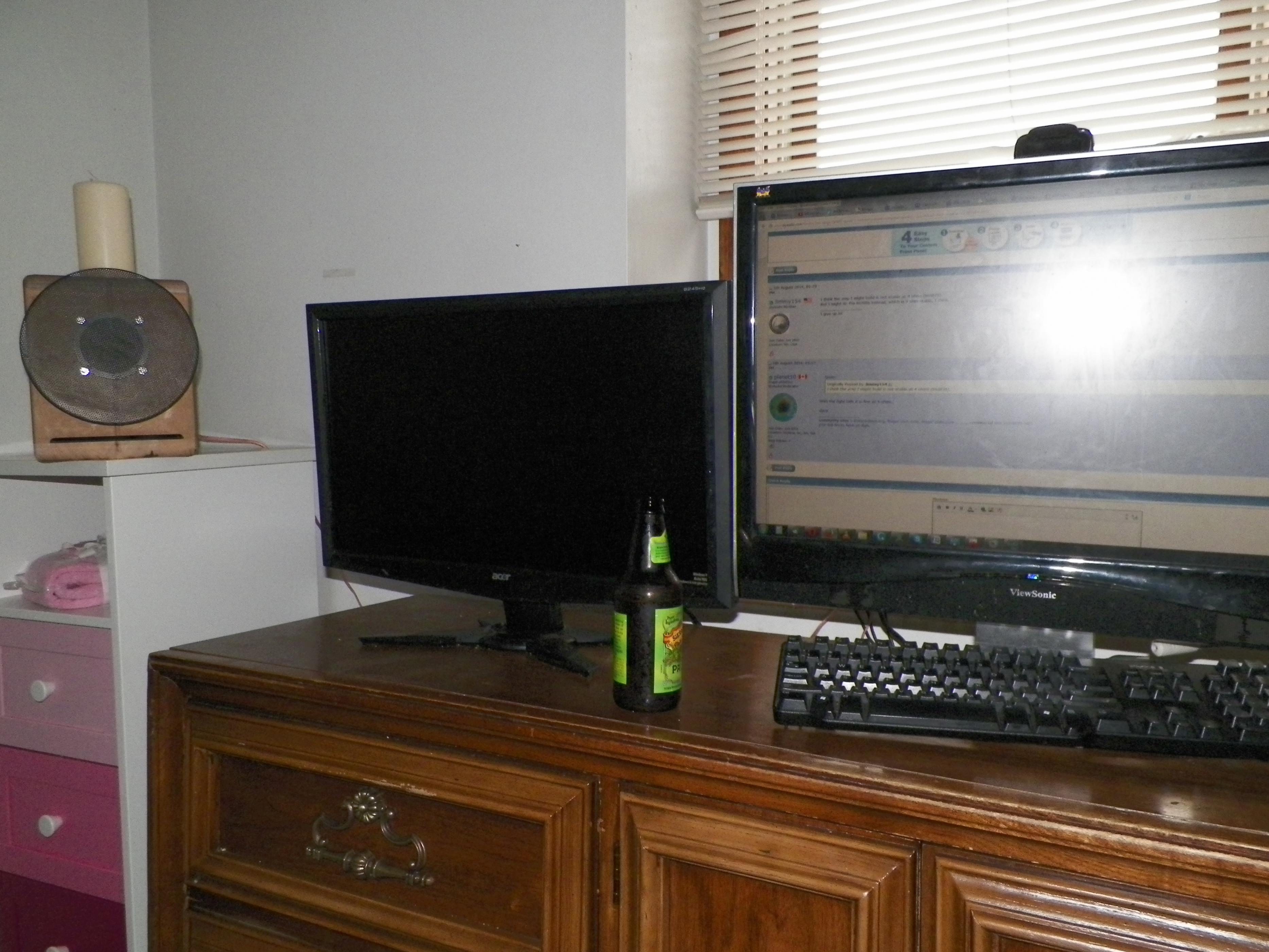

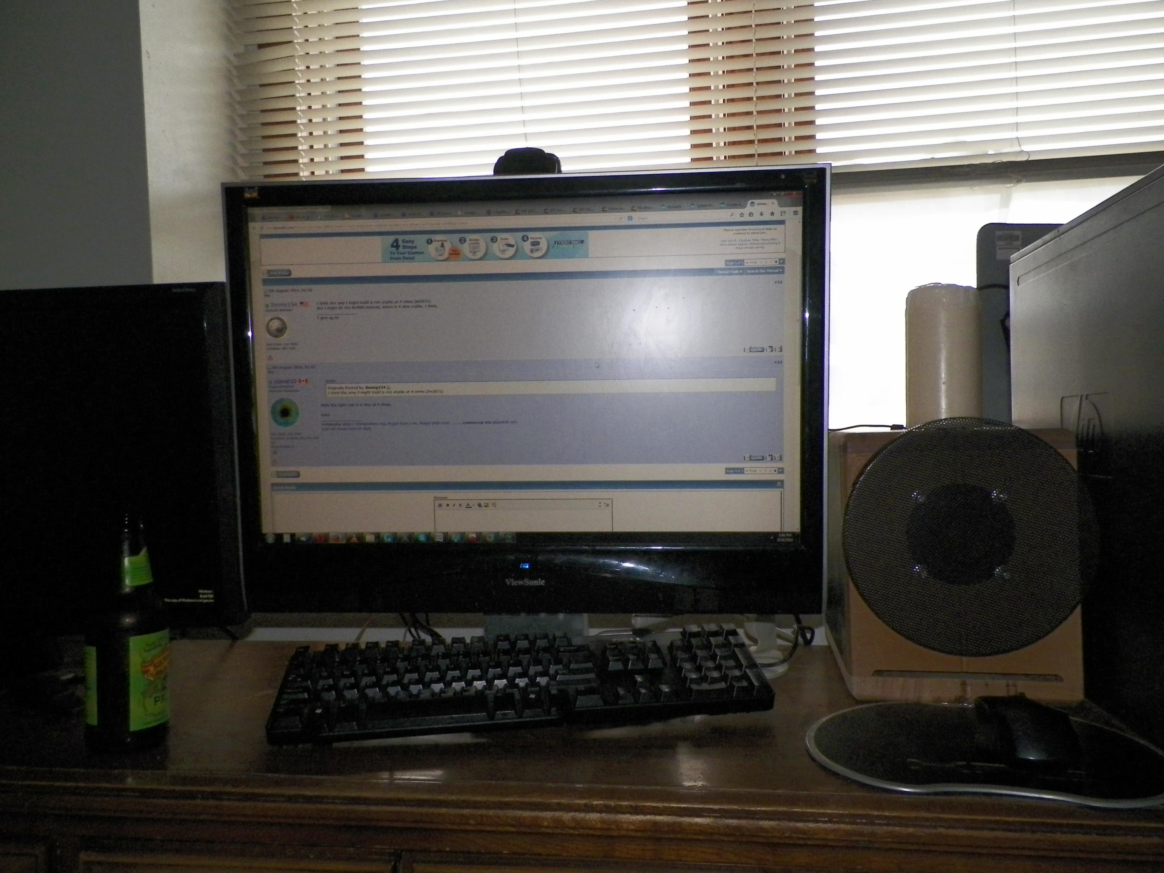

With your 2-monitor setup, are you sliding back and forth between the two or sitting in the middle?
My suggestion is sit in the middle, angle both monitors toward you, and have a single-element speaker on each side pointed directly at you (which is exactly what I am sitting in front of right now, and also at home).
With your two speakers pointing straight out and so far apart, and sitting close to the monitors, no wonder they don't sound right.

I sit mostly right in front of the right speaker.
Sounds like I need to figure something out.
I wish I could put speakers under the monitor(s).

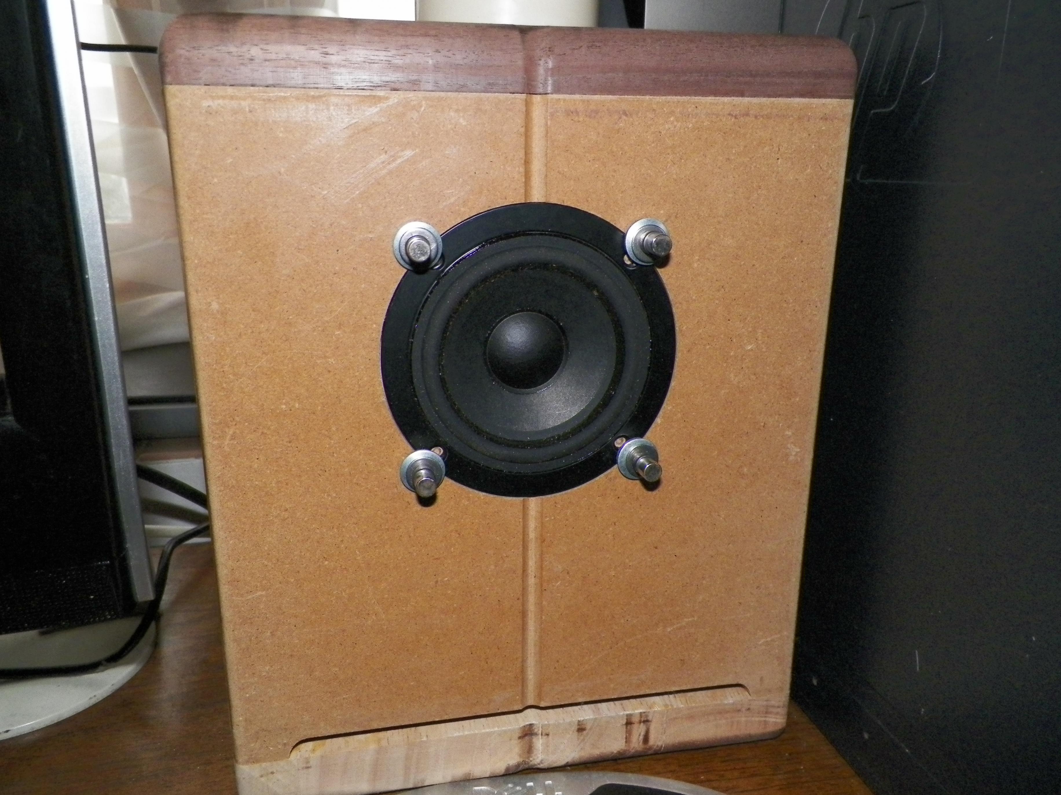

I'm building some two-ways, but waiting for the drivers for the 2-ways I slapped together these 3 inch speakers.
Not bad, I generally like them, but a design with two drivers in each box about 30-45 degrees with respect to each other I think would have fix some typical problems 3 inch drivers have, dispersion and extra surface area for my system, but also FR for non-EQ'ed systems, at least for my taste.

My head is about 3 feet from the right speaker.

I built these waiting for some tweeters for my 2-ways I started and now I like these due to their size and shape.
They have poor dispersion horizontally and could use a little more output.
