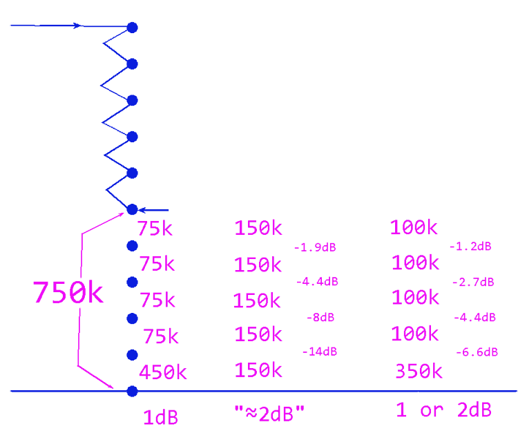

Since 750K M-N taper balance pots of high quality appear to be as scarce as unicorns, I am looking at putting in an 11-step 2 pole rotary switch, with resistors.
I recognize that to work like an M-N taper, each deck should have six of the 11 positions with no resistors, in mirror image (opposite directions) to one another, with the center position having no attenuation of either channel.
I also understand that the "taper" of the remaining five positions that will have resistors should be logarithmic, but that's where I start to get lost - abstract math has never been one of my areas of skill/comfort.
Can anyone please advise how I would "taper" 750K over five positions to work like a logarithmic balance control? Or a "for dummies" way that I could calculate it?

Rather than a pseudo-log taper, decide how much imbalance you want in dB for each position,
and then calculate the resistors accordingly. For example, for each side the first position could
be -1dB, the next -2dB, then -3dB, -6dB, and off. You really only want to correct for
a small imbalance, since anything more indicates a problem somewhere.

Unless your balance errors are exceptionally well disciplined, there is no strong reason to make them exactly equal-in-dB.
And good reason to avoid brain-strain for theoretical purity.
We know it will be 750k total. And 1dB is 10%. So start with a 75k resistor. Get lazy, throw in some more. In fact 3 steps comes out 525/750 or -3.1dB which is "3" for any practical purpose. (Again: no reason to suspect balance errors will trend to whole-dB intervals.) So throw in a fourth 75k and finish off with 450k to make the 750k total.
If your rig is more than 4dB off center maybe you should fix it. However sometimes we got what we got. Try 2dB, 20% near-enough. Throwing 150k at the poles comes out to 750k but the steps grow to 6dB. If you have to fix a large unbalance, that rising-step sequence may be useful.
So split the difference. Use 100k. This grows from 1.2dB to 2.2dB.
If you need to be fussier than that you probably want many more steps.

OK.
You have to preserve the total resistance of 750k to make the rest of the circuitry work as per original (original max gain, and original frequency response).
Attenuation Resistance at switch output
0 dB Switch contacts the top 750k total.
-1 dB Switch contacts 89% of 750k
-2 dB Switch contacts 79% of 750k
-3 dB Switch contacts 70.7% of 750k
-4 dB Switch contacts 63% of 750k
-5 dB Switch contacts 56% of 750k 375k in series with a 45k resistor = 420k to ground)
-6 dB Switch contacts 50% of 750k (375k resistor to ground)
I think you can calculate the additional resistors for each step in the series string to get 750k to ground at the 0 dB setting.
Oh, and for the full attenuation (no signal),
connect the switch wiper to ground (the bottom of the 375k resistor).

Thank you all VERY much for this input and guidance- now I'll give some thought as to how "fast" a taper I want to aim for- but the info that you have all provided gets me unstuck.
I do recognize that there's not going to be a lot of subtlety with only five working steps between no attenuation and 100% attenuation. This is just an attempt to do something that leaves some degree of functionality that's better than nothing and more trouble free than a potentiometer.
I really appreciate the input.
