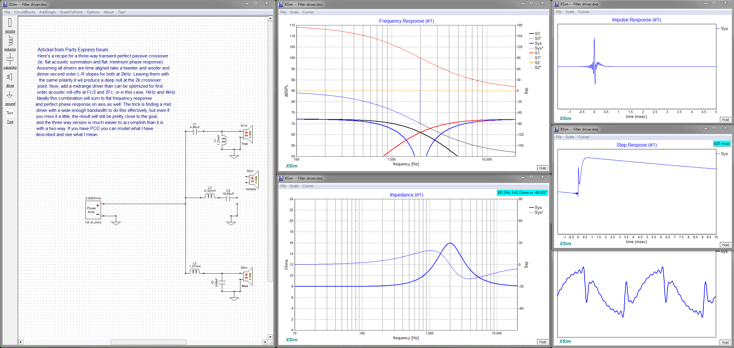

Here another fun study made in XSim based on build in textbook drivers that weird enough relate on being 180º out of phase : )
It's B&O filler driver principle where roll off slope created by deep null for LR 2nd order XO'ed woofer tweeter wired in same polarity create transient perfect system on axis when null is filled by a 1st order band pass mid also wired same polarity. All three drivers end always being 90º apart as with 2-way 1st order systems. In first plot graphs show the great data, then look second plot graphs when mid is pulled out of circuit. There is no system stop bands into this study which will make a difference on phase there, attach XSim dxo file if you want to play around pull mid in and out and study, also text in schematic window have guide how to setup filter slopes.

This kind of approach is not at all as practical as it would first appear. The first problem is that you would need drivers that have an extremely wide bandwidth because the slope of the filter (1st order) is so low. It looks like your modeling does not take into account the phase rotation of the driver itself - that's a giant oversimplification for a system that is trying to model phase/time effects. A driver is a minimum phase device. Around resonance and a few octaves on either side the phase is anything but flat, or zero. The same is true within a couple of octaves of the HF rolloff region - the phase starts to change rapidly. The phase rotation will change the phase of the output, which will influence the ability to stay time aligned (time delay and phase rotation are related). I am not sure if your sims include this, but the drivers themselves can have vastly different placement of the acoustic center behind the front edge of the frame. This is why some designers "tilt" the baffle in an effort to improve the (physical) alignment of the acoustic centers. So, while a purely electrical sim looks great, if you don't have those acoustic centers aligned then you won't get your nice time aligned waveform either. Related to this is the fact that as the listening axis moves away from the axis where you have physically aligned the drivers (e.g. on axis) the drivers are no longer aligned and get more and more un-aligned as you move farther away from that axis.
Because of all of this, going to great lengths to time align a system is really not worth it. From what I have read, research shows that the brain "hears" something like the magnitude of the Fourier Transform (the frequency domain representation) of the time domain signal arriving at the ears, and the brain also does a lot of interesting "lumping" of different "arrival times" together (e.g. the first 6 msec is all perceived as the same signal). Alltogether this seems to indicate to me that time alignment makes things look nice on a scope but has little to do with actual hearing of the sound from the loudspeaker, and listening tests with music signals (not clicks, etc) seem to bear this out.
The best of these "time aligned" systems can reproduce a square wave at SOME frequencies on the design axis, but not for other frequencies, or other axes, etc. I have seen designers going to great lengths, for example using stepped baffles, to try and achieve the holy grail of time alignment. Unfortunately they are more likely creating unwanted diffraction from the edge of each step, which will do more harm than the "good" of any time alignment effort. It might be better to look at the big picture and not get stuck over-optimizing this one aspect of loudspeaker design.

CharlieLaub,
You right model is simply the perfect electric slopes and summing as in electric domain, mostly posted because sense eriksquires like playing with XSim and there was relations to what he posted about phase. Regarding phase i changed over time experimenting and now favor FIR corrected XO points so IRR phaseturn only visible at stop bands and the lower the IRR roll off reach is in LF section the better, admit it takes massive DSP gear steering and processing time but ended over time and many exercises to sound best i ever had. Thanks taking time share good points.
