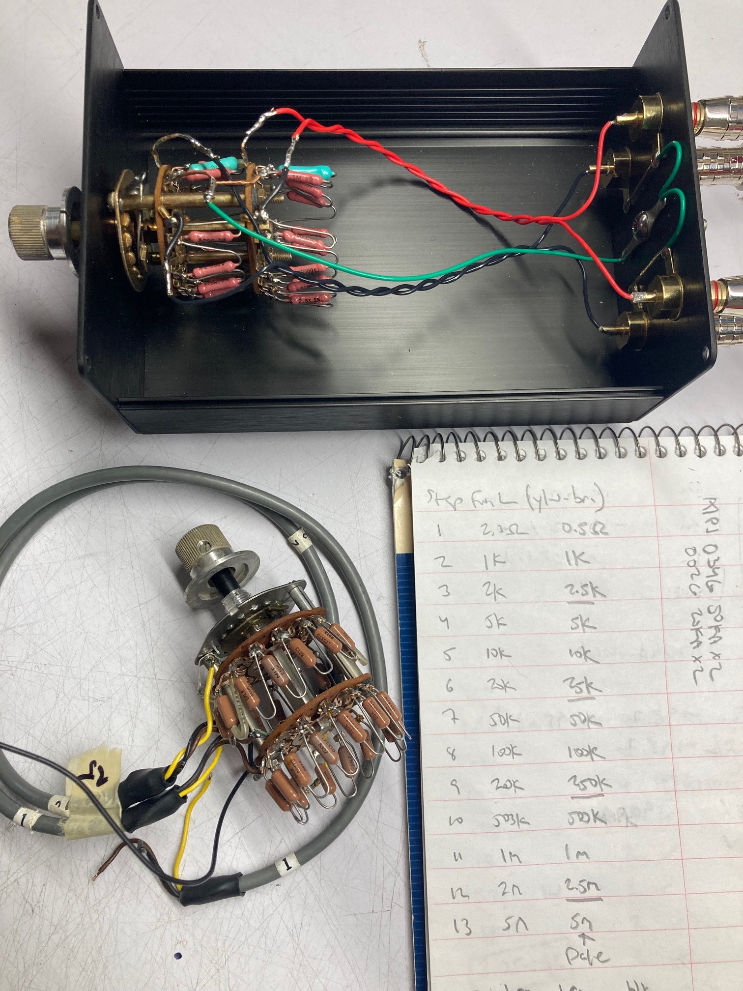

Awhile back member Adason had a near-giveaway of dual stepped attenuators like the ones shown in the picture below (these two are from Adason). Unfortunately, these two particular attenuators don't have matched values, they differ at steps 1, 3, 6, 9 and 12. also, they step backwards meaning the highest resistance occurs at the far-clockwise position, which is fine by me. Anyway!
I would like to use two matched attenuators in a Balanced Iron Pre project. If anyone who picked up an attenuator identical to either one of these from Adason has one for sale, or wants to swap with me to create a matched pair, please let me know. Thank you!
red resistor values at those steps: 2R3, 2k, 20k, 200k, 2M
brown (Dale) resistor values at those steps: 0R5, 2k5, 25k, 250k, 2M5
remaining values written on the paper

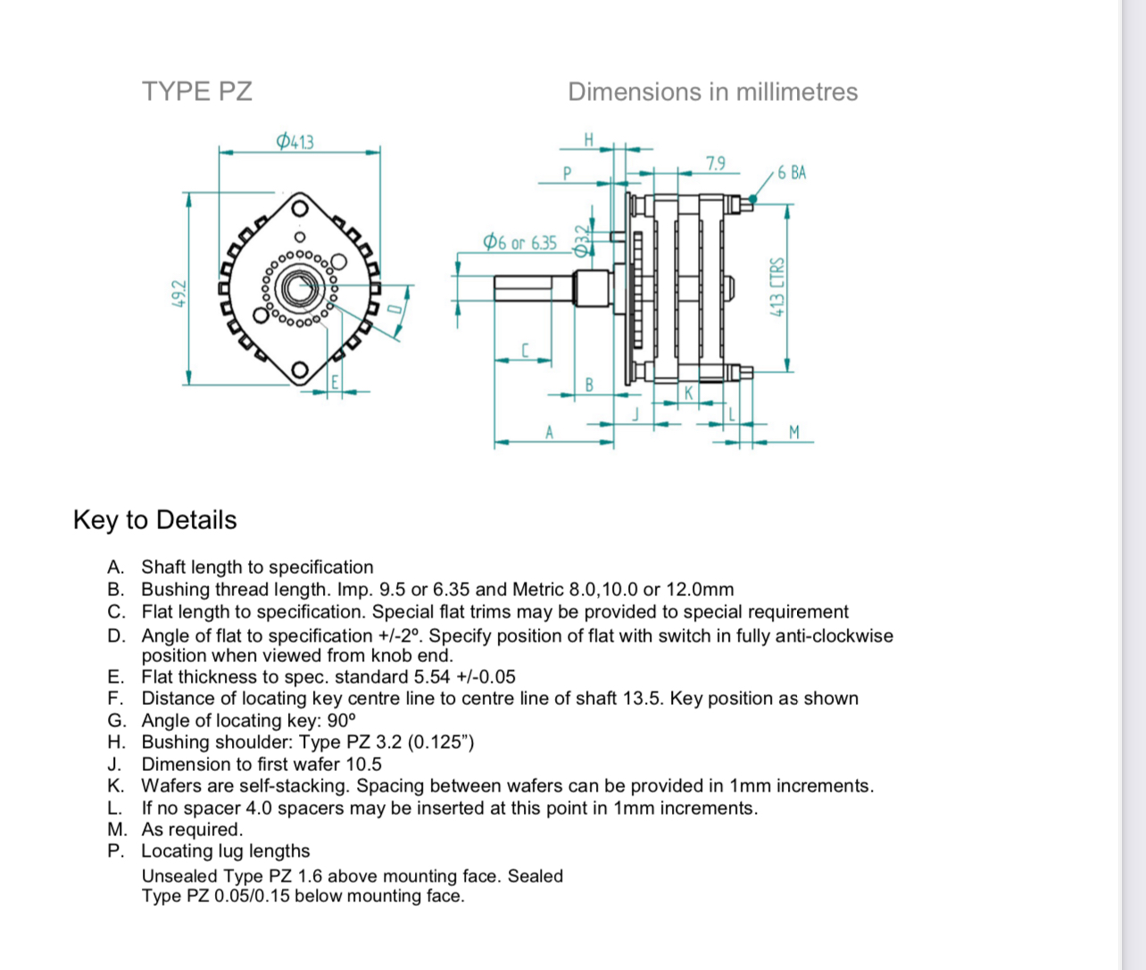

I have been really pleased with the quality of switches from Blore Edwards take a look at the PZ switch. There website is mainly PDFs but the switches are great. You will need to customise the spacer between wafers so you can for the resistors. Or talk with them they seem to have SMD PCBs that appear to already do what you want…

I appreciate the suggestions gentlemen. Part of my aesthetic for this build is to try to find and properly repurpose discards/salvage that someone of sharp eye and practiced in the art recognized to yet be of use and value. I am inspired by ZM and his repeater transformers, pulled from old telephone exchanges, that made old CD players sing. Though I practice this art of scavenge from a much more intellectually basic starting point, to me the 'junk' pulled out of god knows what kind of control console that used resistors matched to 0.001% is far sexier than something I can buy off the shelf. I may yet give up and throw $$$ on stepped attenuators, but not yet, not yet.
