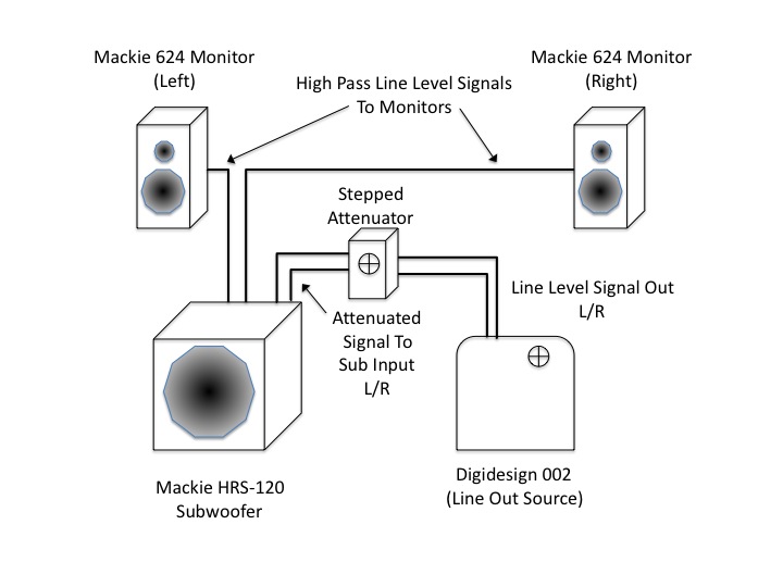

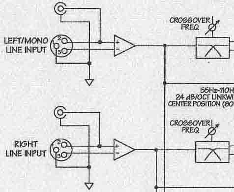

Grounding fixed it!
Oshifis, your suggestion of grounding the point at which the two switch decks are connected worked. The system sounds great. Quiet at Pos. 0 and smoothly increasing in volume with each increased position. SPL levels running pink noise match left and right at every attenuator position (my meter is digital and reads in 1 dB increments, so the sound levels match to less than that).
Thanks again to all of you who contributed to this process.
Mixing and mastering
A precision stepped attenuator is used as a precision volume control when playing back thru studio monitors for mixing and mastering. It is critical that the balance between the left and right channels be consistent over the whole range of sound levels, and it is also important that the particular sound levels used for mixing and mastering can be reset with precision.
This is challenging for most continuously variable potentiometers, but relatively straightforward for a cascade of precision resistors wired to a rotary switch.
