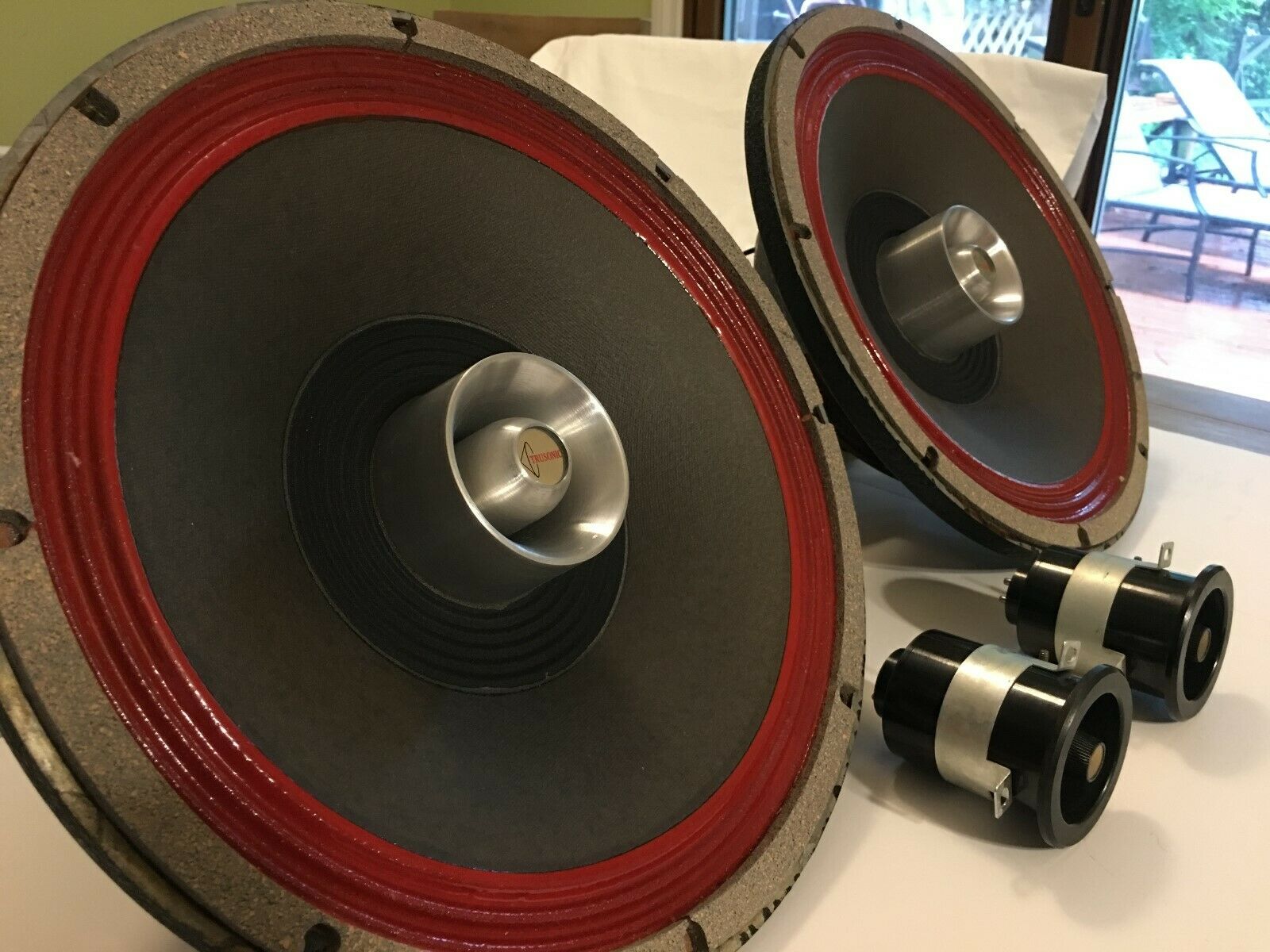

I have a pair of lovely trusonic 120cx, man they are sexy looking speakers!
There isn't a great deal of information out there about them especially there parameters.
I have a dayton dat v2 which i can use to get some speaker parameters, how accurate this will be i am not sure but it's a starting point.
Anyone got an idea on enclosures for this?

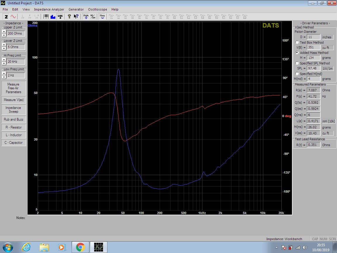

ok guys i got some results in, i used the dayton dats software and dats v2 device with the added mass option to get some TS measurements. This is just the woofer, i disconnected the concentric tweeter.
* This data was exported from the Dayton Audio Test System: DATS
* Piston Diameter = 279.4 mm
* f(s)= 41.72 Hz
* R(e)= 7.069 Ohms
* Z(max)= 78.34 Ohms
* Q(ms)= 5.938
* Q(es)= 0.5889
* Q(ts)= 0.5357
* V(as)= 295.3 liters (10.43 cubic feet)
* L(e)= 1.118 mH
* n(0)= 3.473 %
* SPL= 97.51 1W/1m
* M(ms)= 26.02 grams
* C(ms)= 0.559 mm/N
* BL= 9.048
* K(r)= 0.2046
* X(r)= 0.4097
* K(i)= 0.02258
* X(i)= 0.616
Please see attached txt file for further results.
Seems unlikely that the resonance is anywhere as high as 42 Hz (50% too high???) or the Bl as low as 9. Which would raise questions about the other measurements.
I like to do what might be called a sensitivity analysis where you bias the measurement in some way (say, adding some weight or using a precision weights to a weight measurement) and see if the new result is coherent.
I like to know lots about my tools, tend to be skeptical about the illusion of 3-decimal accuracy, and try to know when it matters or not.
B.

Hmm, these fall in line with other brand's driver's specs back in the days of wanting to make replacement drivers in other brand's cabs, so curious when these were made, but if these specs are after considerable [re] breaking in to loosen them up and them still warm, then probably fine.
Do need to measure both though. Note that it advertised 30 Hz Fs, yet measures 40+ many decades later, implying it's frozen up some, but back in the day Altec drivers tended to be 10+ Hz above advertised, so inclined to accept yours if the other measures within +/- 10% if the above criteria is met on both.
