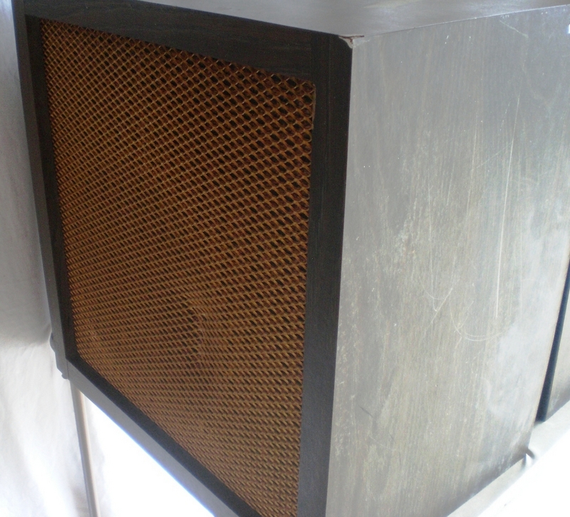

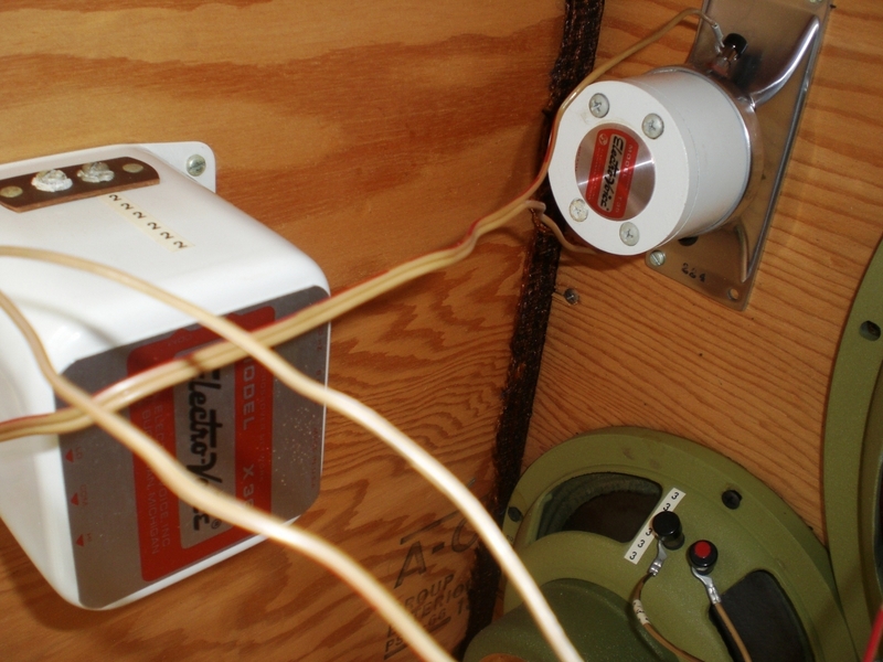

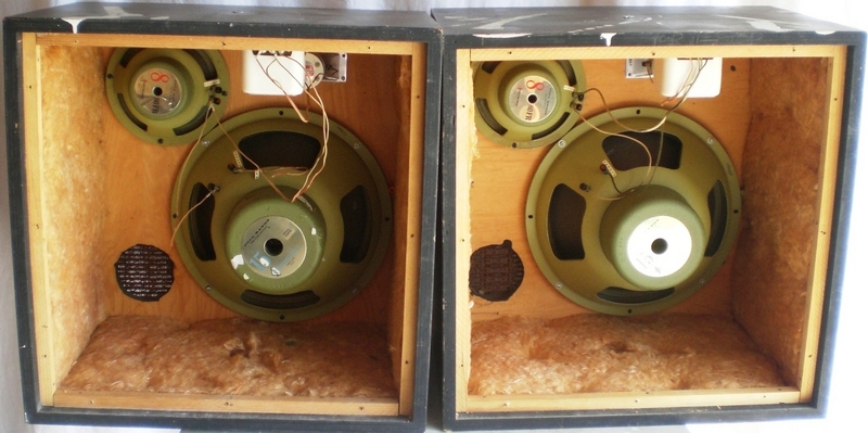

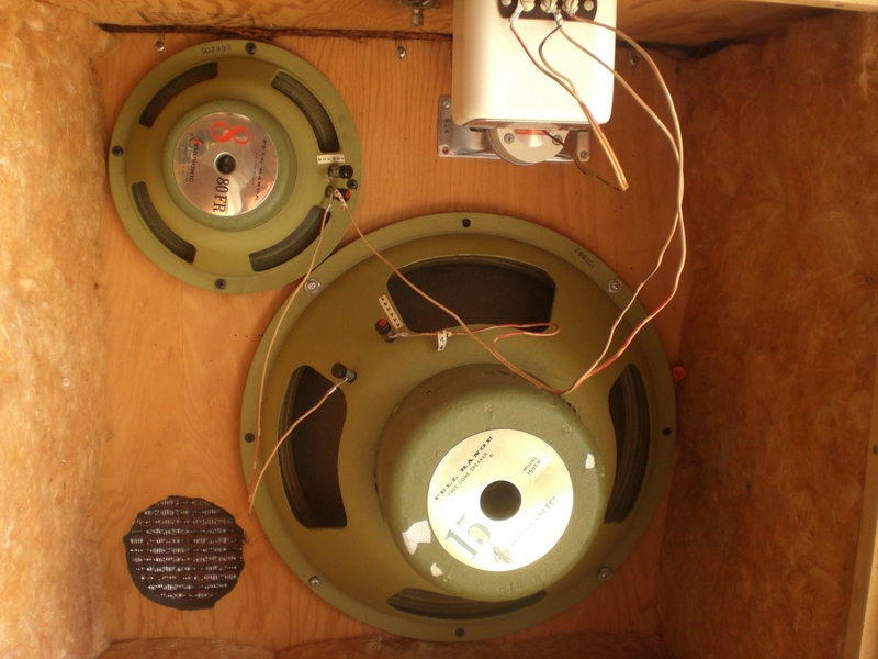

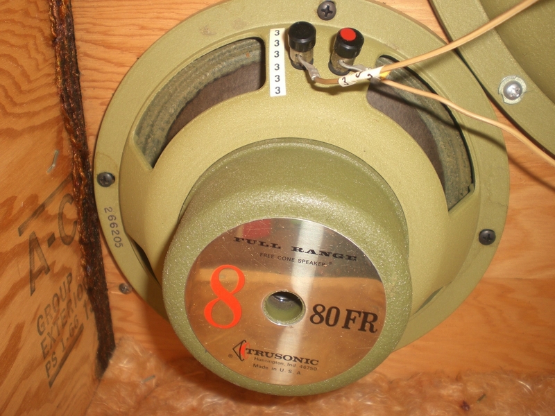

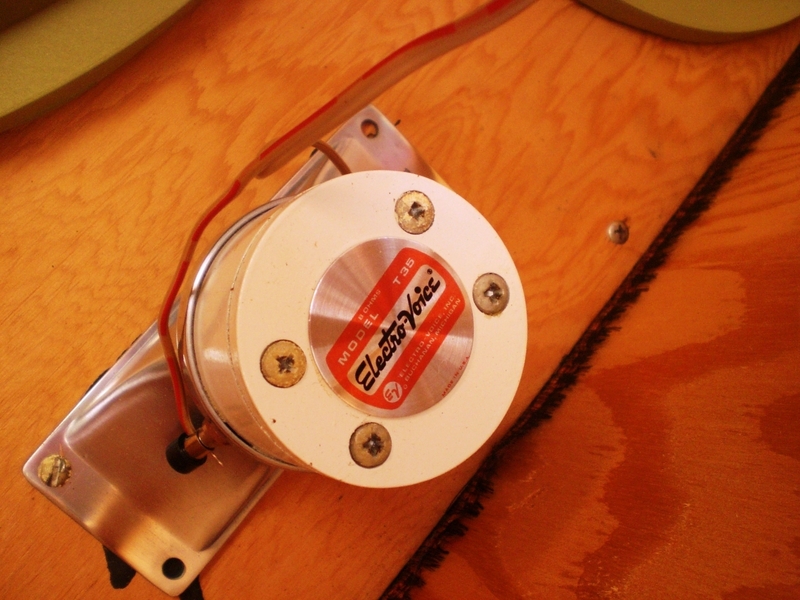

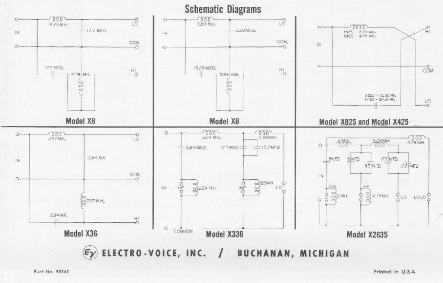

hi all! let me ask about loudspeaker from same producer - STEPHENS TRUSONIC my friend bought from the world wide. the problem is - crossover and connection bass, mid and tweeter. see the pictures please.
there are drivers used:
Trusonic Model 150 FR Full Range Free Cone Speaker
Trusonic 80FR stamped 266205 on both of the 80FR's
ElectroVoice T-35 Horn Tweeters which are stamped 224.
and ElectroVoice X36 Crossover which features 3500 HZ and 8 Ohms
I need original circuit diagram for this very interesting thing.
thank you.

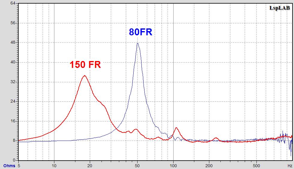

... and I bought a fabulous Stephens 150W, 15 inches, around 1967 and had some correspondence with the company about specs.
Maybe 3 yrs ago, took it out of storage and installed on a sheet of particle board screwed to the legs of a table forming a big irregular OB, mid-wall. The low range and the bump down at 23 Hz (roughly) perfectly complements my K-horn (which doesn't really go too far down) and the mix-and-match room excitation works nicely.
I wonder if there is anything about woofers today that are materially better than the Stephens? Stuff like shaping of pole pieces???
