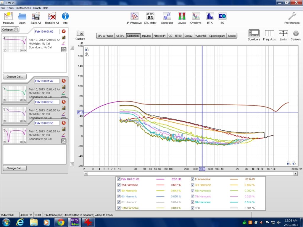

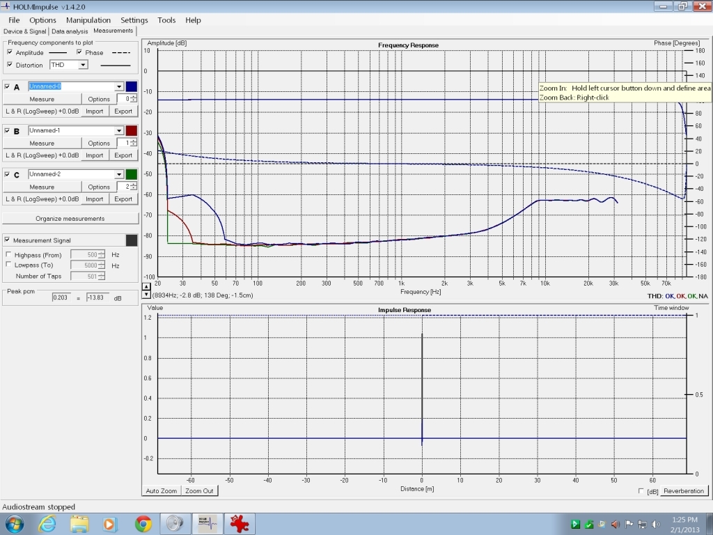

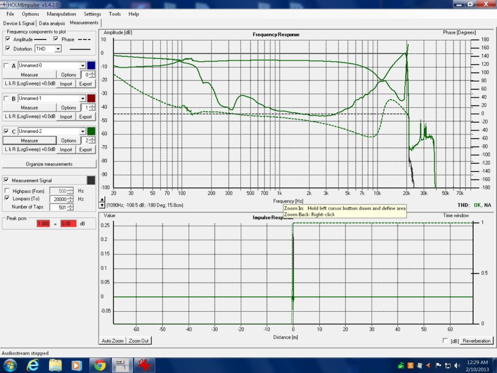

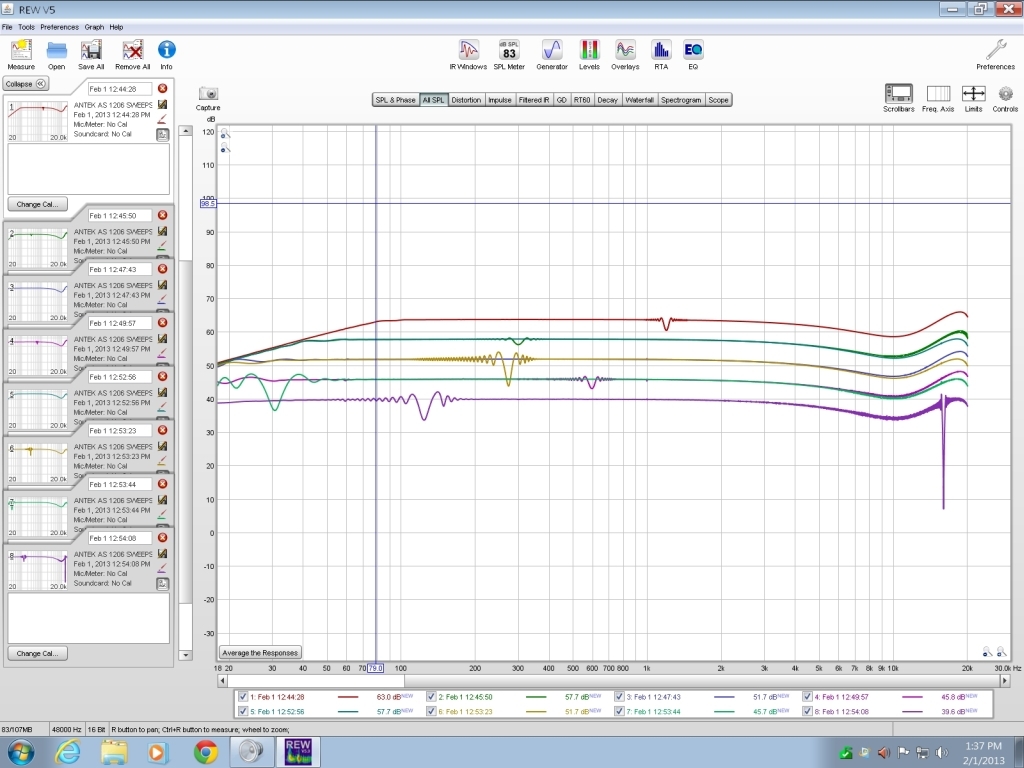

Please, if you would, help me determine what to do about my “step up” transformer problem. My goal is to end up with a frequency response of 320Hz to 21,000Hz (+/- 3db) on my Martin Logan panels (I have the bass already figured out so I only seek help with the panel).
I’m getting a sharp roll off above 8,000Hz such that it is about 36 db down at 16,000Hz. And 20,000Hz is nonexistent. It’s pretty flat all the up to 8,000Hz, then boom, it drops off. I would just like to see if there’s a way to configure the step-up transformers to give me a little more highs above 8,000Hz.
** Amplifier: I have 260 watts per channel (two channel stereo only) as follows; A solid state 200W per channel to the bass drivers below 320Hz plus a tube amp at 60W per channel to the electrostatic panels.
** Panels: The electrostatic panels are Martin Logan Monolith III built new by ML about 10 years ago as replacements.
** Transformers: I have step-up transformers that are EI type with a 1:50 ratio (one per panel). They weigh about 2.5 pounds is my ROUGH guess. They are used in the speakers of Roger Sanders. The voltage to the diaphragm is set at 3,500 VDC with the option to go up to 4,000 VDC. The wiring is as simple as you can imagine meaning that there are no passive x-overs thus the step-up transformer is directly wired from the tube amp to the stators using the 8 Ohm taps from the amp.
I realize that I might not ever get a flat response all the way up to 20,000 due to the curve of the panel and all the other reasons mentioned below ;-) . However, I think I’d be happy if the drop was less than 36 db at 16,000Hz…like maybe I’d be happy being down 24db or 18dB at 16KHz, FOR EXAMPLE.

I don't know about the transformer you are now using but I have measured a few different Toroid Power Transformers and the all have a pretty flat response that extends past the audio range.
However, as mentioned adding a very large Capacitance from a very large panel can have a different effect on the response as well due to the leakage inductance.
Here are a few measurements I did on a single Antek AN(s)-1206 found here,
A TEST JIG FOR FINDING ESL STEP-UP TRANSFORMER PARAMETERS
The dip you see at 10Khz or so was only there when the HV windings were tied in series.
The transformers that I have been using for the last 4 years don't so this at all.
The peak that you see is the peak of the resonance of the transformer it self as there is no added capacitance in these tests.
If you go to the link you will see some tests were the dip is less prominent and although I had not labeled the pictures with more detail, I believed the tests were done while HV winding's were either left open or connected in parallel as it makes no difference in that configuration.
I never did yet investigate more why the Antek's did this and the ones I use don't.

In the Second picture above,
It shows the difference of the Dip not being there in the Paralleled configuration of the HV winding and the response is flat, Sorry for the info box being in the way as I didn't notice this until after I had posted this picture.
The top black line is that of the signal and the next blue line is the response that is blocked by the info box
And the next blue line that has a down slope is the phase of the signal as it is coming directly out of the transformer as measured.
The third picture (as well as 1&4) show the response the the HV winding's in series.
In this configuration it Doubles the ratio and it also Doubles the transformers self capacitance too!!!
This causes 4x whamy on the impedance at the higher frequency's and was probably to much for my Crown DC300A to maintain the same voltage at that level of operation.
The Peak above 10Khz is the Peak that is caused by the transfomer's self capacitance and leakage inductance which was shifted down an octave due to the doubling of the capacitance of the winding's being connected in series.
If I had added any significant amount of added capacitance this effect would be even worse!!!
This is the main reason as to why I suggest to use 4 cores instead of using two cores to get the needed step up ratio.
You get better performance out of your amplifier for the most part.
By using 4 cores you get the same step up ratio but you also get an extended higher range becuase the resonance stays the same as that of a single core (I Think, although I do need to retest this to be 100% sure) and your overall impedance is higher as well before the added capacitance of the panel.
By doing it this way this keeps your peak much higher and gives you more room to work with when you are using larger panels that have much more capacitance.
The lower frequency's impedance's are higher as well due to the Primary's being in series and this also lower's your core's overall saturation point for a given voltage as well.
As the Secondary winding's on each of the core's are now in parallel with each other, this cuts the stray transformer capacitance in half compared to that of the series connected configuration with a single core, thus raising the impedance at the higher end as well before (and after of course) adding the panel capacitance.
