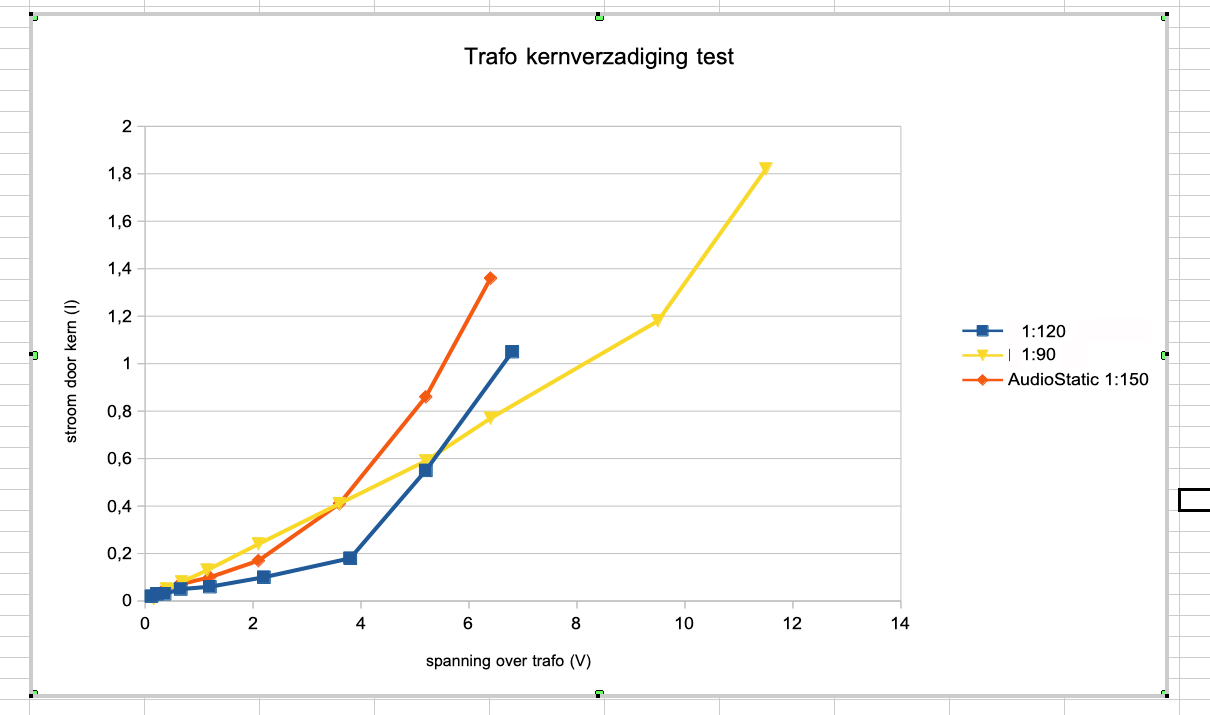

* a saturation comparison. I put a 2 ohms resistor in series with the transformer and measured voltage across the resistor in order to calculate current. Voltage across amplifier output on x-axis, current through transformer is on y-axis (I put a wrong label on the x-axis). I measured with a 10 Hz sine-wave.

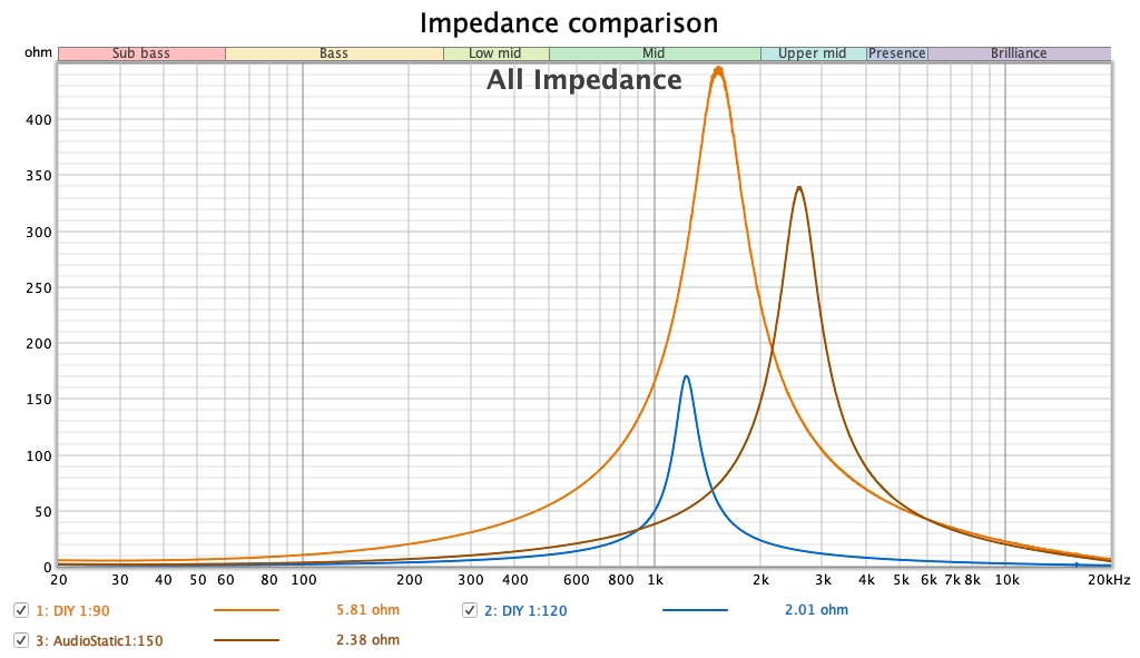

* an impedance comparison of the transformers (without load / esl)

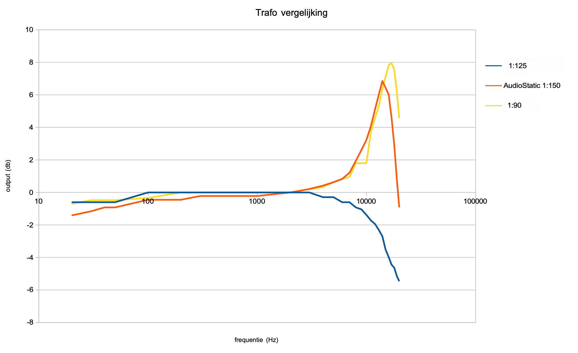

* an frequency response comparison of the transformers
It seems the 1:90 transformer has both the best (highest) impedance and the best saturation behaviour. The AudioStatic has the worst saturation behaviour. The 1:120 DIY has the worst hf frequency range and a promlematic impedance. So at the moment I prefer / use the 1:90 DIY transformer on my current stats.
The next step would be to make a circuit which turns on a LED when saturation current is reached just to check if the transformers do saturate when playing music.
