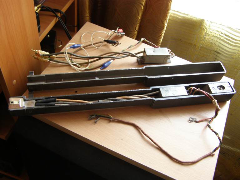

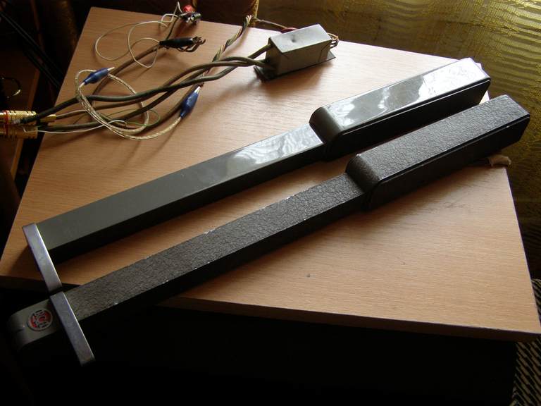

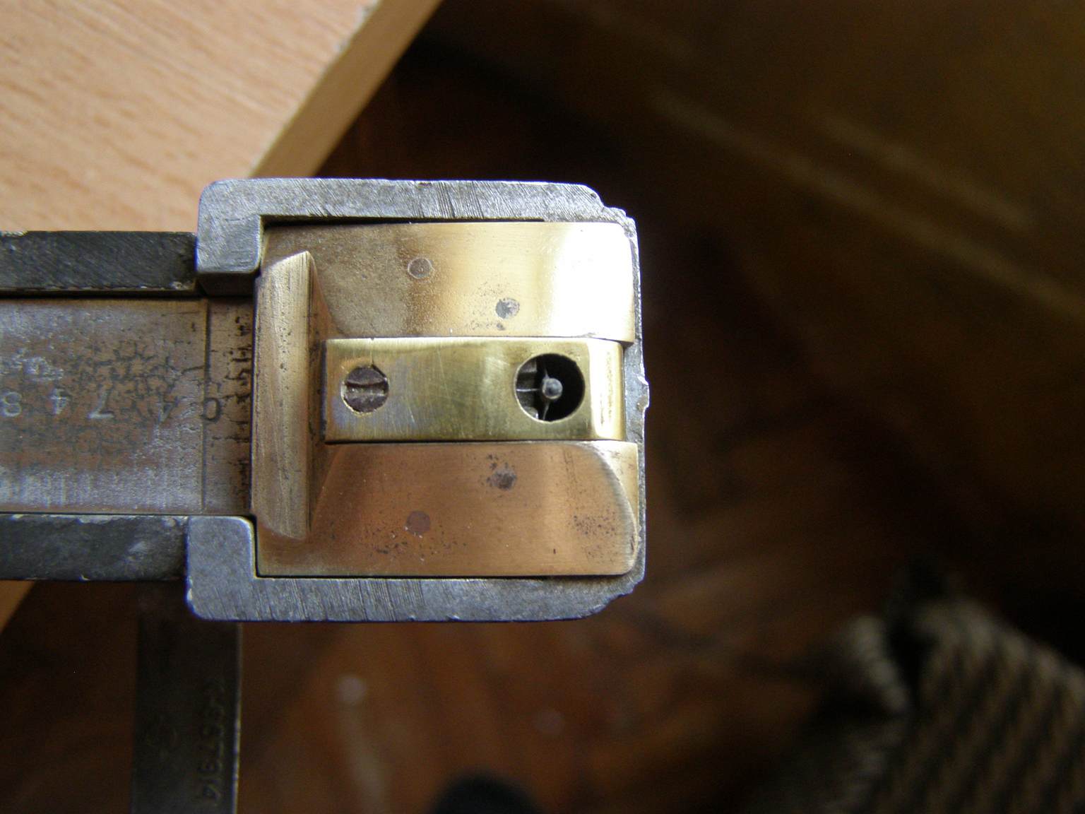

I somehow managed to have two of ancient RCA transcription tonearms together with proper moving ribbon cartridge and two transformers. Cartridge of no interest to me as it's tracking force is 25grams. However, transformer may work with ultra LOMC, because those are relatives with ribbon carts. With average LOMC it gives sound with no LF and too much of HF.
I suspect it may properly work with something like Ikeda, Neumann or AT ULOMC.

Great explanation. And what about ultra low output MC cartridges and proper transformers? Are they (transformers) different and not compatible with average LOMC?
