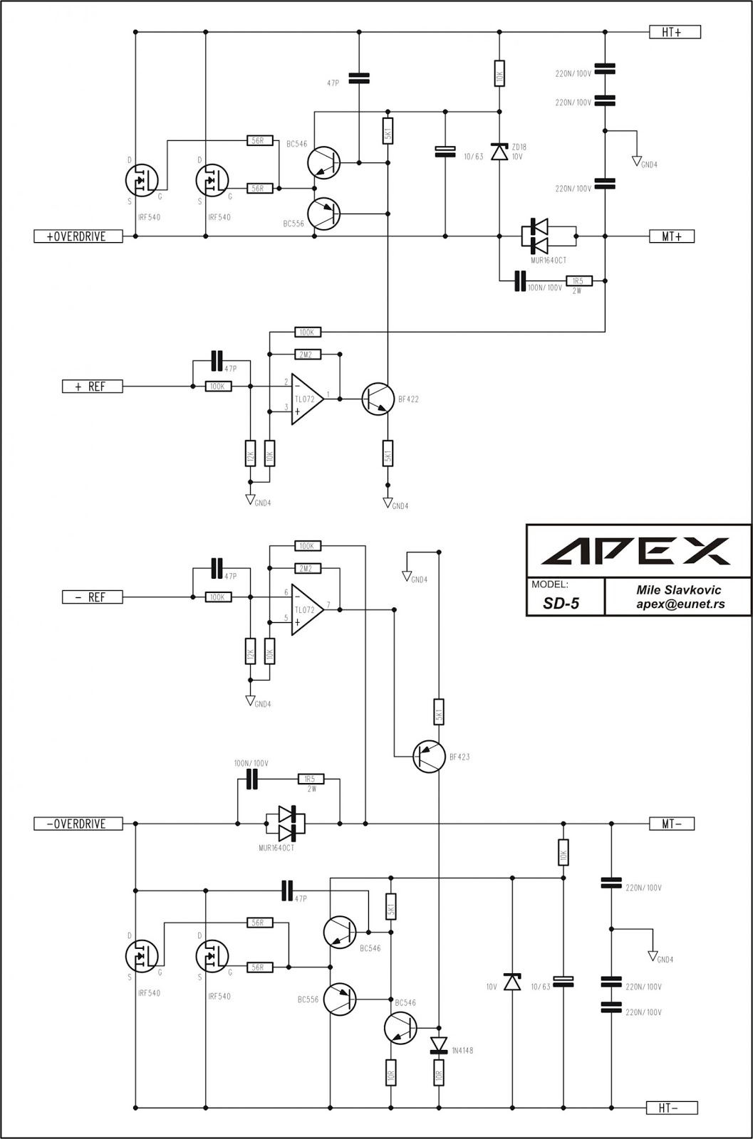

step driver SD-5
Hi apex
is this step driver are in working ? and can handle possible voltage around +140-+70-0 dc,SD-5
thank you.

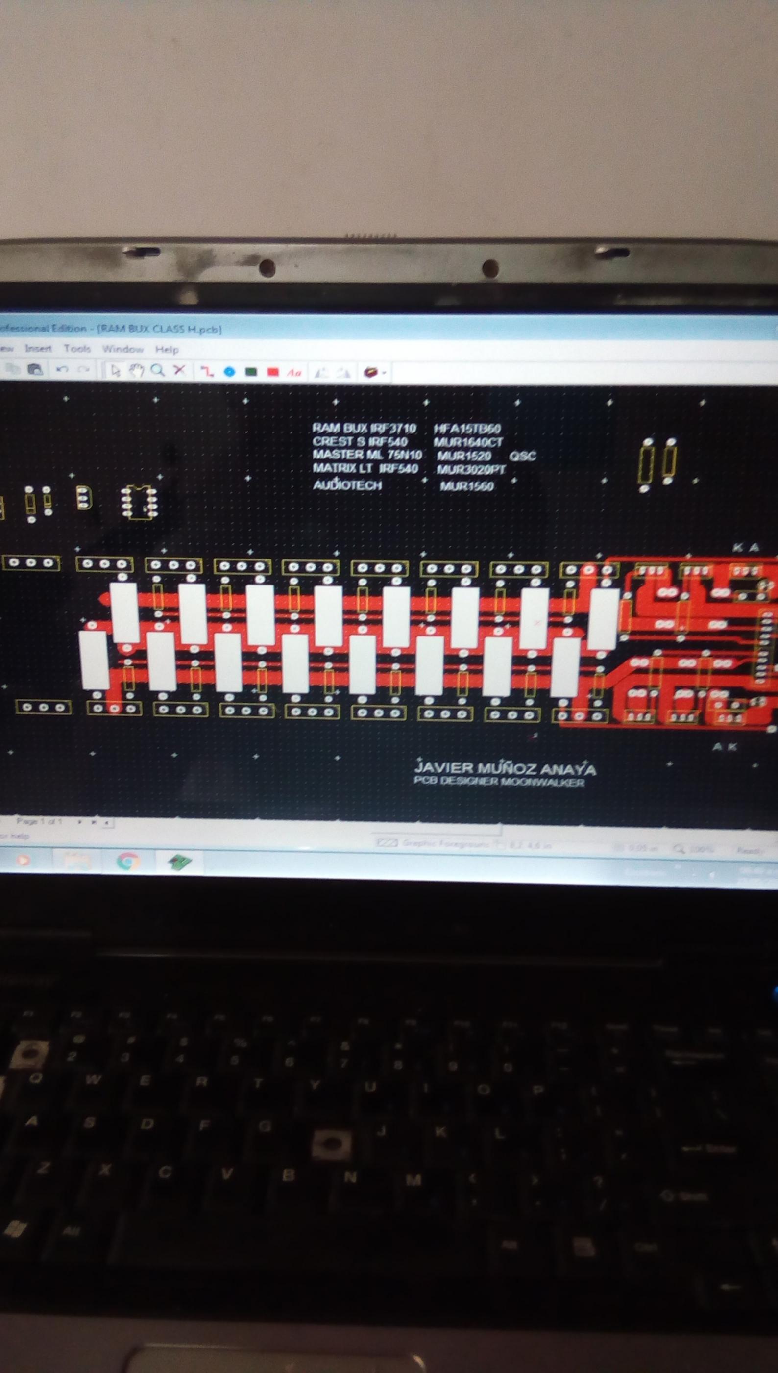

Hi guys.. PCB design in progress for class H Amplifier with SD-5 step driver. The amplifier is supposed to be supplied with +/-140V at High and +/-70V at low Voltage.
