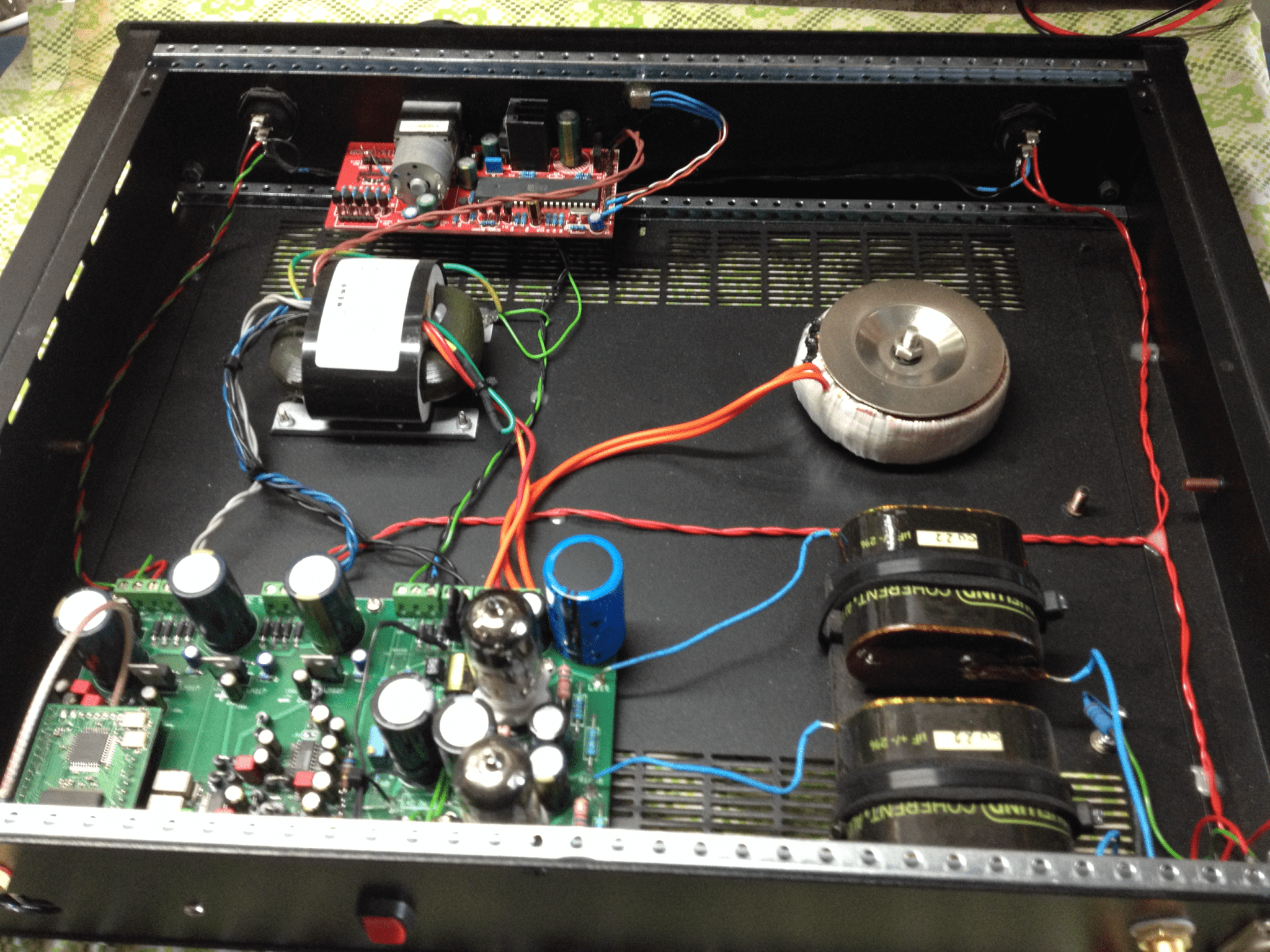

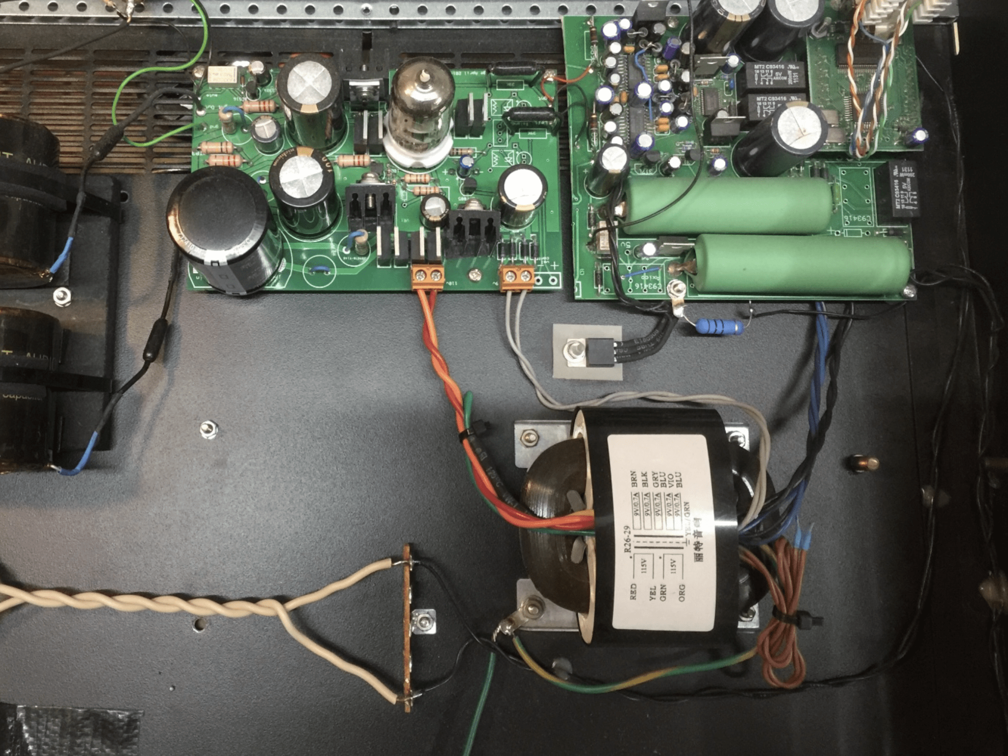

Years ago I used to manufacture a DAC with a tube based output stage.
I used a R-Core transformer in reverse & fed 16.5v from an alarm plug pak into one of the 9+9v CT secondary windings.
I then used all the R-Core outputs including the 115+115 primary to power the DAC.
I think I used to get about 200v out of the 115+115v primary which I used for HT.
It worked very well & was quite reliable.

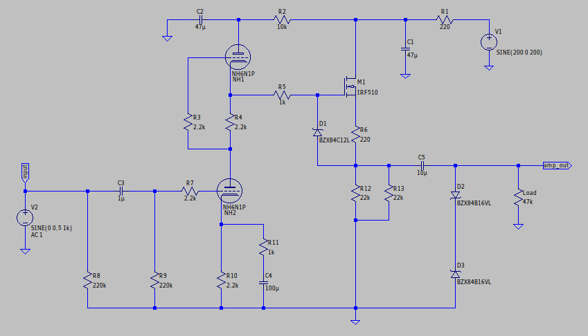

I'll get round to taking measurements in the next couple of days and see how much current headroom I get from my first 3A transformer and go from there.
In the mean time here is the circuit I plan on powering:
I will be adding a switch at R11 to control the gain, possible a potentiometer to gain match left and right channels as it is a feedback-less design.
Note that I will be using 6N2P tubes not 6N1P (I couldn't find splice models for it)

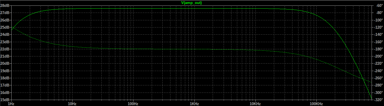

Thanks euro21!
The new model has a lot more gain than the other! (33.3db vs 24.7db).
Still good distortion levels at 0.5% for 18v p-p. all second harmonic of course!

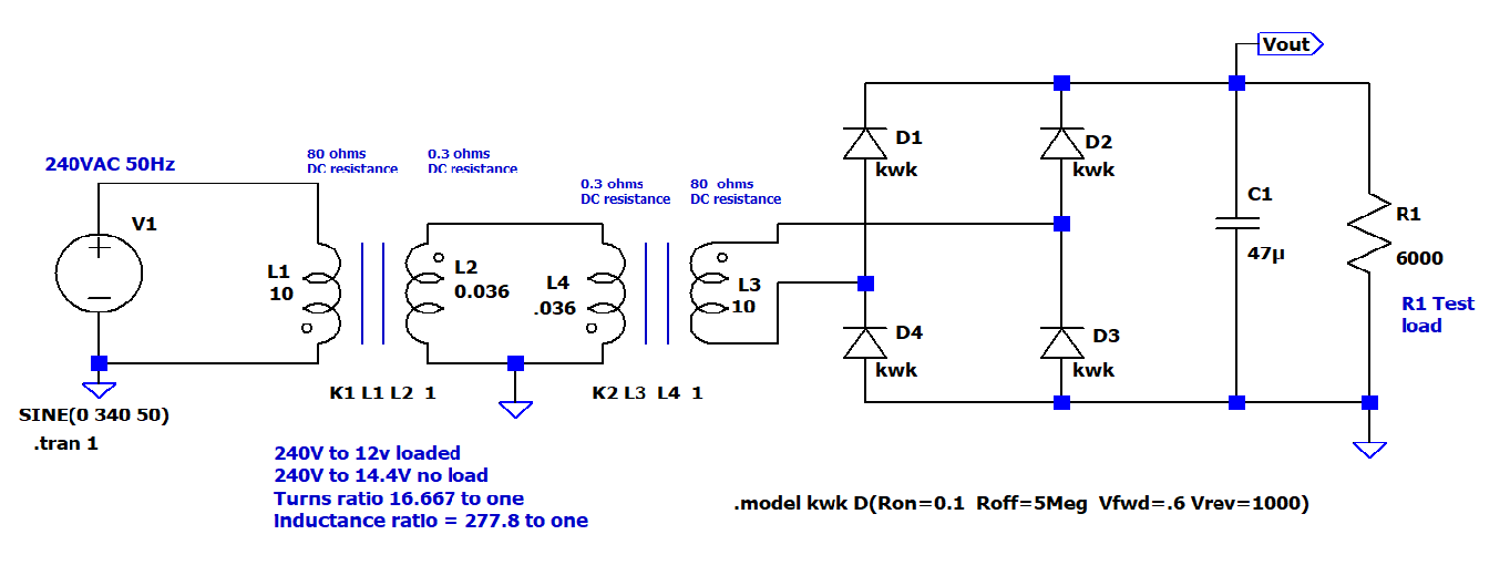

For a project I needed a PT with 200V AC at the secondary: I used a VPT230-110 (this is a 230V to 230V PT), with the secondary connected to the net. 230V to 230V is under load, unloaded it is rather 260V at the secondary, so the transformer is rather a step-up. Connecting the 260V to the mains gives about 200V AC at the primary. The transformer loses a bit of the VA, but for that it runs easier (less magnetization current).
Once I want to try the same with this transformer, https://www.mouser.ch/datasheet/2/410/VPS230_350-781627.pdf As it has less good regulation than the toroidals I expect that there will be around 180V AC at the primary when connecting the secondary to the mains.
From a safety point of view I see no problems, the isolation between primary and secondary works both ways.
Buffering a cathode follower (mu-follower) with a source follower seems a little unnecessary, no?In the mean time here is the circuit I plan on powering:
If you have such output tube, which requires significant amount of grid current (in A2 mode), CF or SF is necessary.
In every other case -relatively- low output impedance VAS stage is enough.
This project is just the preamp. I have built a MOSFET single ended class A output stage that needs the current to overcome the high input capacitance (high frequency roll-off).
I also plan to build different output stages to experiment with 🙂 probably heavily bias class AB next for more power.
The preamp will have multiple outputs (simple relay based) to easily switch and compere between them, or just for preference 😎
Maybe it's just me, but I'd rather use voltage multipliers than running transformers back-to-back. Just seems hokey to me.
I agree! I like to use what I have handy, so if there is some VA to spare from a low voltage filament supply and a small trafo available for some mA for a driver stage, lets go. But never buy new to do this. And indeed, do not be afraid of voltage multipliers.
