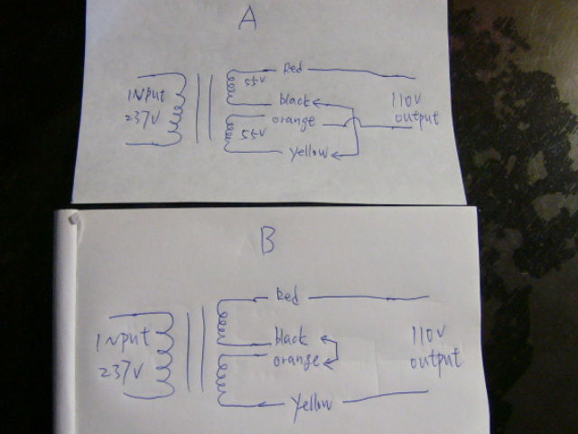

I tried wiring as you suggested in your diagram (note colours different to how you suggest as my transformer has different setup).
Orange (0V) + Black (0V) tied together
and
Yellow (55V) and red (55V) providing AC
Result was I only got about 18V reading over yellow and red 🙄
So it was fine as it was before, but the transformer inside the KingRex T20 PSU gets too hot.
I know I have a proper 240V PSU arriving soon, but it would still be nice to solve this little step down voltage problem.
