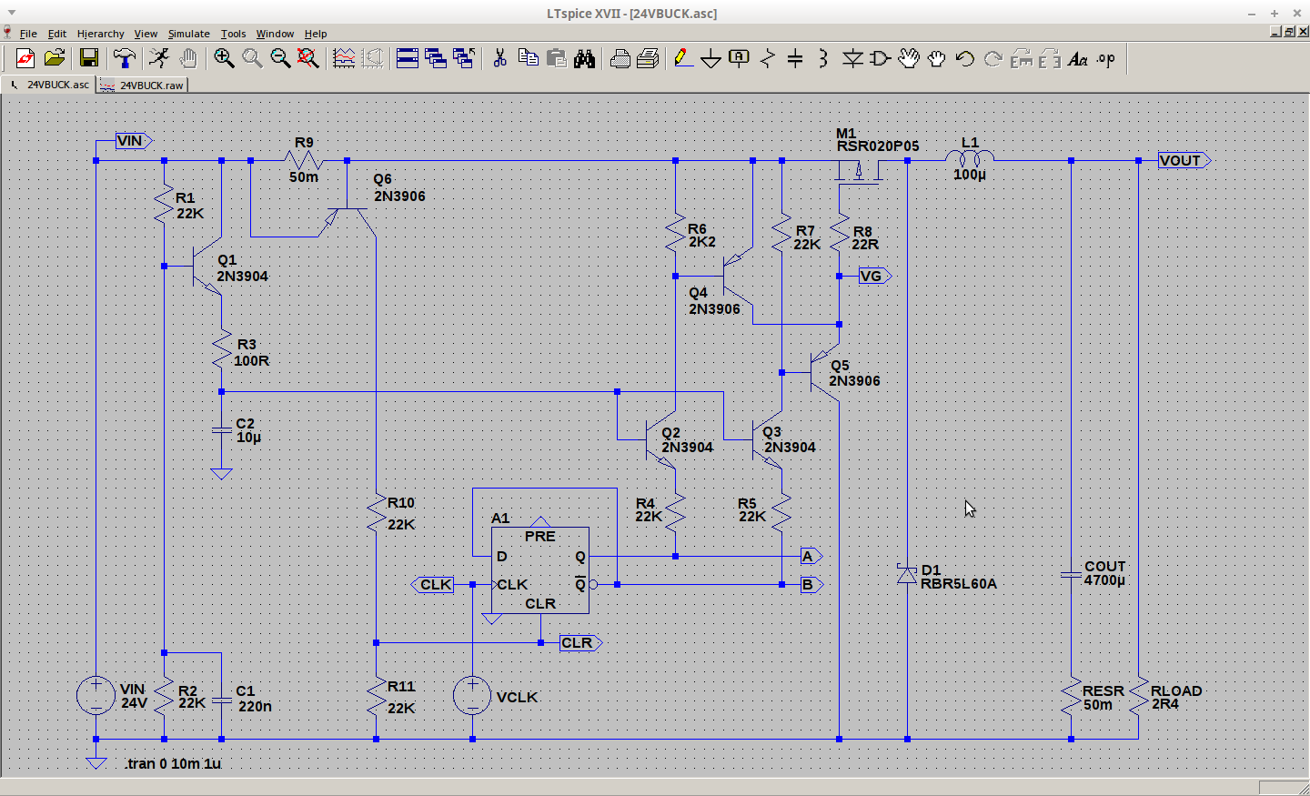

Anyway Omid wants to turn 24V into 12V so it looks like he needs a buck converter. The duty cycle will be,
D = VOUT/VIN = 12/24 = 0.5 or 50%
Let's assume the things that are going to be using something near to 12V.

A1 is a D type flip-flop, CD4013, and it divides CLK by two so A and B are 50% duty cycle signals. CLK comes from a CD4046. Level shift and stuff using small signal transistors.

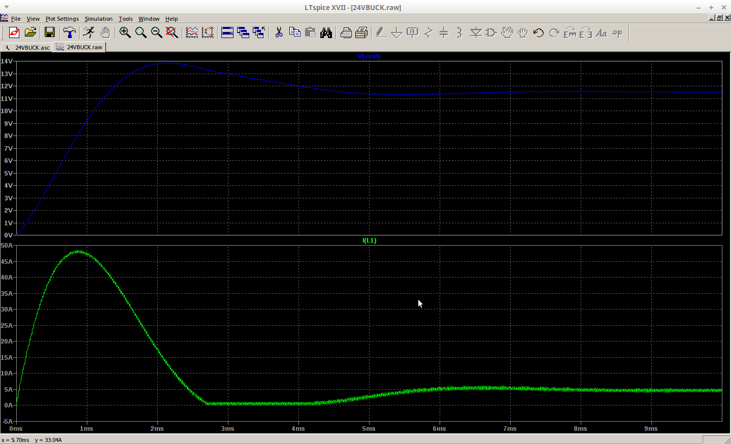

Circuit plus start up. It would seem we need a current limit and perhaps some other bits but there's about 12V out at 5A.

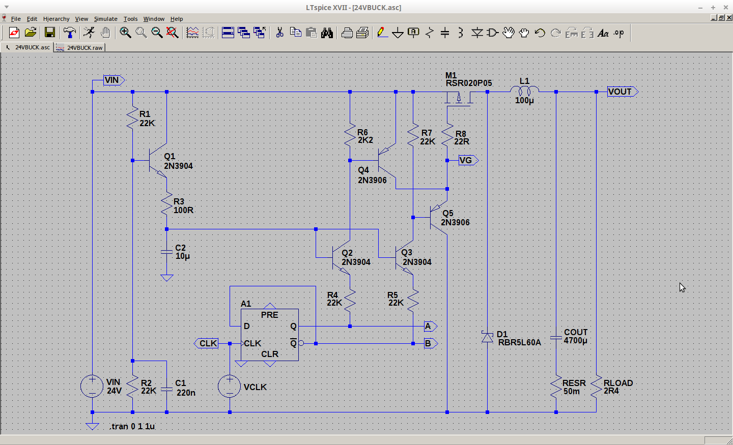

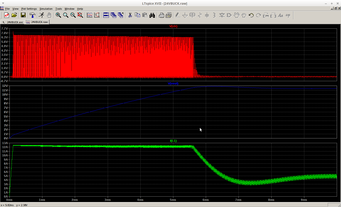

OK... so I mentioned a current limit might be in order. Adding some extra dirt and it is likely to be imprecise dirt.

WINDOW 3 37 50 Left 2
SYMATTR InstName R4
SYMATTR Value 22K
SYMBOL res 544 608 R180
WINDOW 0 57 71 Left 2
WINDOW 3 41 50 Left 2
SYMATTR InstName R5
SYMATTR Value 22K
SYMBOL pnp 560 368 M180
WINDOW 0 50 60 Left 2
WINDOW 3 47 35 Left 2
SYMATTR InstName Q5
SYMATTR Value 2N3906
SYMBOL res 608 32 R0
WINDOW 0 39 54 Left 2
SYMATTR InstName R8
SYMATTR Value 22R
SYMBOL res 512 32 R0
WINDOW 0 40 52 Left 2
SYMATTR InstName R7
SYMATTR Value 22K
SYMBOL pnp 416 208 M180
WINDOW 0 -41 21 Left 2
WINDOW 3 -42 -7 Left 2
SYMATTR InstName Q4
SYMBOL res 336 32 R0
WINDOW 0 37 50 Left 2
WINDOW 3 38 71 Left 2
SYMATTR InstName R6
SYMATTR Value 2K2
SYMBOL npn -464 96 R0
WINDOW 0 57 37 Left 2
WINDOW 3 56 64 Left 2
SYMATTR InstName Q1
SYMATTR Value 2N3904
SYMBOL res -512 -16 R0
WINDOW 0 36 47 Left 2
WINDOW 3 37 72 Left 2
SYMATTR InstName R1
SYMATTR Value 22K
SYMBOL res -512 800 R0
WINDOW 0 41 47 Left 2
WINDOW 3 41 68 Left 2
SYMATTR InstName R2
SYMATTR Value 22K
SYMBOL cap -416 832 R0
WINDOW 0 40 15 Left 2
WINDOW 3 44 42 Left 2
SYMATTR InstName C1
SYMATTR Value 220n
SYMBOL voltage 16 800 R0
WINDOW 0 40 59 Left 2
WINDOW 3 24 96 Invisible 2
WINDOW 123 0 0 Left 2
WINDOW 39 0 0 Left 2
SYMATTR InstName VCLK
SYMATTR Value PULSE(0 12 0 100n 100n 5u 10u)
SYMBOL ind 784 -16 R270
WINDOW 0 32 56 VTop 2
WINDOW 3 5 56 VBottom 2
SYMATTR InstName L1
SYMATTR Value 100µ
SYMBOL schottky 752 688 R180
WINDOW 0 -41 41 Left 2
WINDOW 3 -134 18 Left 2
SYMATTR InstName D1
SYMATTR Value RBR5L60A
SYMATTR Description Diode
SYMATTR Type diode
SYMBOL voltage -608 800 R0
WINDOW 0 40 45 Left 2
SYMATTR InstName VIN
SYMATTR Value 24V
SYMBOL cap 992 624 R0
WINDOW 0 38 17 Left 2
WINDOW 3 39 40 Left 2
SYMATTR InstName COUT
SYMATTR Value 4700µ
SYMBOL res 992 800 R0
WINDOW 0 35 47 Left 2
WINDOW 3 37 70 Left 2
SYMATTR InstName RESR
SYMATTR Value 50m
SYMBOL res 1104 800 R0
WINDOW 0 37 47 Left 2
WINDOW 3 38 69 Left 2
SYMATTR InstName RLOAD
SYMATTR Value 2R4
SYMBOL res -416 224 R0
WINDOW 0 43 49 Left 2
SYMATTR InstName R3
SYMATTR Value 100R
SYMBOL cap -416 384 R0
WINDOW 0 40 21 Left 2
WINDOW 3 41 43 Left 2
SYMATTR InstName C2
SYMATTR Value 10µ
SYMBOL res -208 -48 R90
WINDOW 0 0 56 VBottom 2
WINDOW 3 32 56 VTop 2
SYMATTR InstName R9
SYMATTR Value 50m
SYMBOL pnp -144 32 R90
WINDOW 0 -33 -27 VRight 2
WINDOW 3 -4 -83 VRight 2
SYMATTR InstName Q6
SYMBOL res -160 496 R0
SYMATTR InstName R10
SYMATTR Value 22K
SYMBOL res -160 800 R0
SYMATTR InstName R11
SYMATTR Value 22K
TEXT -560 968 Left 2 !.tran 0 10m 1u
12A limit start up.
  • Screenshot at 2017-12-16 19:39:06.png
  • Screenshot at 2017-12-16 19:37:30.png
