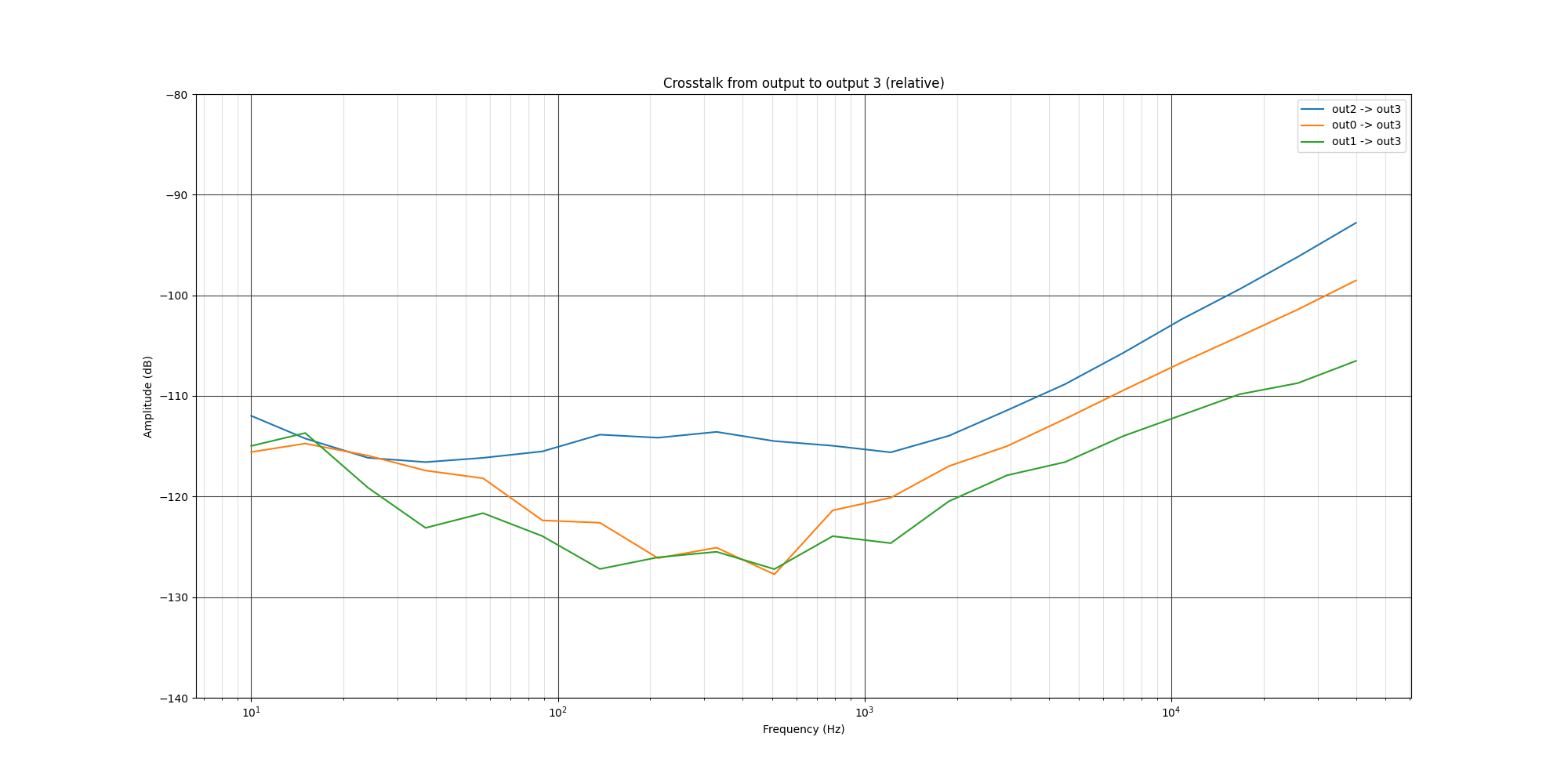

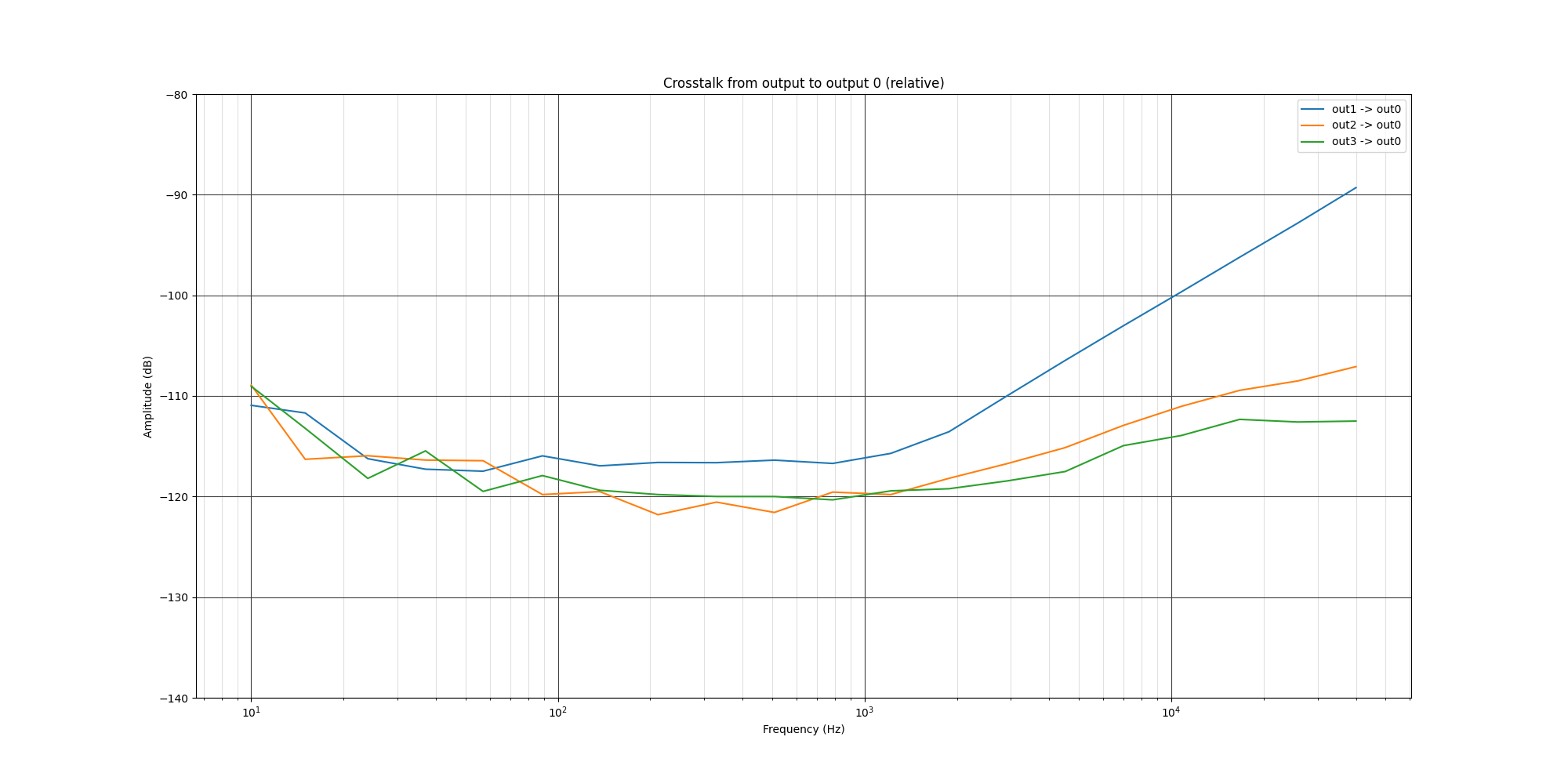

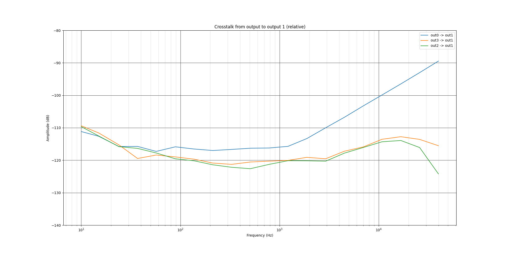

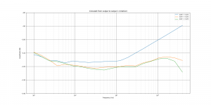

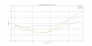

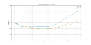

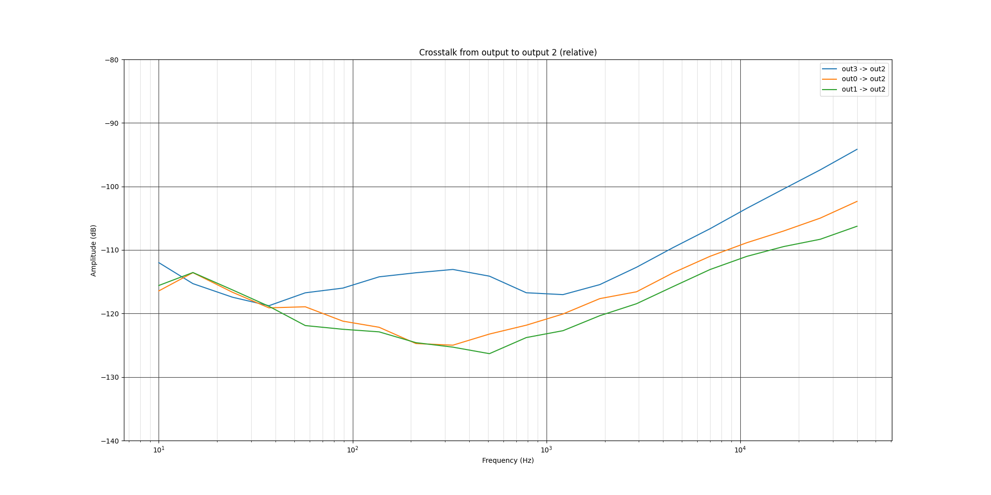

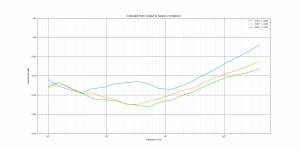

Output to output crosstalk
To measure the output impedance and PSRR of a LDO we need to inject a signal in the input, then in the output. My old E-MU 0202 was always so generous to include a sizeable chunk of one channel into the other output channel, which had to be calibrated out, but this Steinberg is much better behaved.
Note the graphs show hardware channel numbers, for the back panel output jacks:
out0 is 1L
out1 is 1R
out2 is 2L
out3 is 2R
There is more crosstalk between L and R than between channels 1 and 2, so if you want 2 outputs with minimum crosstalk, you should use 1L and 2R, for example. Also the top channels (geographically speaking) are on a daughterboard, so there is a bit more crosstalk between 1L and 2L than 1L and 2R, or 1R and 2L.
Anyway, the absence of volume control is pretty nice, that's one less thing to calibrate out, since the relationship between output volts and sample value is fixed.

Thanks for the review. Will you be publishing Analog I/O performance at some point?
That balanced output is worth a chuckle and a blush. Someone didn't do their job properly.
Any specific reason you picked the UR44 over the ID14 (for example)?
Edit: Ignore the first line, I see you're on it.

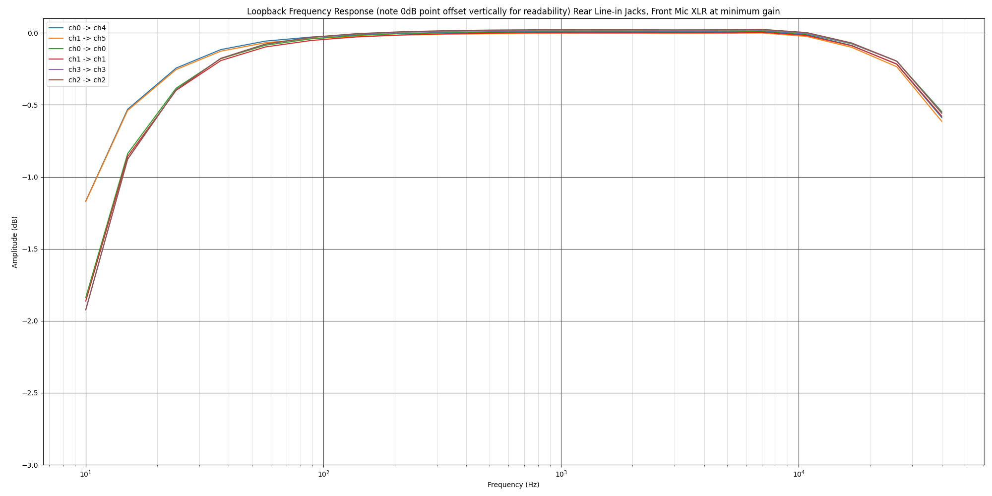

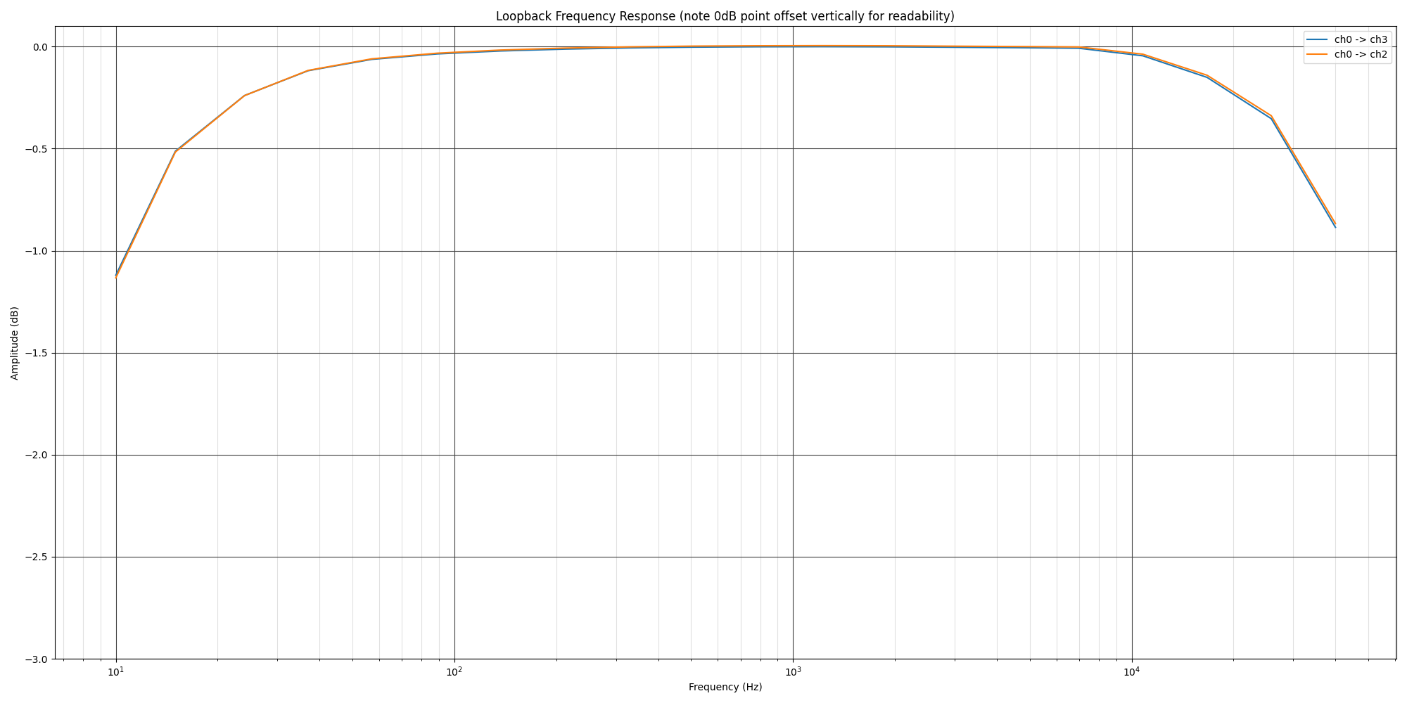

Loopback frequency response
See graphs. Note hardware channel numbers are 0-based.
Rear line inputs and XLR mic inputs have the best extension, -0.5dB at 40kHz when using 192ksps.
Loopback frequency response, inputs Rear Line-in Jacks, Front Mic XLR at minimum gain.png
Front line inputs are -1dB down at 40kHz.
So, very usable, no problem here.

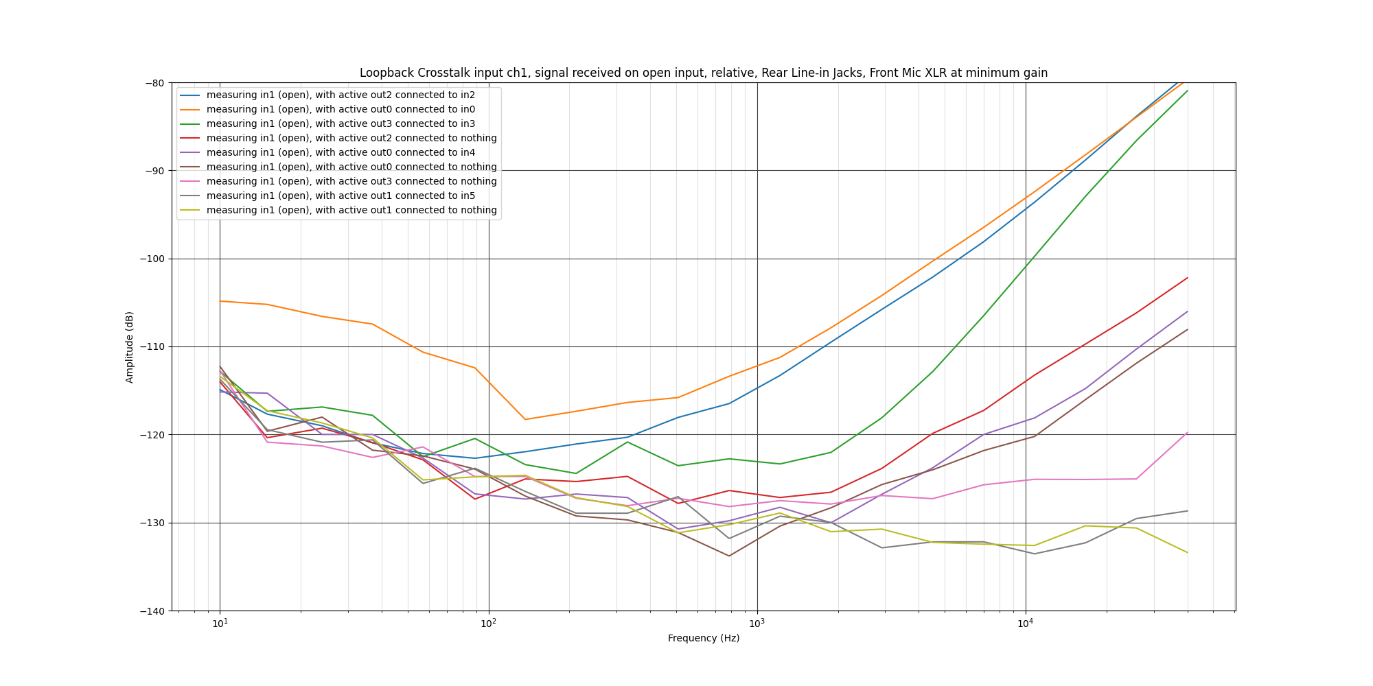

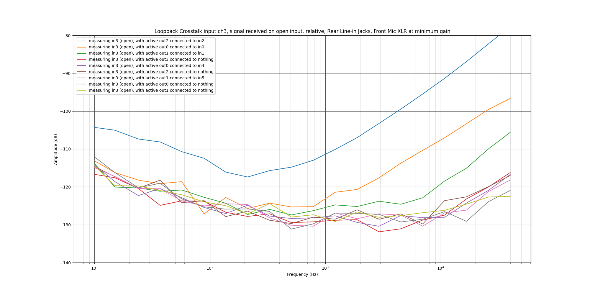

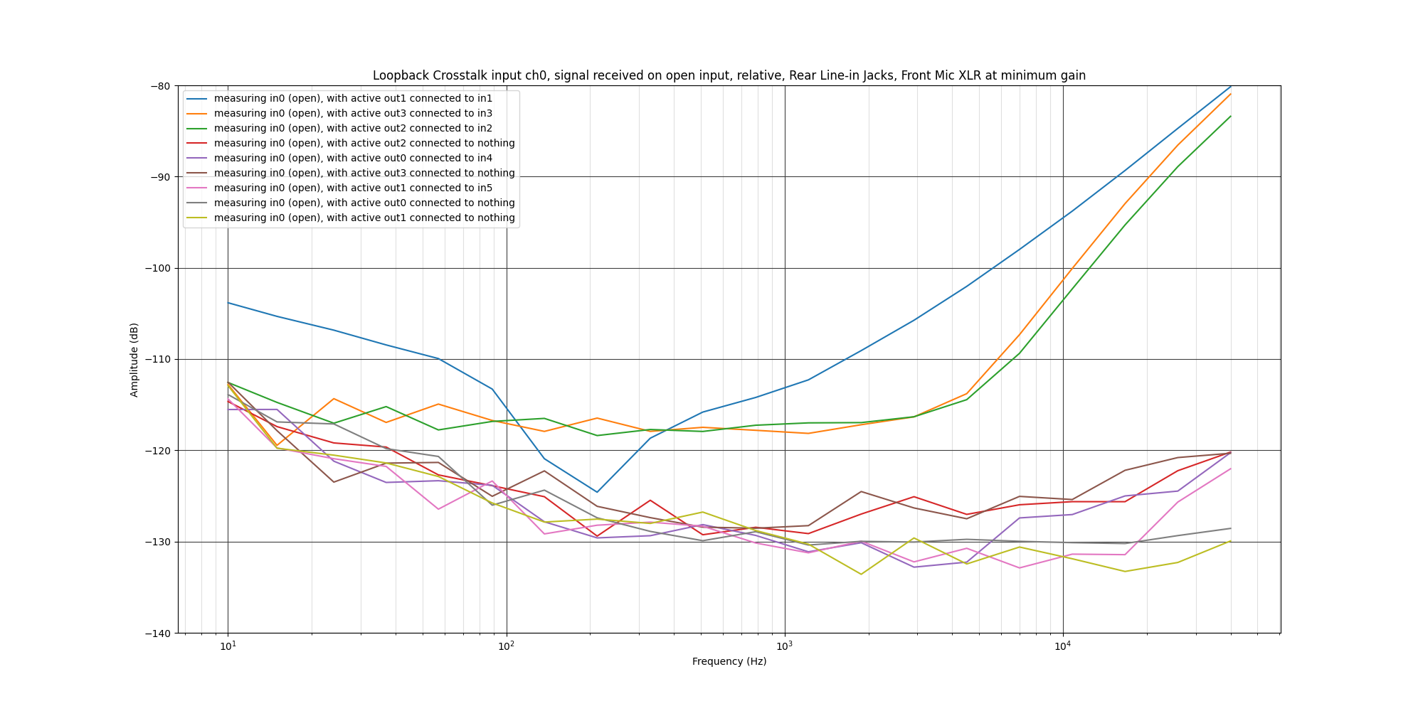

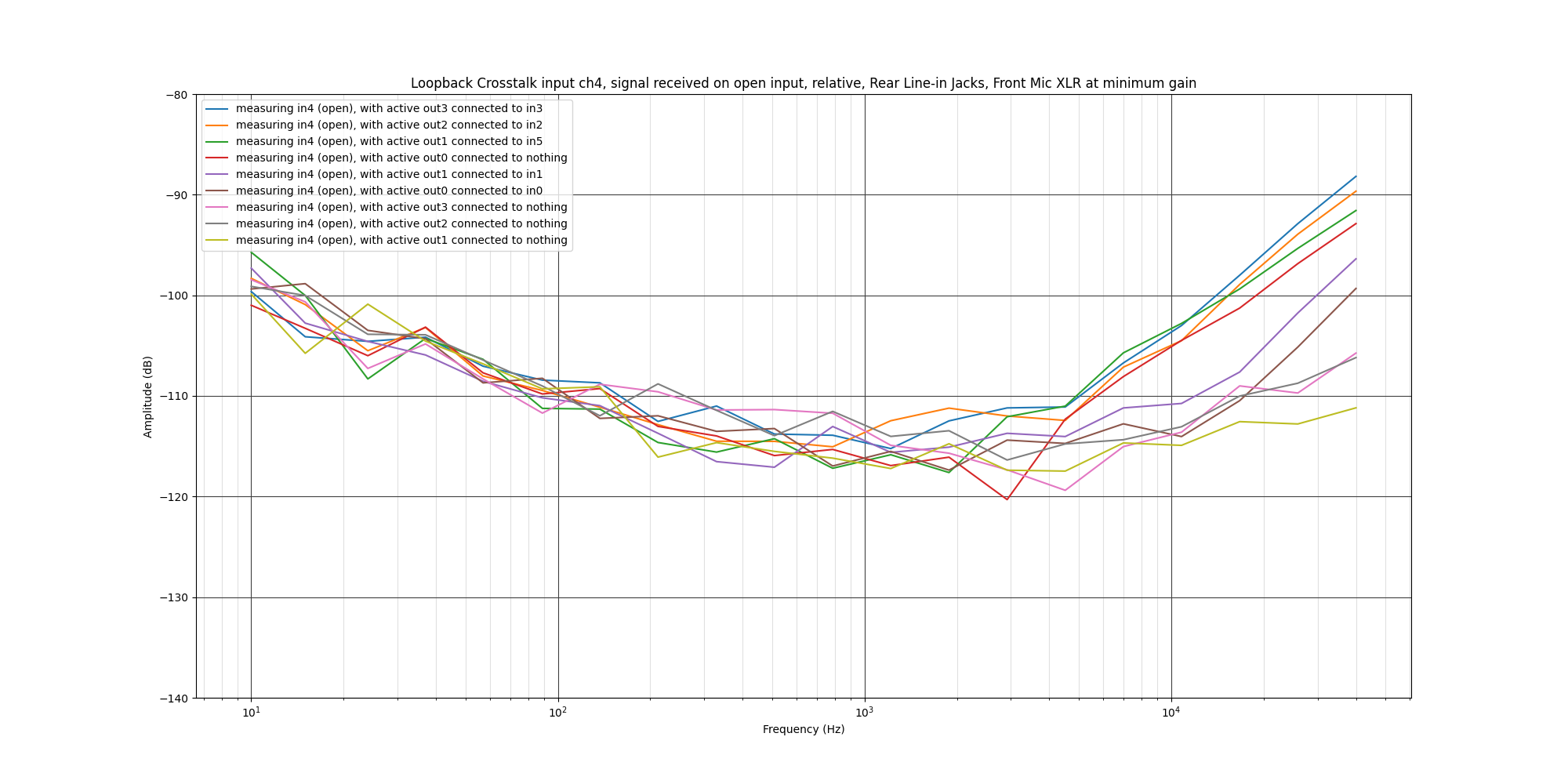

Input crosstalk
In order to measure things, like LDOs or filters, this also has to be accounted for, since you want to measure both the input (for calibration) and output (for measurement) of the device under test, too much crosstalk in the soundcard screws things up.
The rear line inputs have little crosstalk with anything, especially the front inputs.
UR44C loopback crosstalk in4 relative fRear Line-in Jacks, Front Mic XLR at minimum gain.png

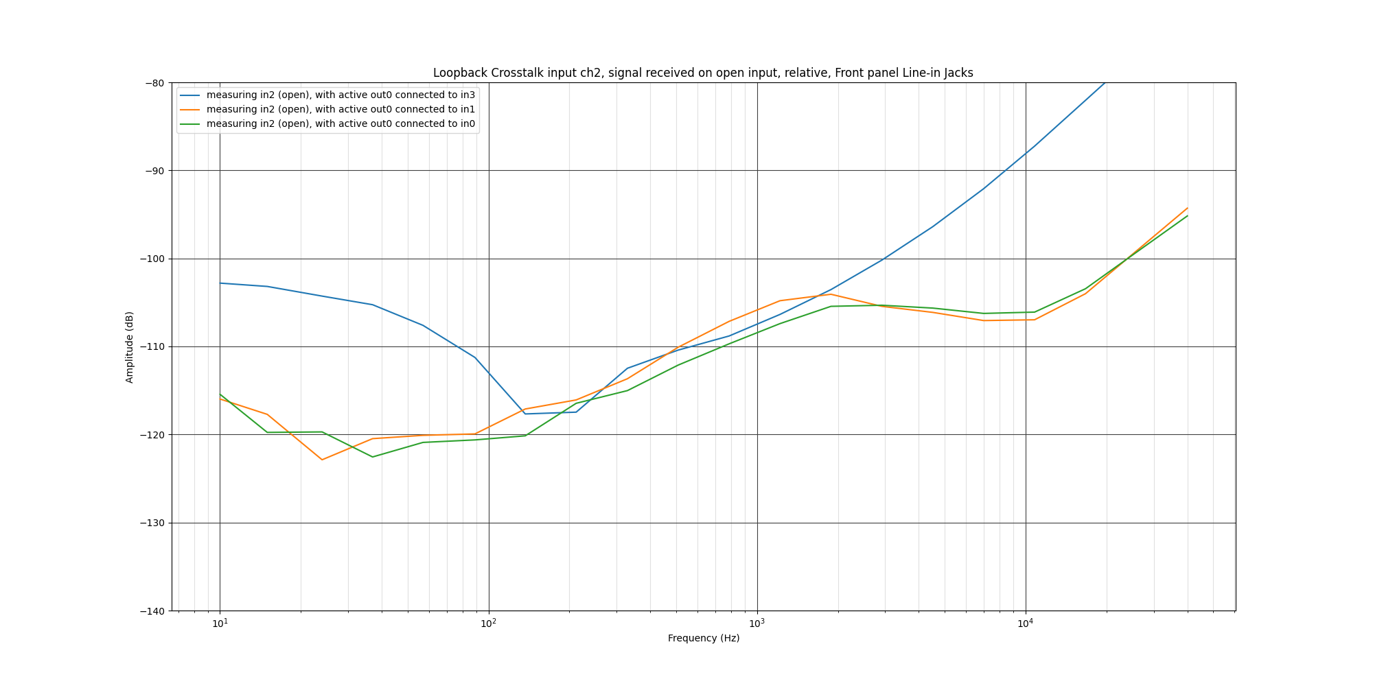

The two front line inputs have quite a bit of crosstalk between each other, but not with the back line inputs.

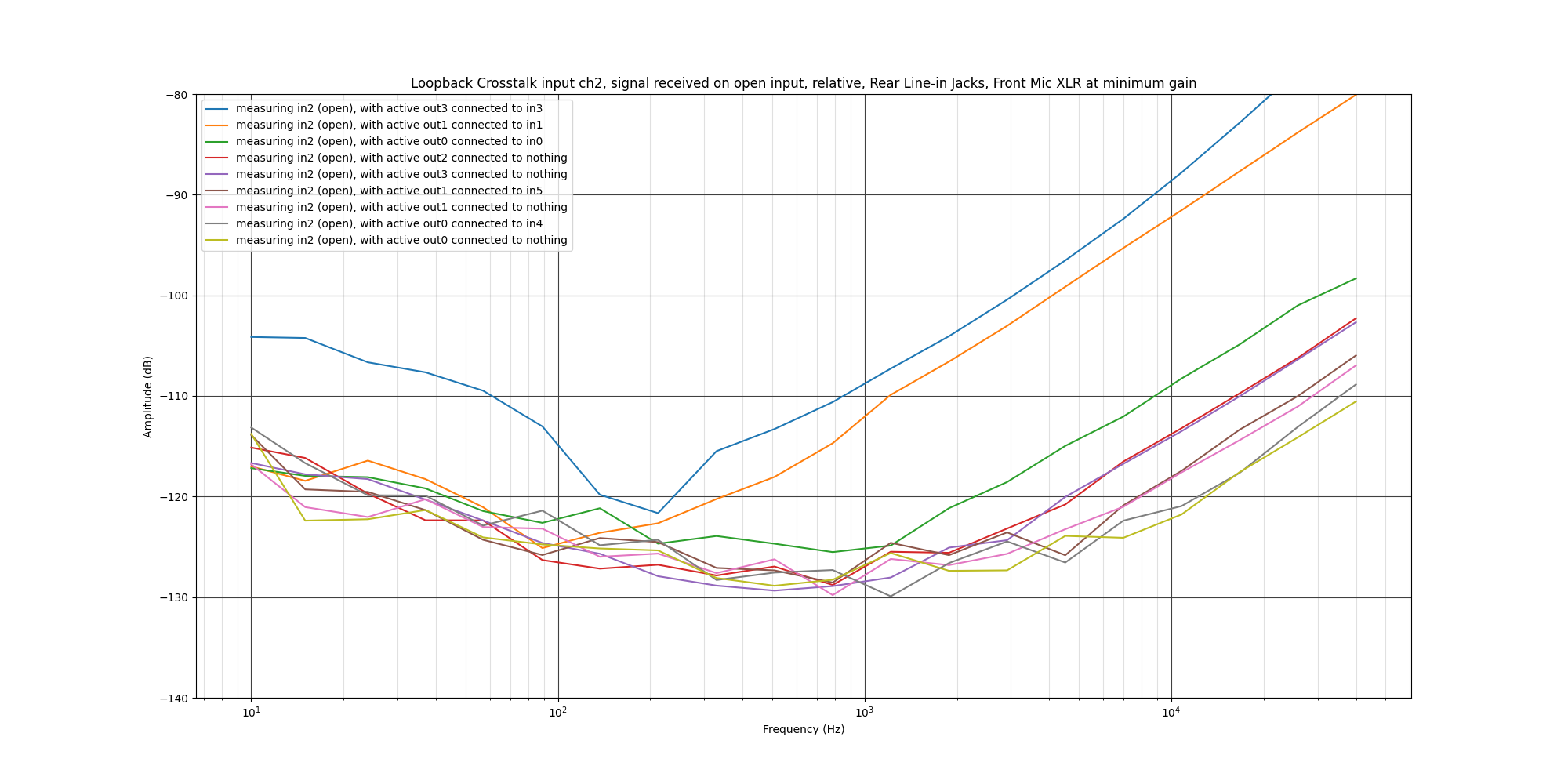

The four front XLR inputs have an embarrasingly high amount of crosstalk between each other, though.
UR44C loopback crosstalk in0 relative fRear Line-in Jacks, Front Mic XLR at minimum gain.png
UR44C loopback crosstalk in1 relative fRear Line-in Jacks, Front Mic XLR at minimum gain.png
UR44C loopback crosstalk in2 relative fRear Line-in Jacks, Front Mic XLR at minimum gain.png
UR44C loopback crosstalk in3 relative fRear Line-in Jacks, Front Mic XLR at minimum gain.png
So, if low input crosstalk is necessary, this soundcard really has three inputs: two on the back, and one of the line jacks on the front. That's useful to know, which is why I did this test.
But, well, below 10kHz, the rest of the inputs aren't that bad.

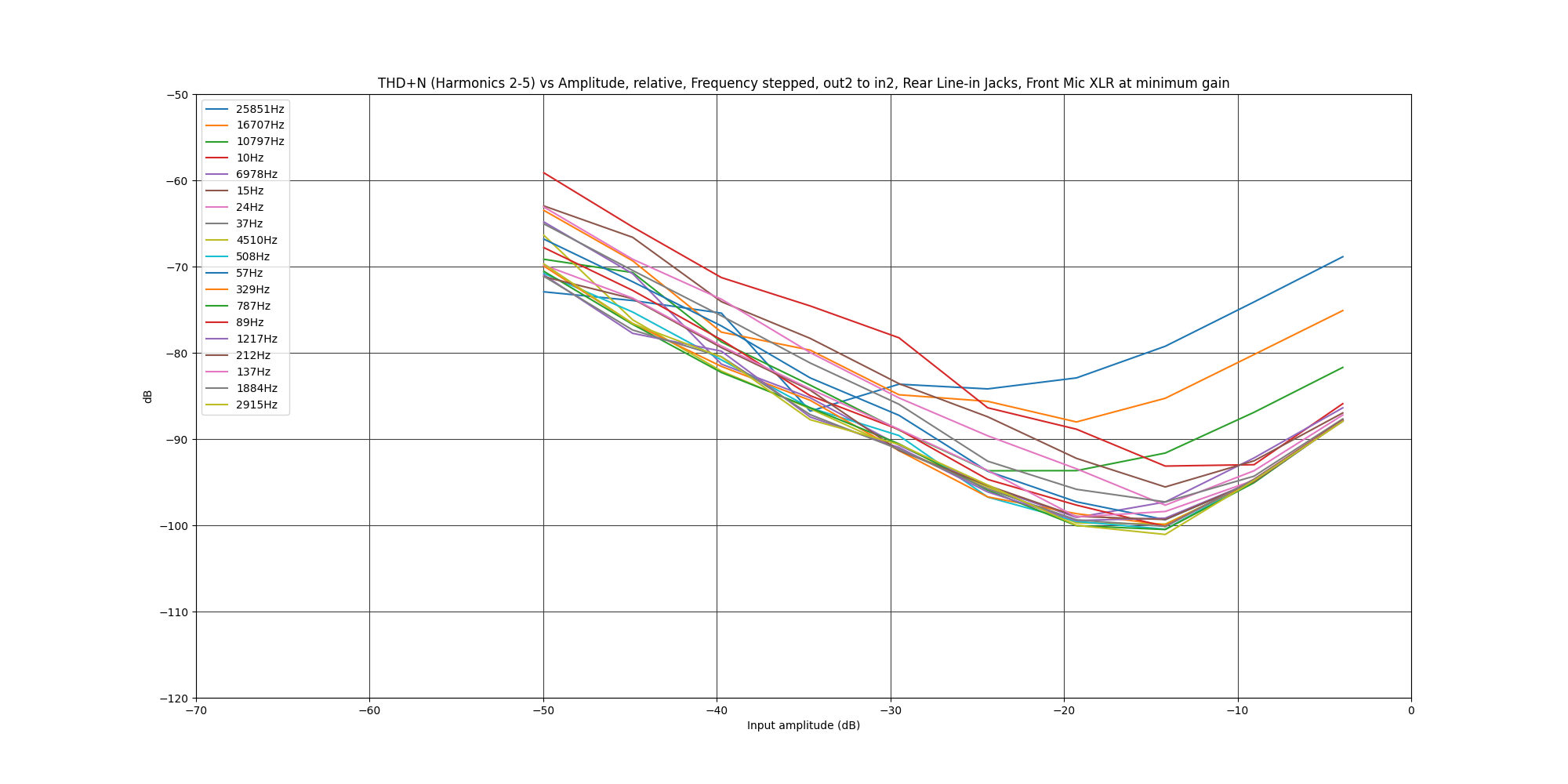

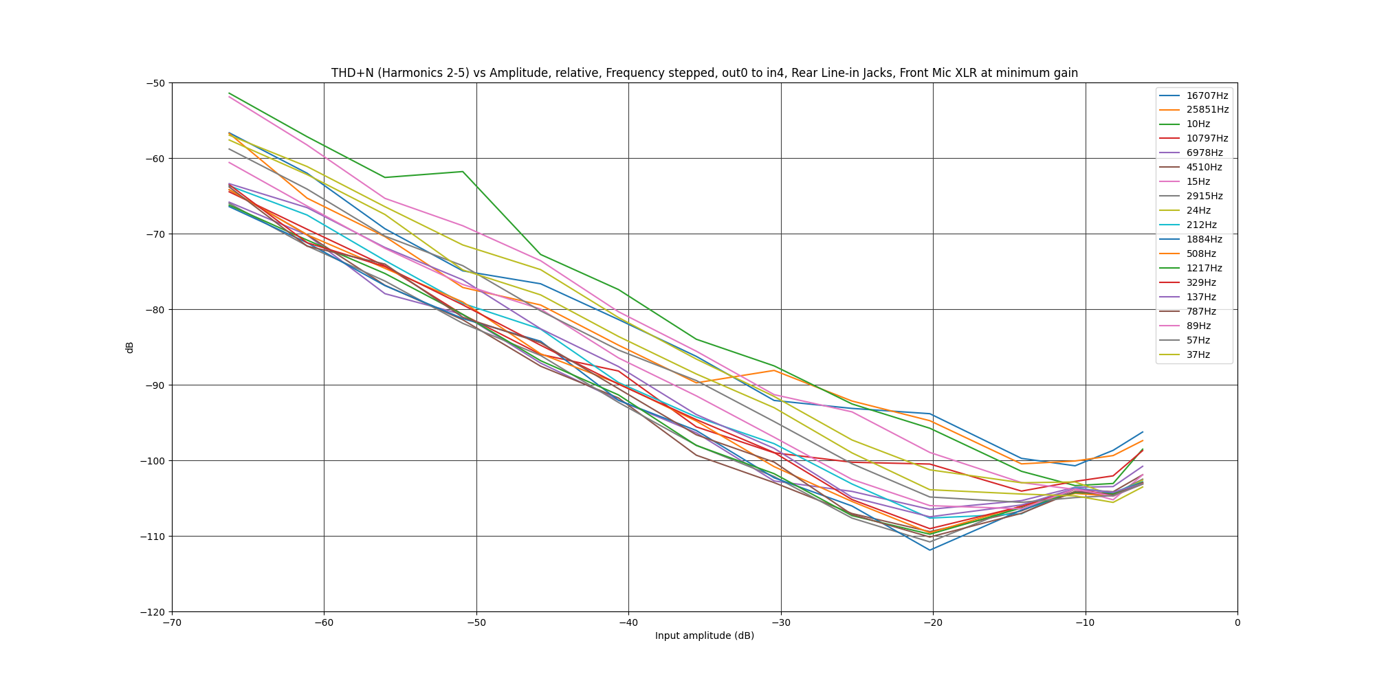

Distortion
All the line outputs are identical. The inputs, however, are not.

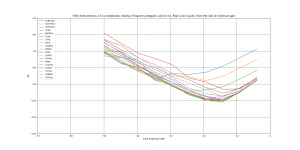

Rear line inputs and outputs are powered by timeless audiophile standard NE5532, so they deliver a pretty honest performance in loopback.
THD+N (Harmonics 2-5) vs Amplitude, relative, Frequency stepped, out0 to in4, Rear Line-in Jacks.png

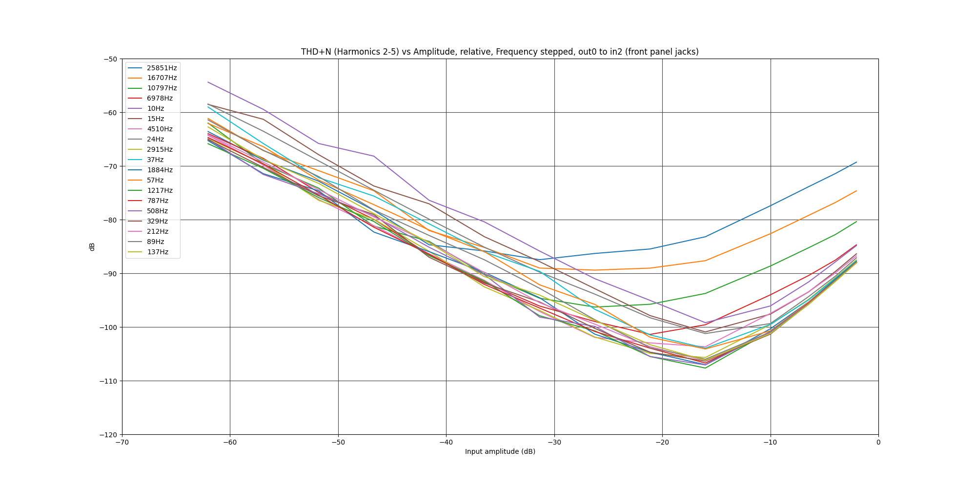

Front XLR mic inputs however, contain a JRC knockoff of the TL072, and it shows.
THD+N (Harmonics 2-5) vs Amplitude, relative, Frequency stepped, out2 to in2, Rear Line-in Jacks.png
And the two front jack line inputs run on the same circuit, including the accursed 072.
THD+N (Harmonics 2-5) vs Amplitude, relative, Frequency stepped, out0 to in2 (front panel jacks).png
I'm not exactly sure of the amplitude calibration in these graphs, but well, the take-home point is, if you want to measure distortion, it is wise to stay away from the inputs that have a TL072 in the signal path. The rise in THD at high frequency is truly spectacular.

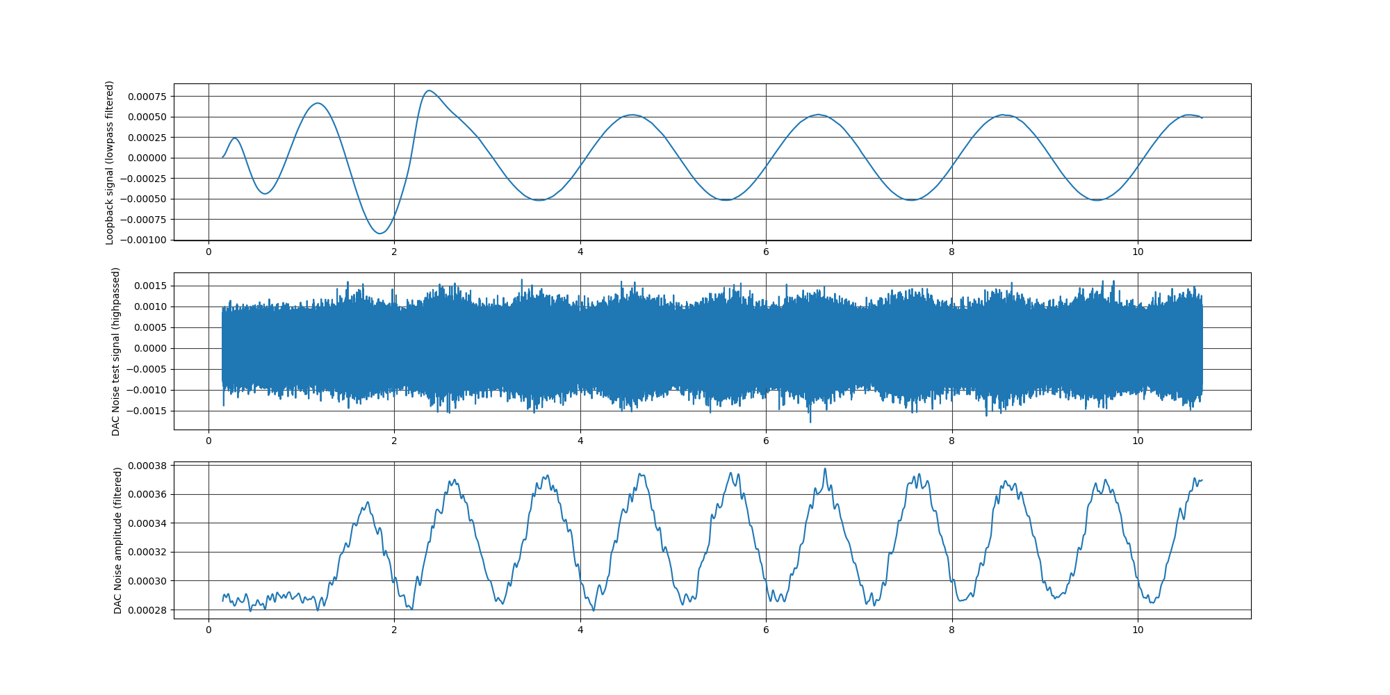

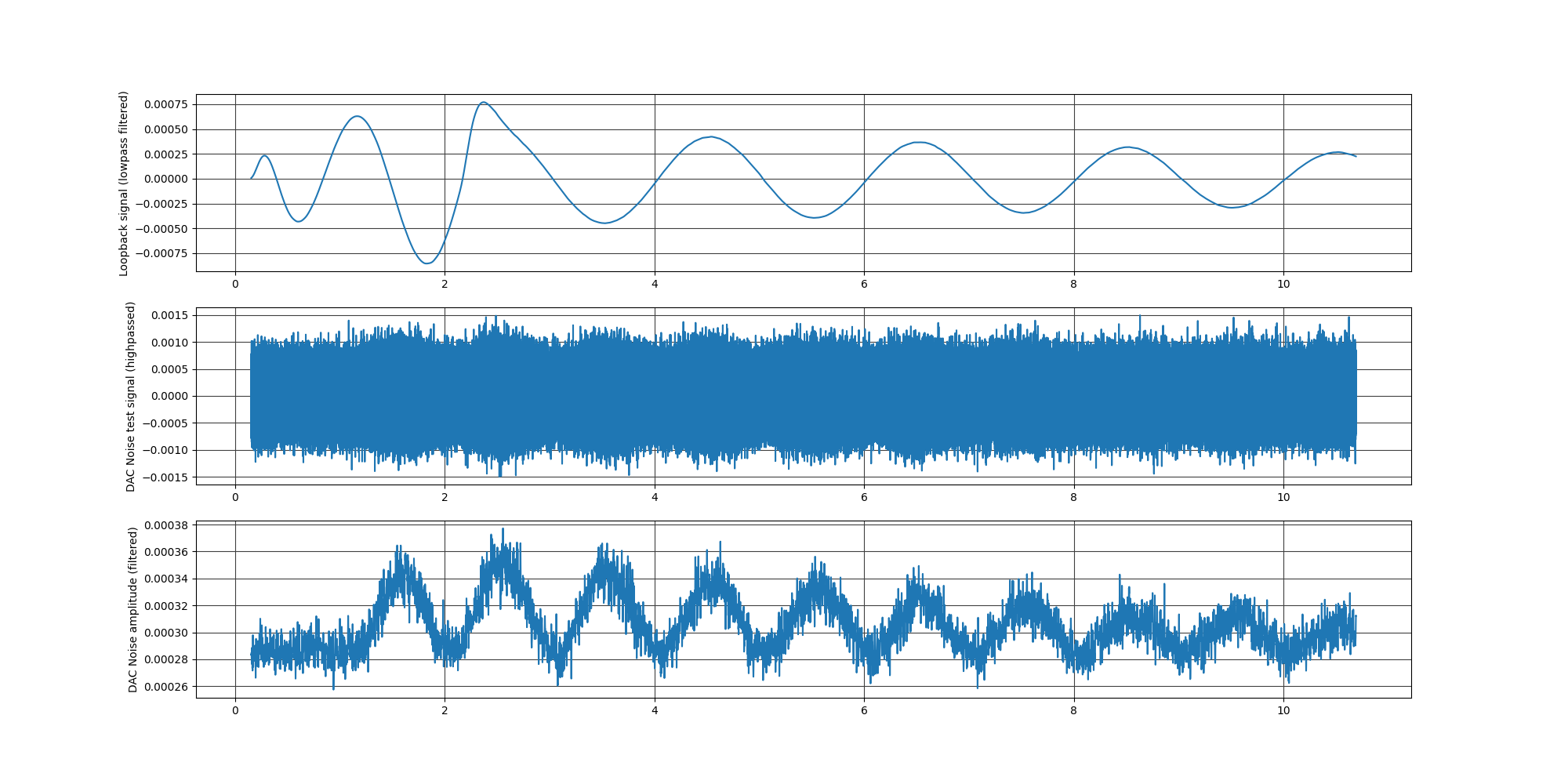

Noise modulation
Now of course the next thing to measure on a sigma delta DAC is how it modulates the noise according to signal amplitude.
DAC output plays a 0.5 Hz sine wave, which goes into a RC highpass filter to get rid of the signal as much as possible, which is then fed into one of the mic inputs. This is the curve on top. It looks a bit wonky at the beginning, I think I screwed-up the ramp-up in software, but that doesn't matter. Amplitude is very low, due to the output coupling cap and the RC filter removing most of the 0.5Hz signal.
The mic preamps have pretty low noise, so they should mostly let us see the noise from the DAC (middle trace).
Then, the signal is filtered in software to keep only the noise, and its RMS amplitude extracted and smoothed (bottom trace). This does not give the absolute value of the noise power/amplitude, but how it varies.

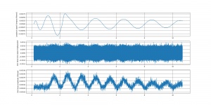

So, this DAC (and associated output circuitry) has 35% more noise at full scale than at zero output. Noise is quite proportional to signal absolute value, and it doesn't seem to be doing anything funny. Using a higher cutoff frequency on the noise amplitude detector doesn't reveal any gremlins either.
