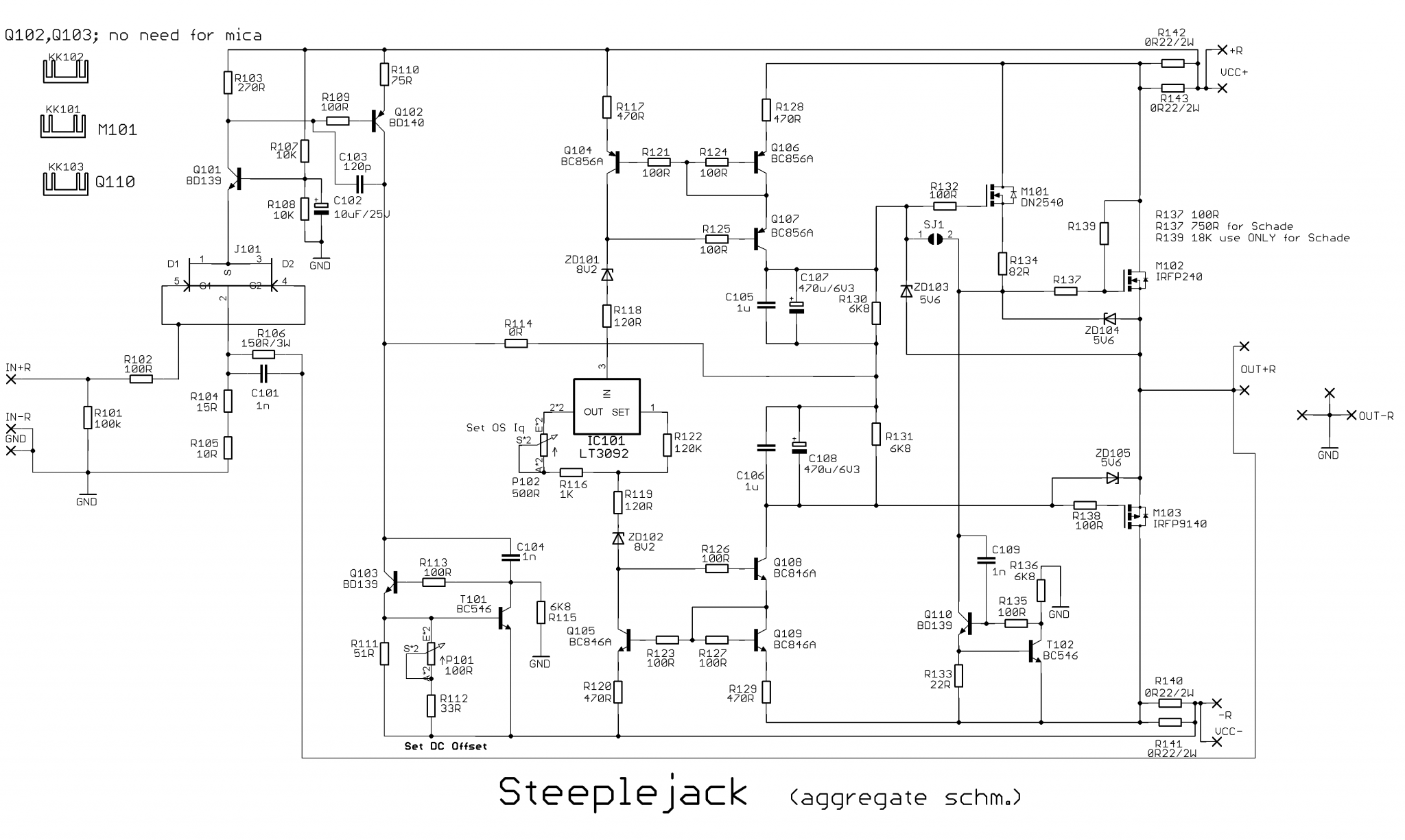

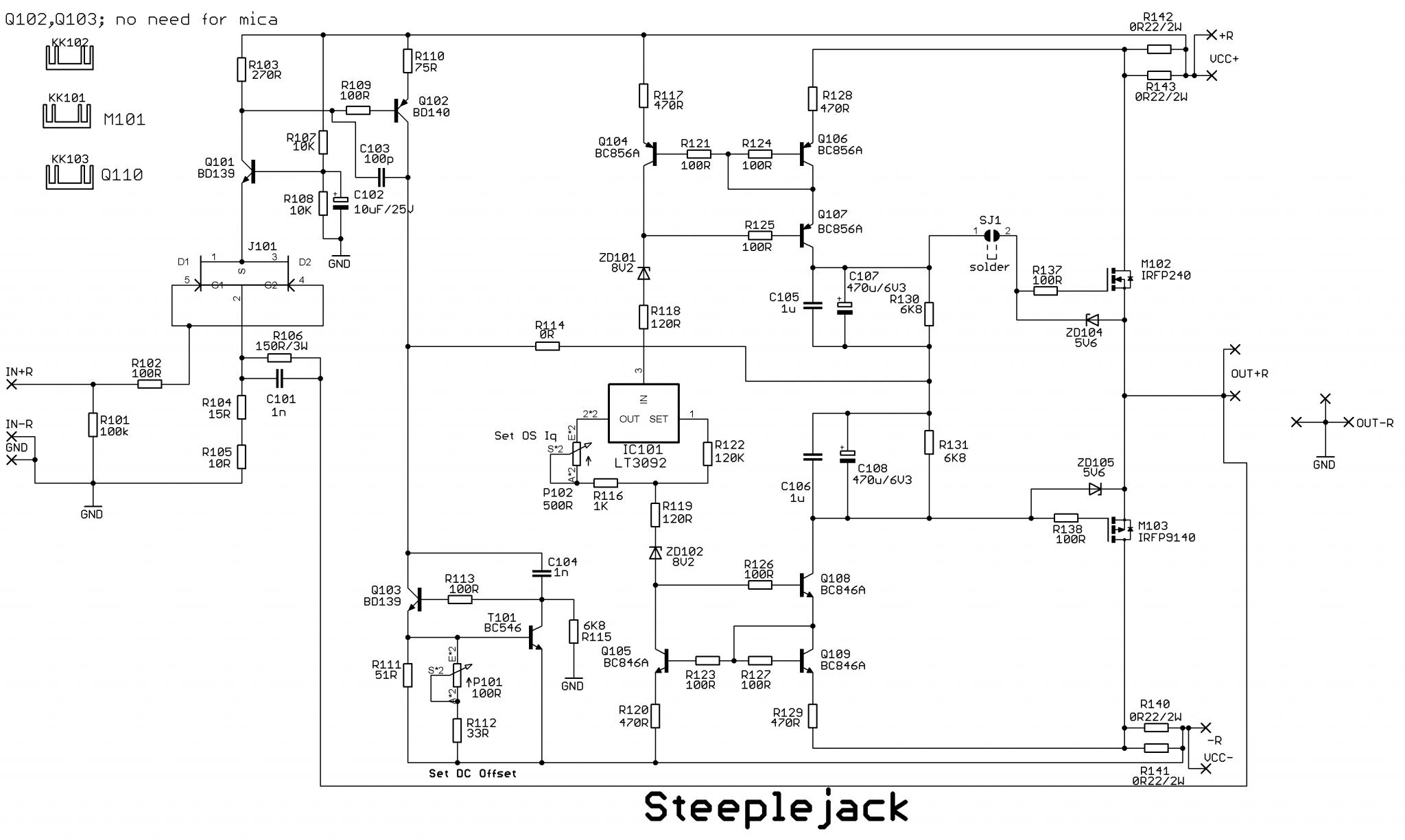

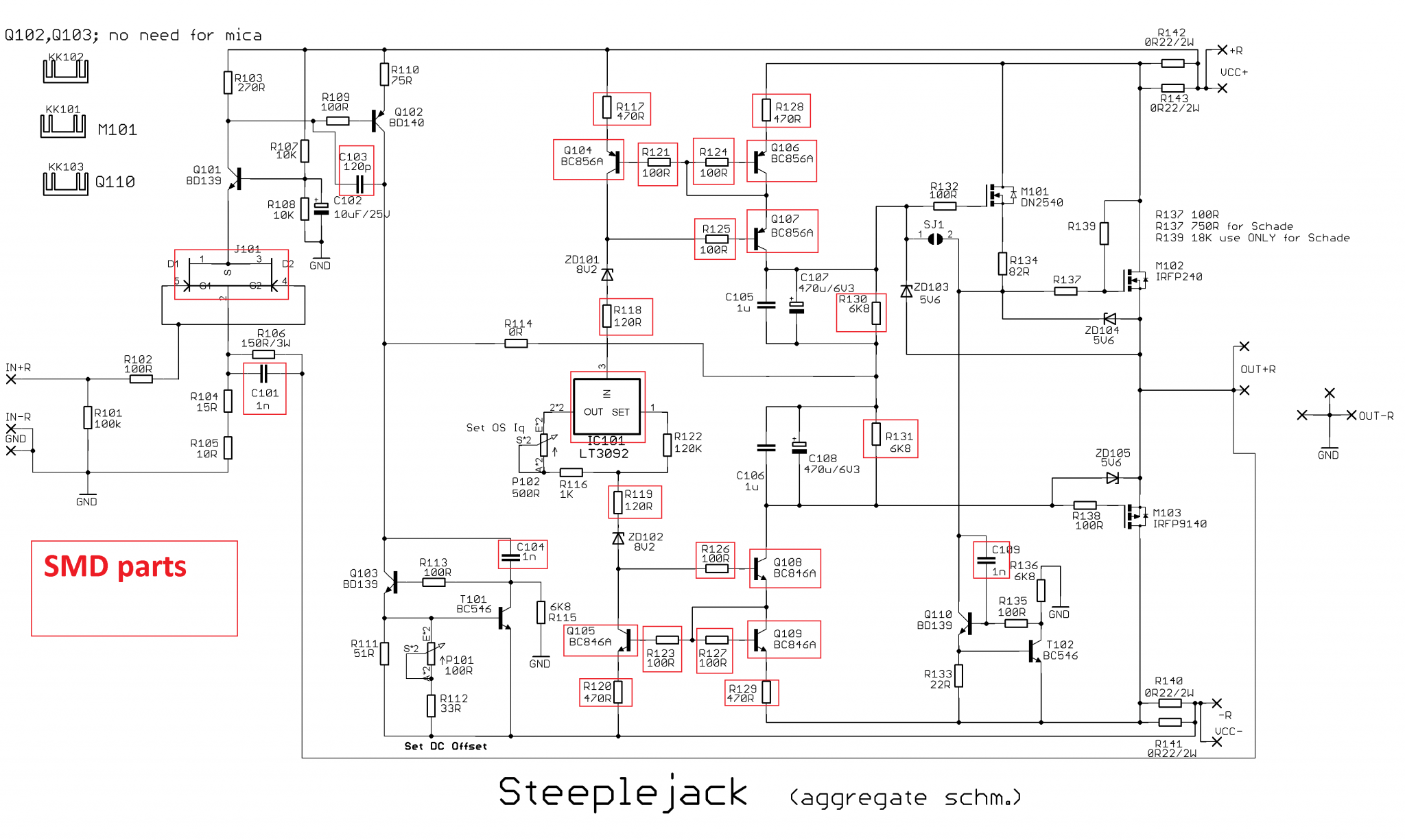

Ok, for starters usual set of graphic files
Schematic is aggregate, find separate ones for pure Mos and for Schade later
After that one, couldn't avoid my own greediness to try this combo too
Though, clever as I am, God's ways are his own and Buddha is everywhere........ meaning - better name for this one would be Mad Hatter, you'll see from 4R load behavior ........

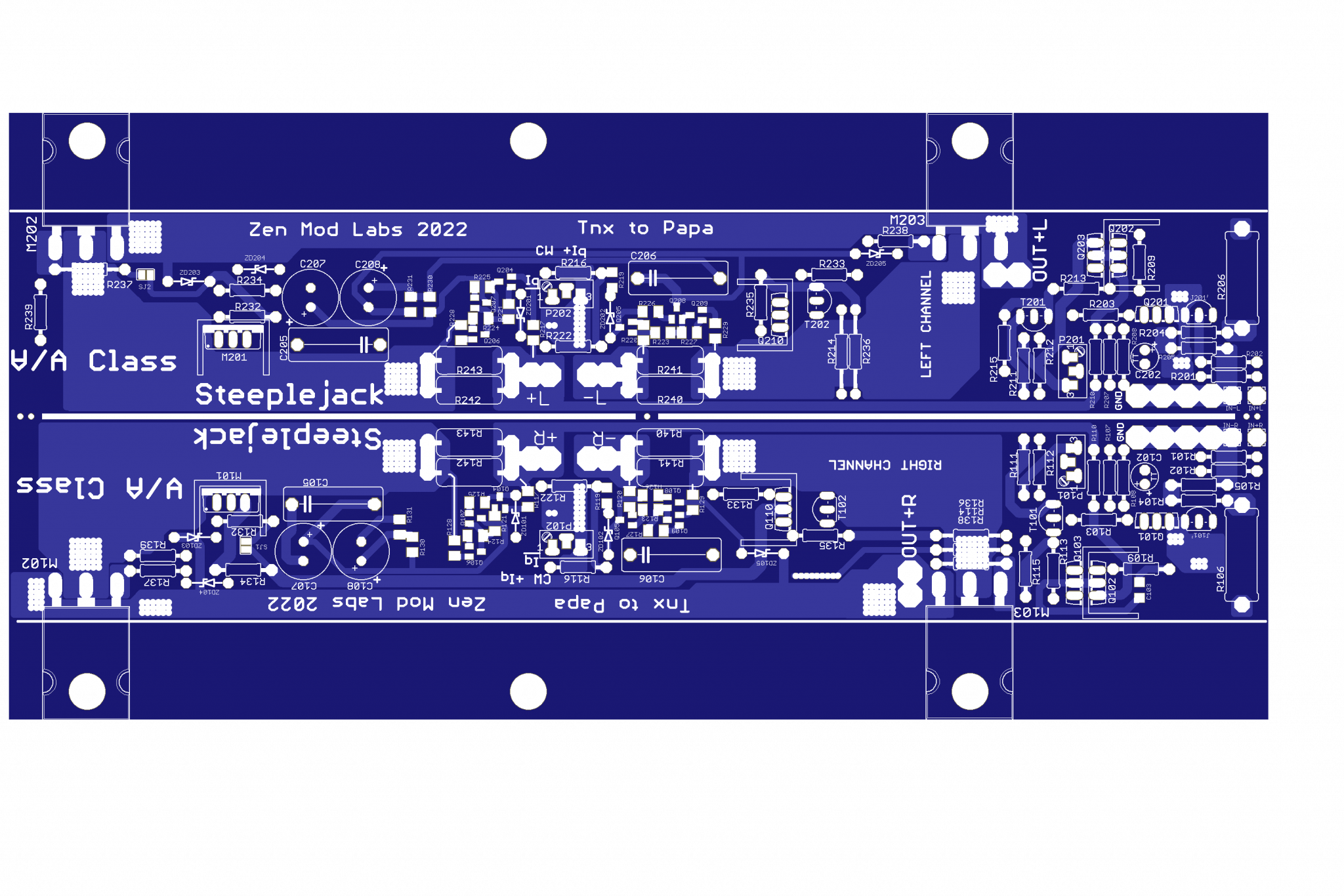

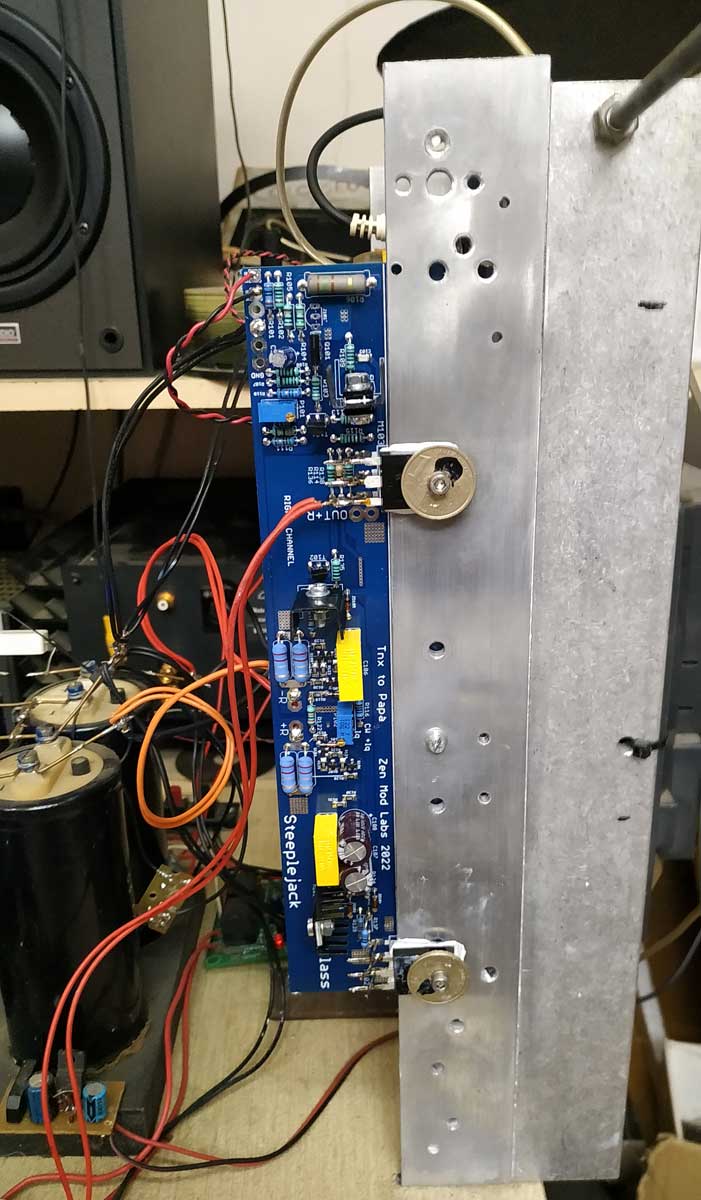

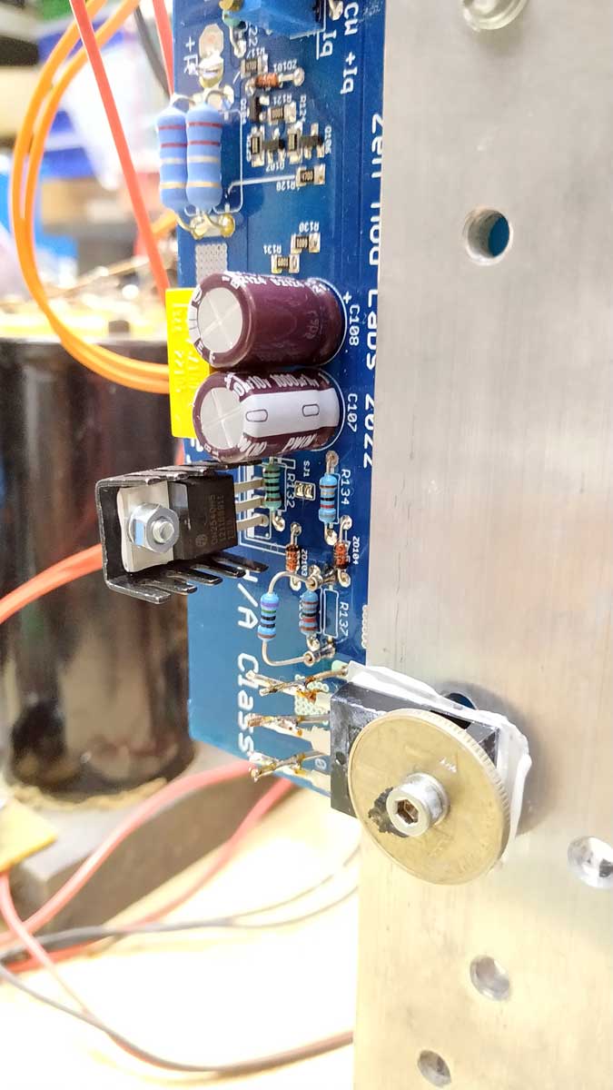

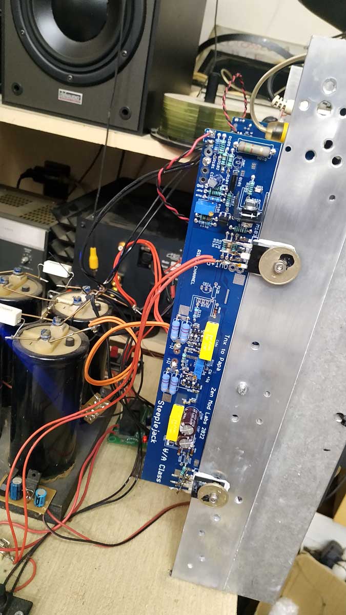

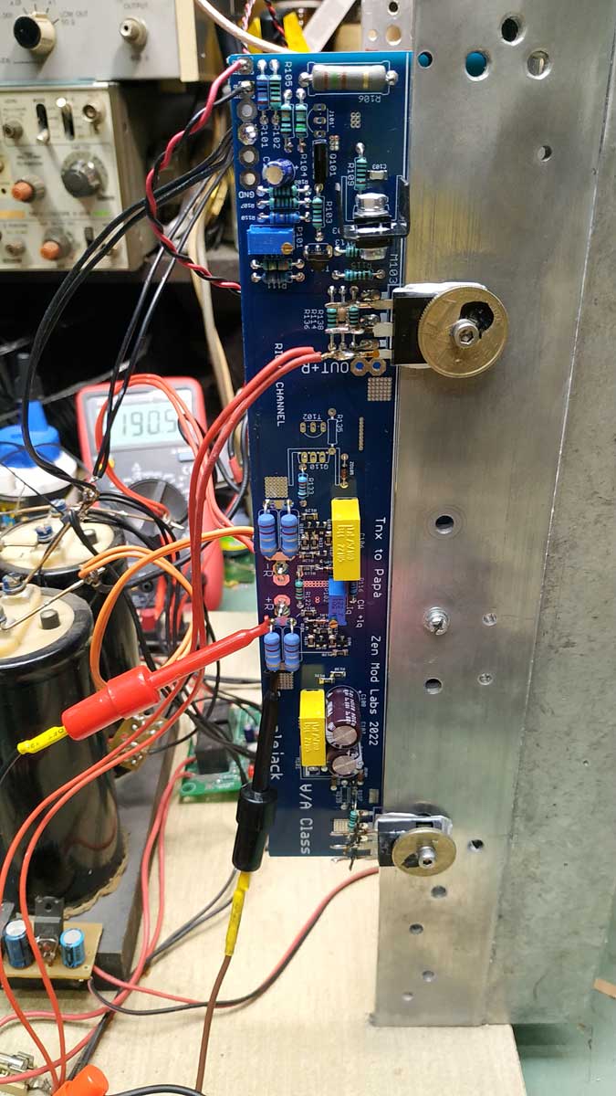

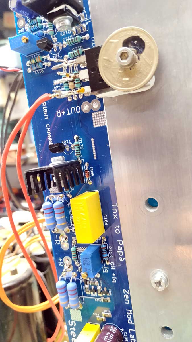

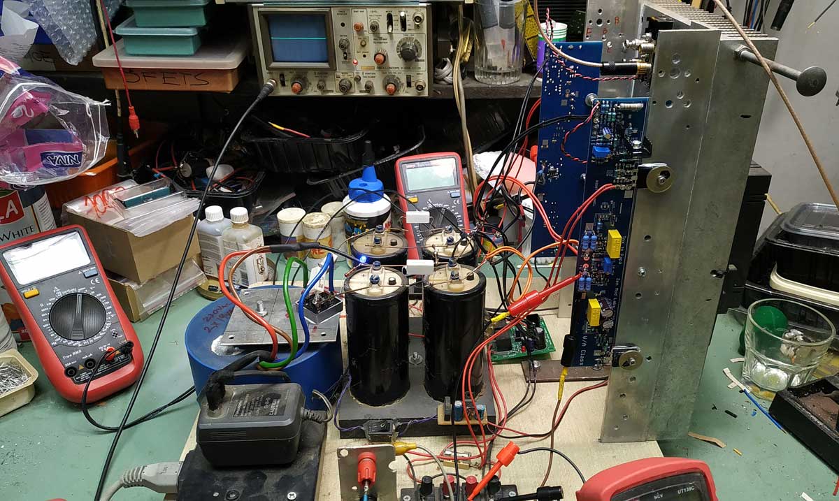

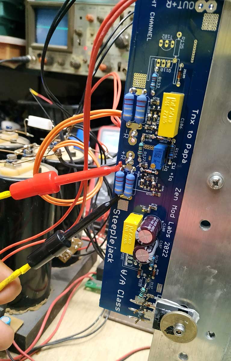

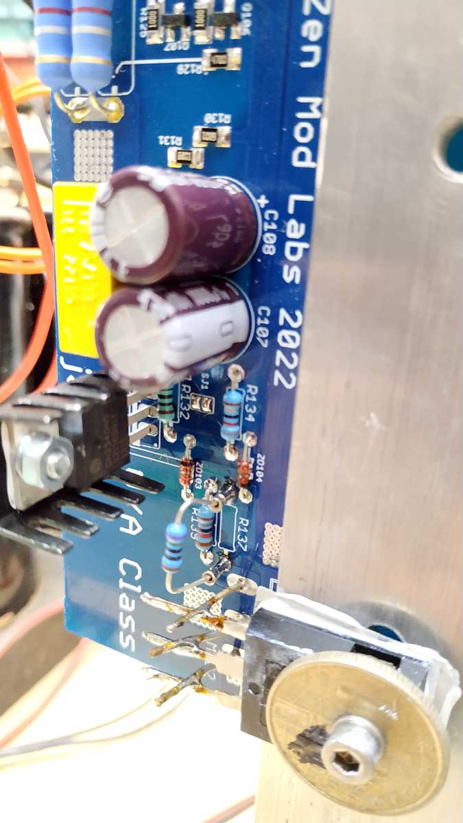

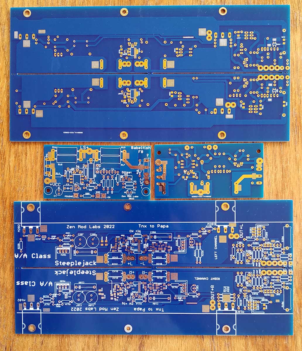

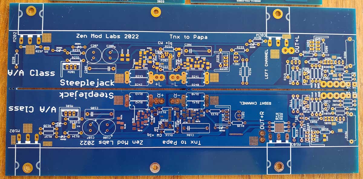

Got them pcbs, then had some usual fun

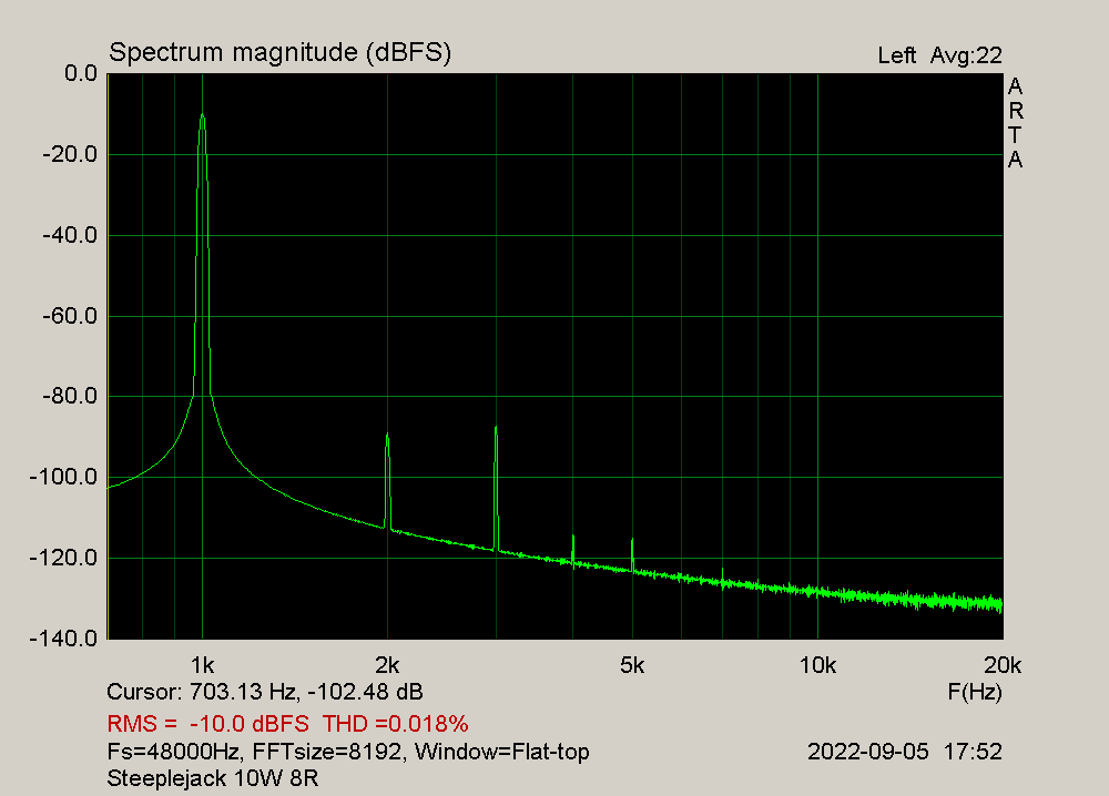

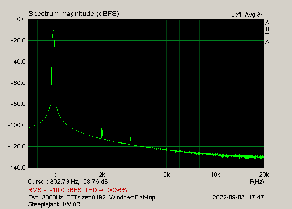

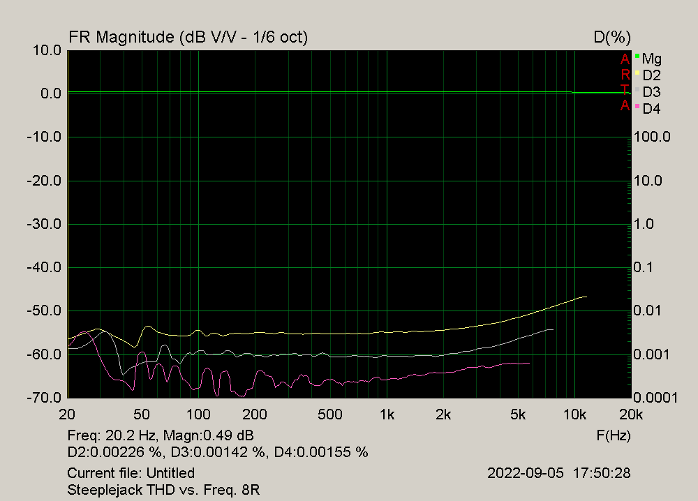

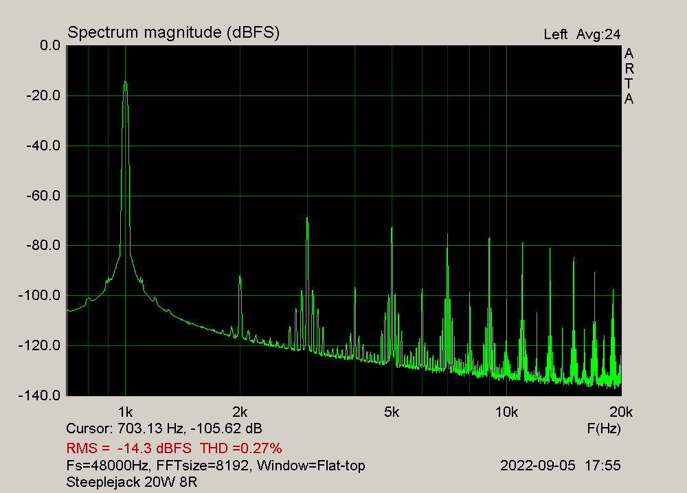

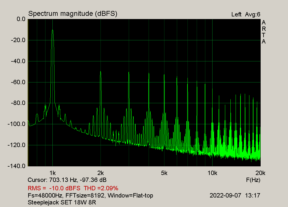

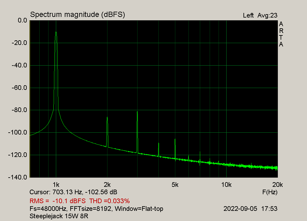

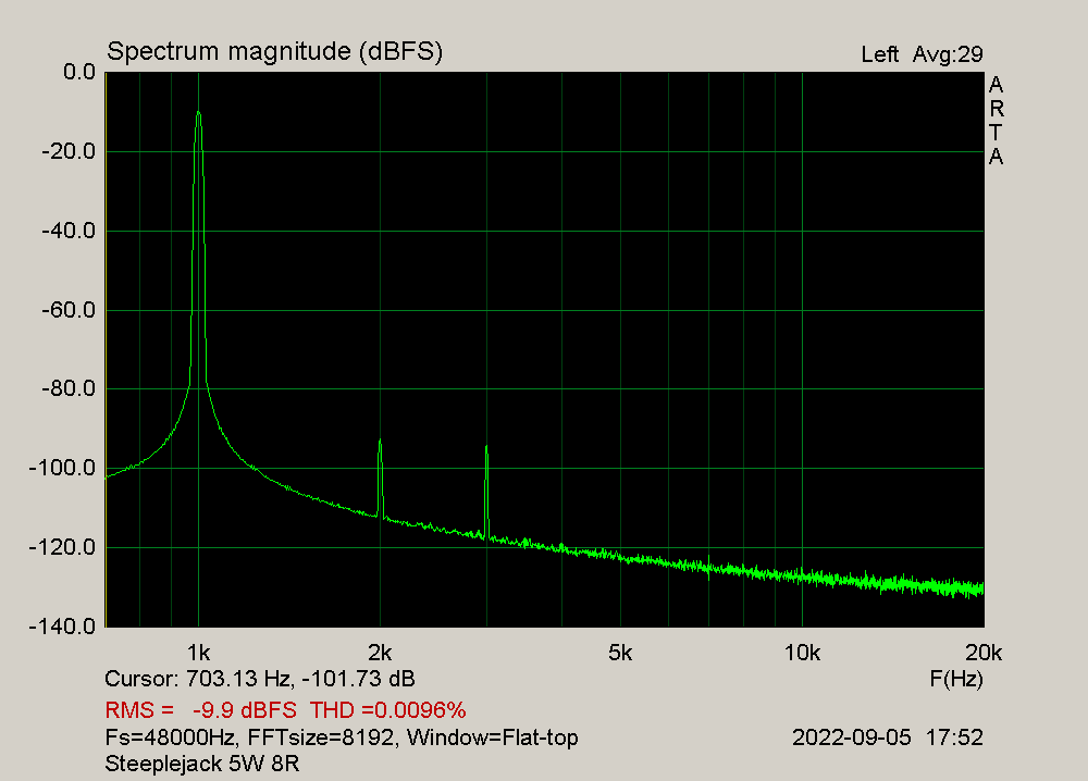

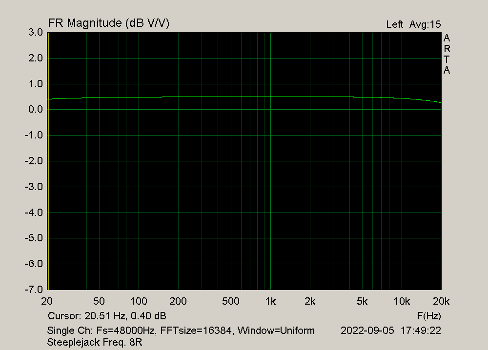

Proof is in Da Pudding, 8R load
call it Pinpoint Machine; sorta sweetish at 1W level, getting brutally detailed above
nominally 20W@8R amp, clipping around 18W
THD can be easily tweaked changing IRFP240 to (double xcoonductance) IRFP150; but no, wont do that, prefer Schade to add some Spice

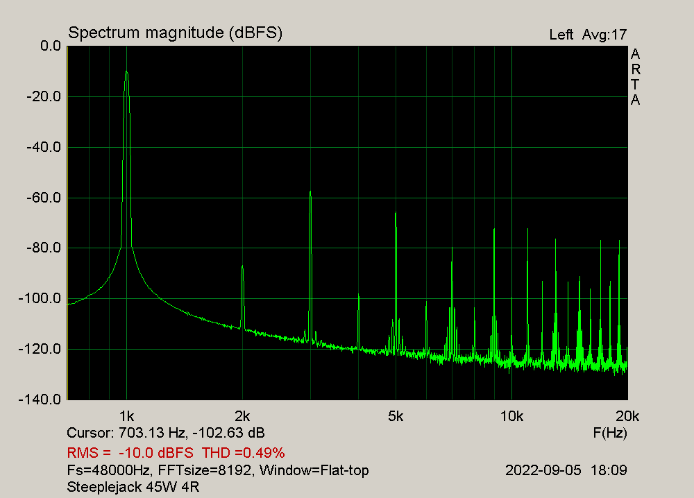

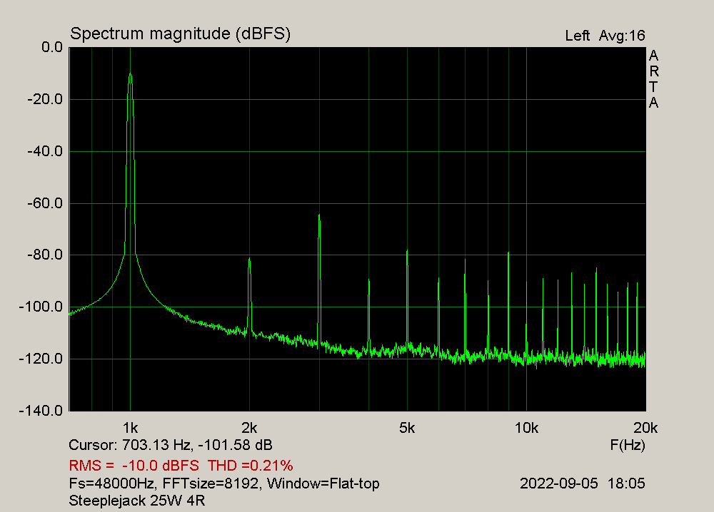

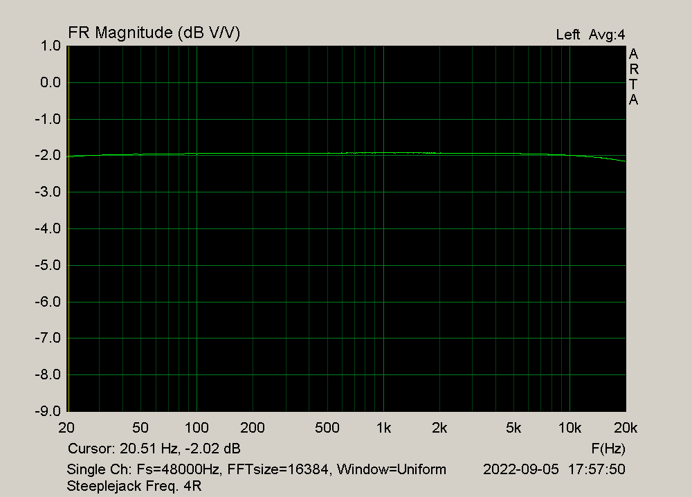

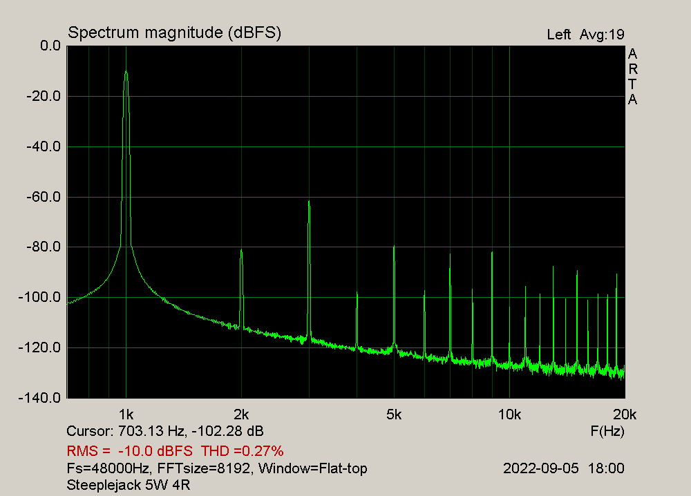

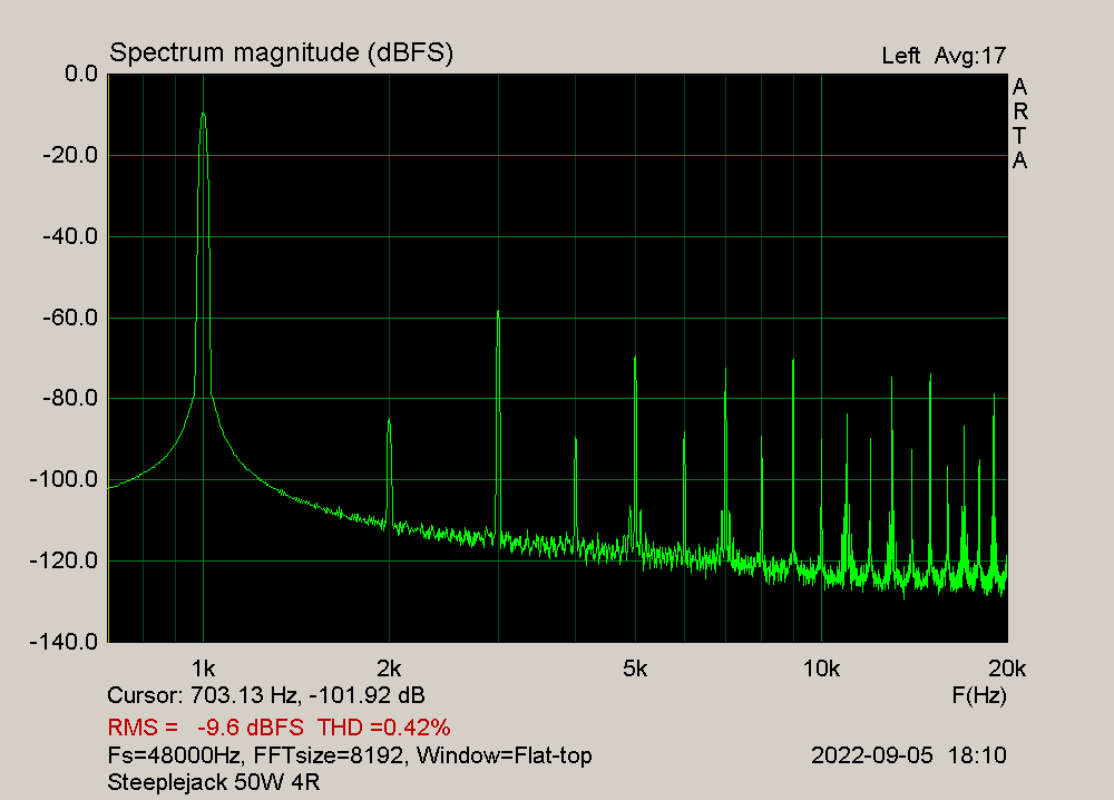

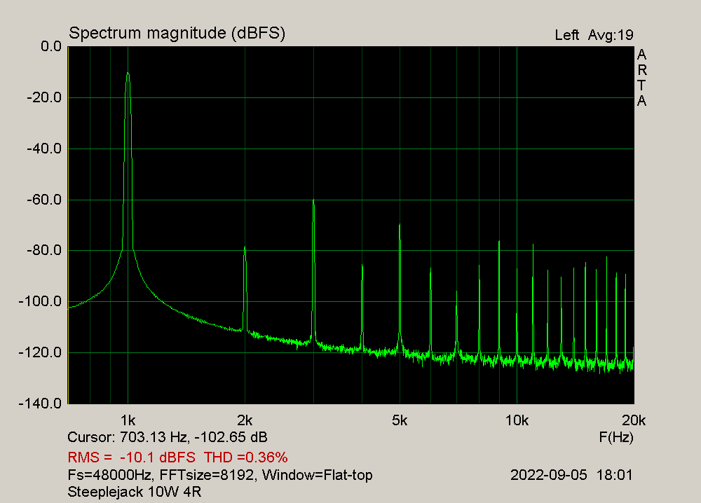

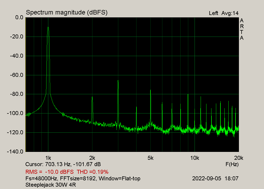

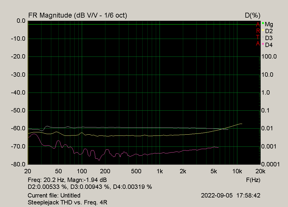

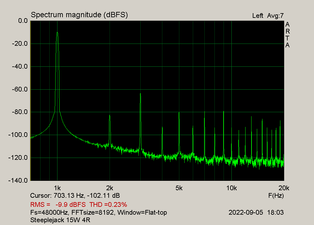

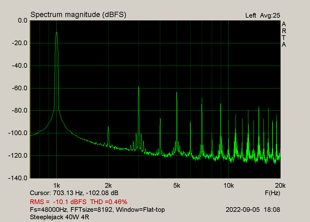

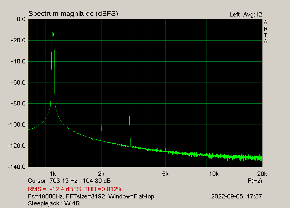

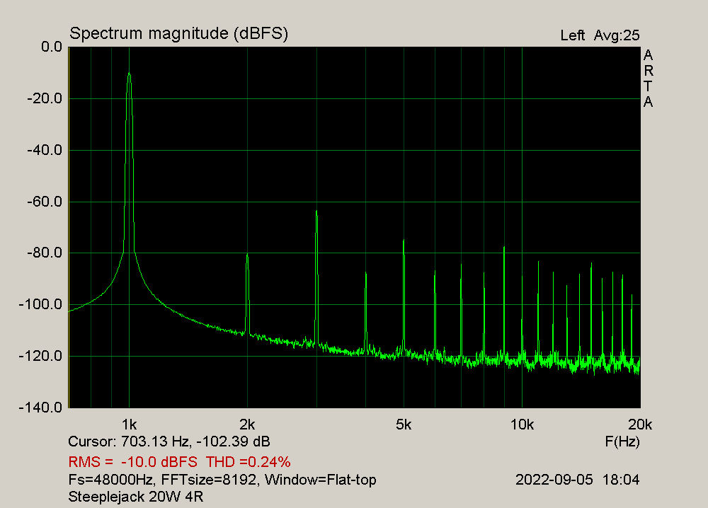

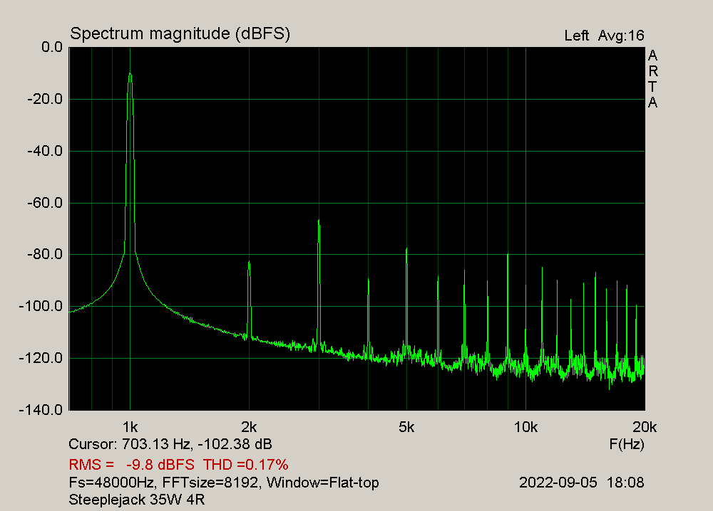

Proof is in Da Pudding, 4R load
Now things are getting wild, letting ZM to know that there is some Mightiness above his own ..... meaning - things are existing even when I can't find explanation

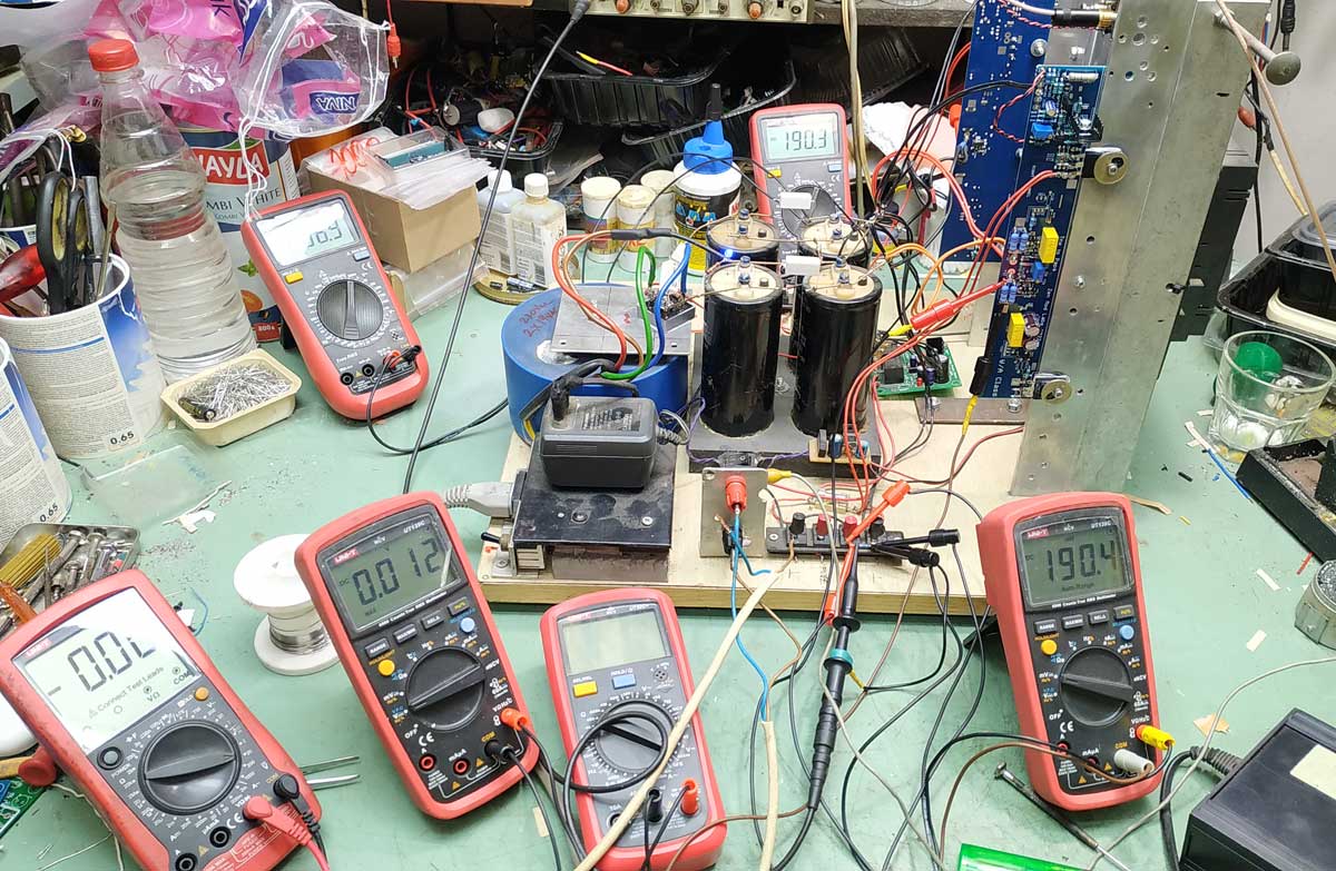

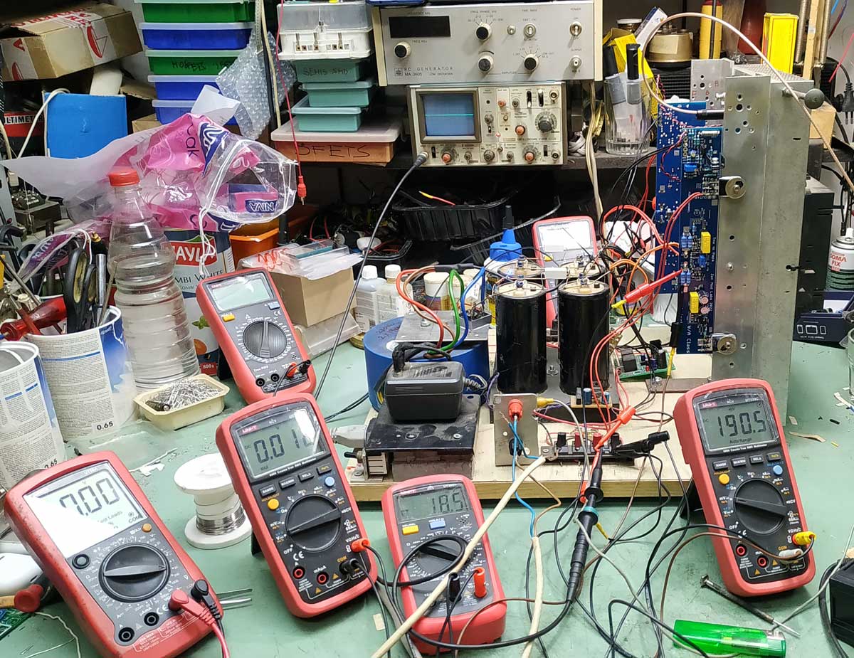

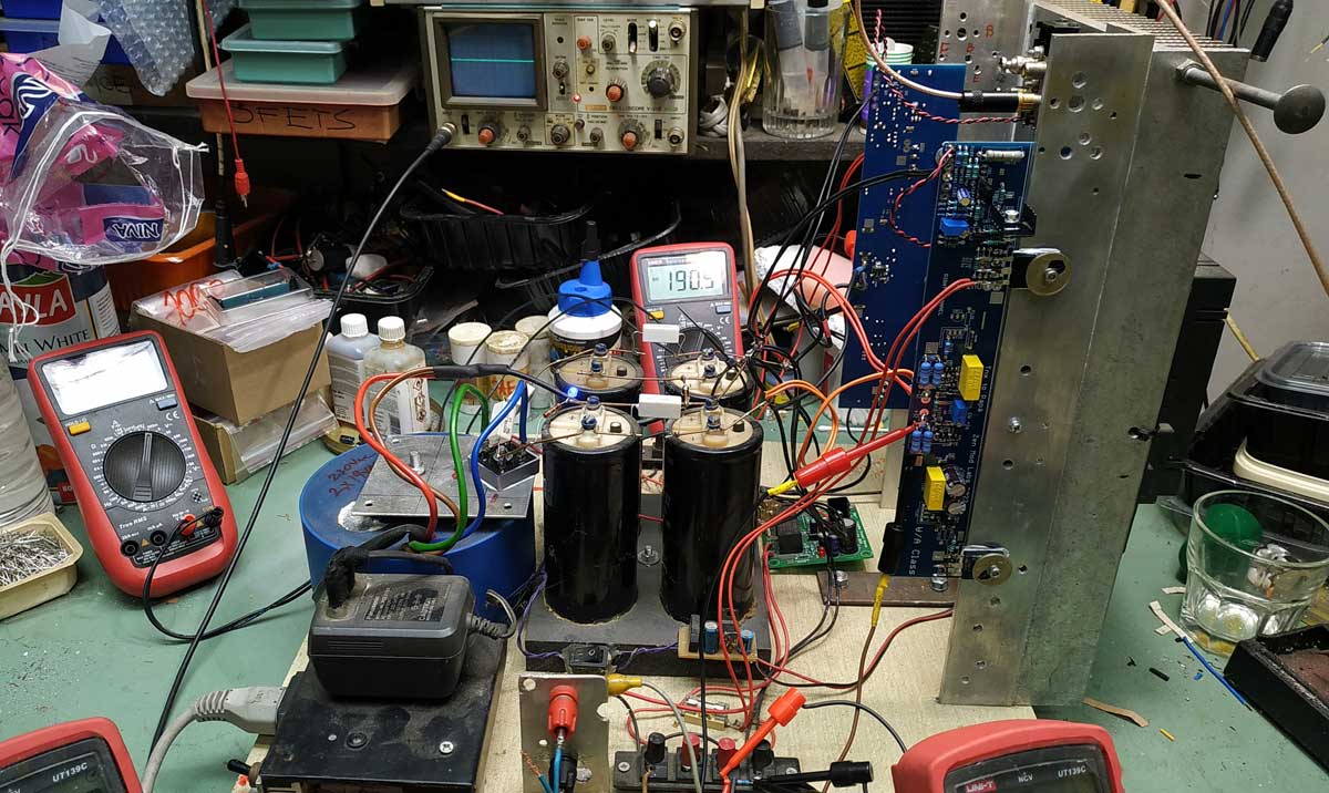

Iq stable as rock
DC Offset starting from -200mV, fast climb to 0, steady and stable in thermal equilibrium
no pops/clicks/farts during power On, power Off
will let you know tomorrow how it sounds, when I invest several hours in that part of fun
after few days of amusement, will proceed with Schade arrangement

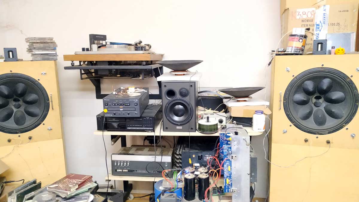

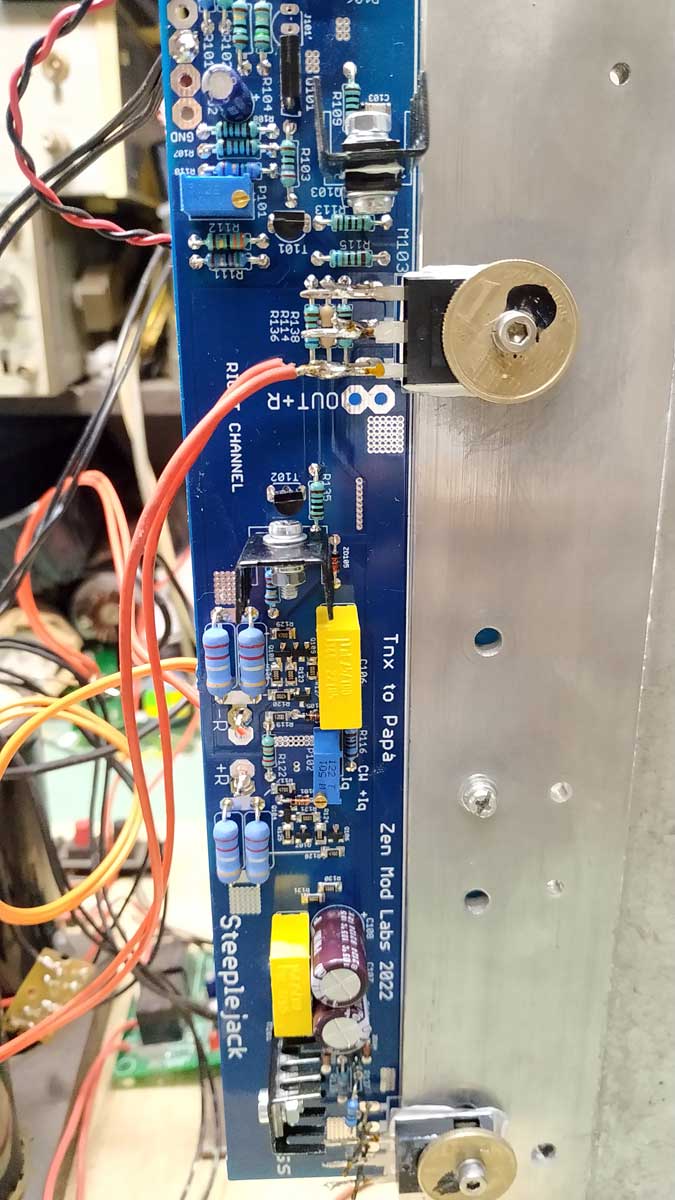

listening today for 6+ hours
it passed, with flying colors ...... Miles Davis Fran - Dance album, one of those I know every note in ...... enormous soundstage, Miles's trumpet is very critical - many amps failed, bringing it in ear shuttering way
nope with Mad Hatter ..... anyhow, Steeplejacks, Mad Hatters and ZMs of this world are sharing same sort of Wakoosnesssssssss
I hear every bloody grain on master tape, while not just having both feet tapping but also headbanging ( my usual behavior on jazz concerts) ......

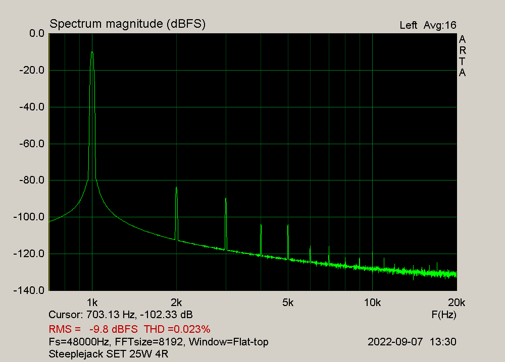

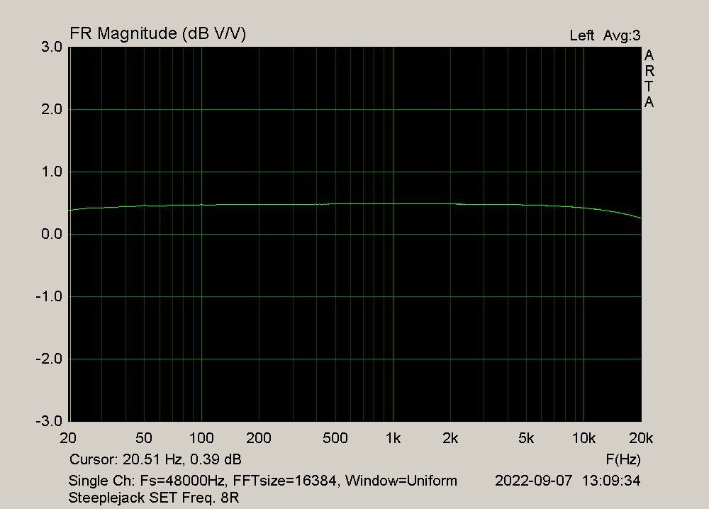

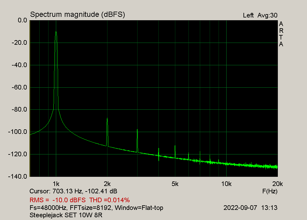

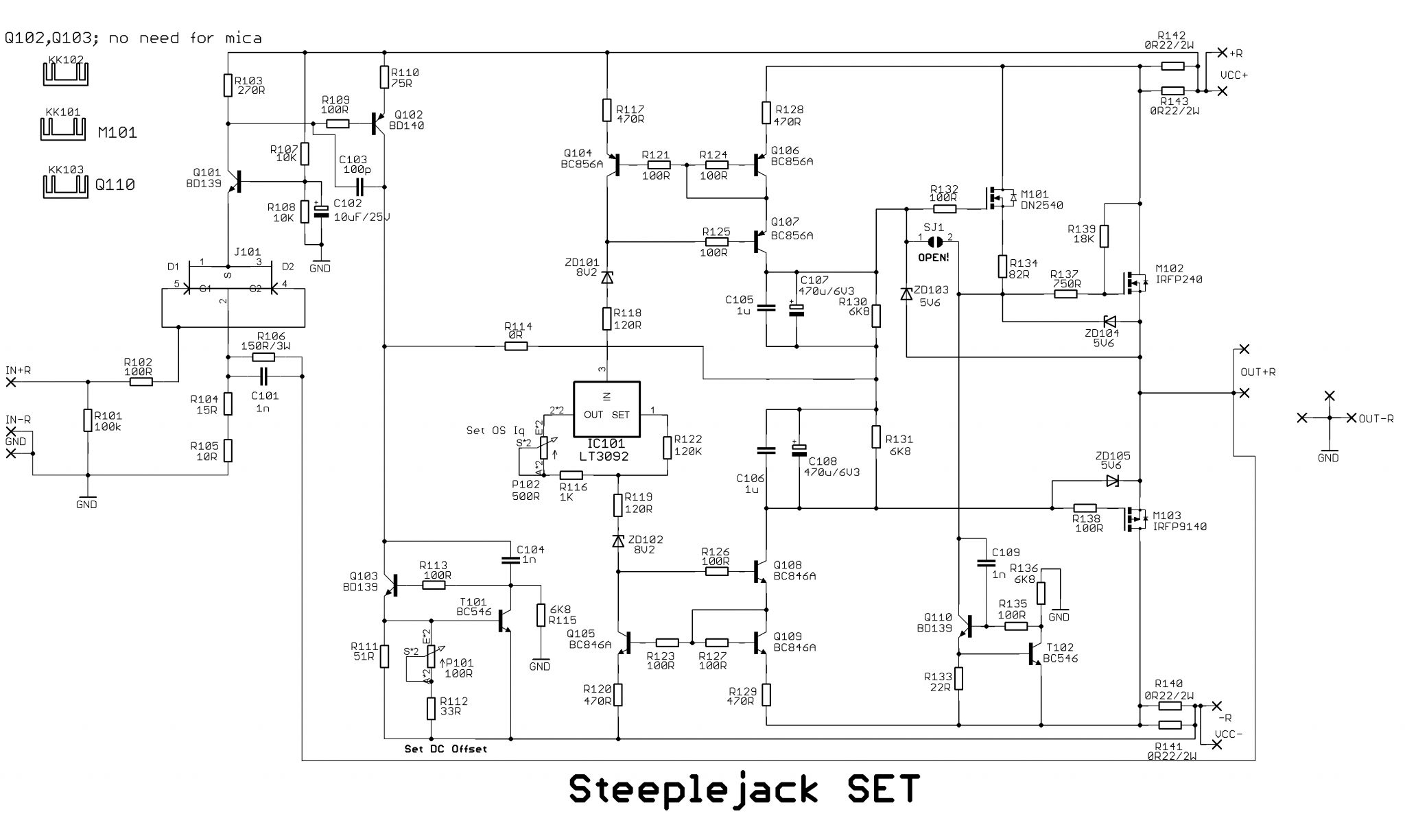

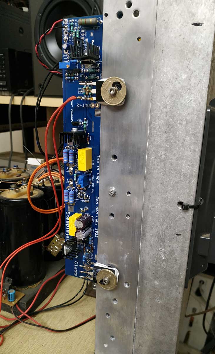

just finished conversion to Steeplejack SET (Schade Enhanced Thingie), meaning that upper mosfet is connected in Schade arrangement
all measurements done, it's already singing, and as I could expect, everything is slightly more in the face (comparing to pure MOS) , while I can still hear Miles thinking how it could be better that I didn't wiped clean damn spectacles prior to gig, probably lesser trouble with stage reflectors
ZM is Happy Camper, Steeplejack SET is Poor Men's Scryer ...... even for this one 300B Fetishists can eat my liver
I may have missed it, but what is your second set of ears thinking of this one?

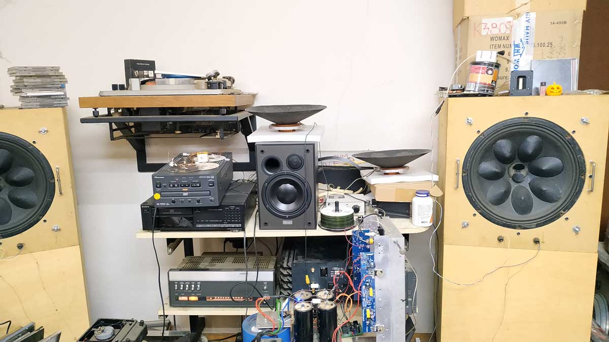

And stop working on speaker cones (first pic), and publish MORE AMPS
And stop working on speaker cones (first pic), and publish MORE AMPS![]()
yup, me too thinks that I got lazy of lately, doing nothing
will visit my Buddy these days, to let him hear
so, Proof is in Da Pudding, colorful part
Steeplejack SET, funny pics, schmtc

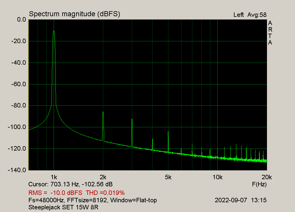

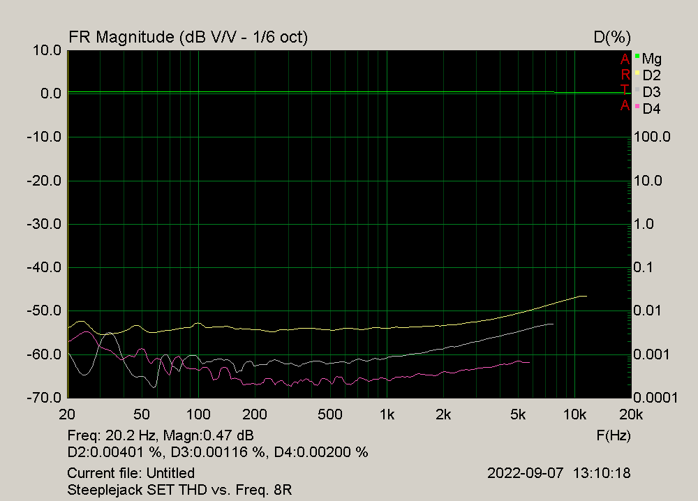

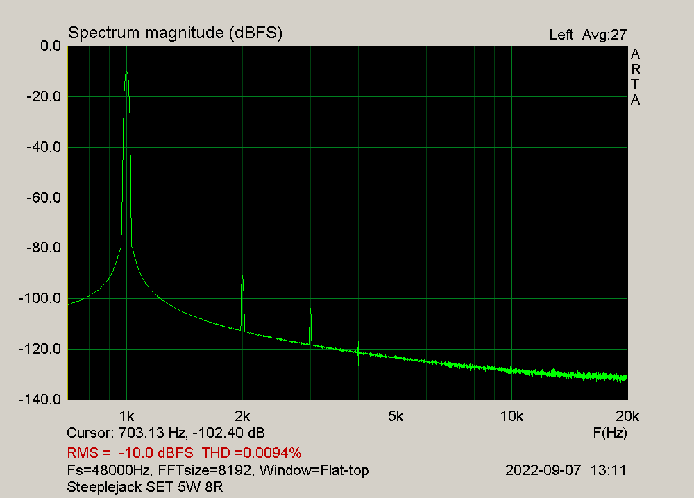

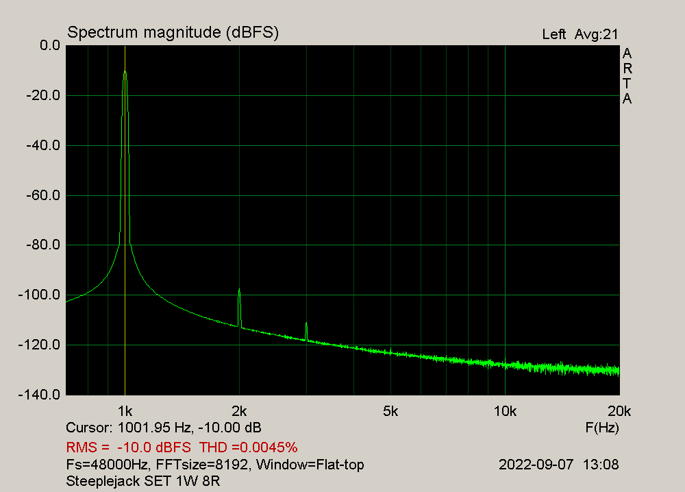

Proof is in Da Pudding, gigglywiggly part
basic settings same as noted in post #3
Load 8R
Load 8R

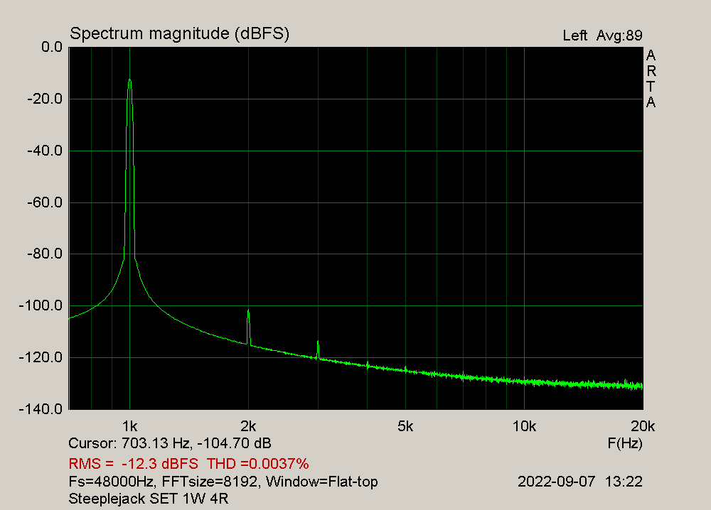

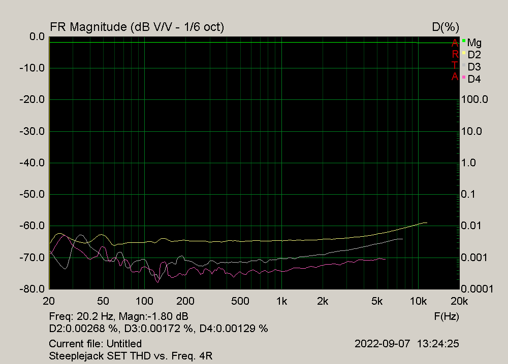

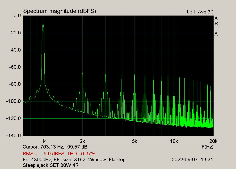

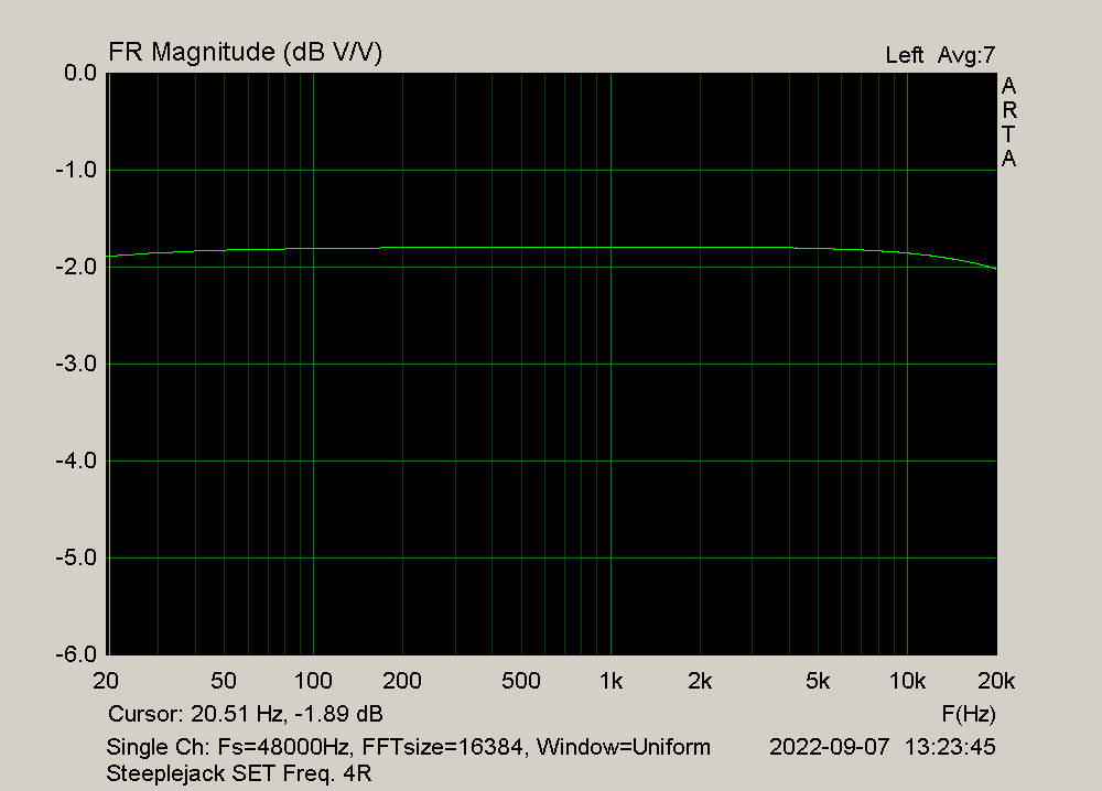

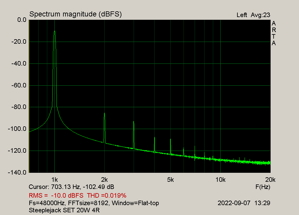

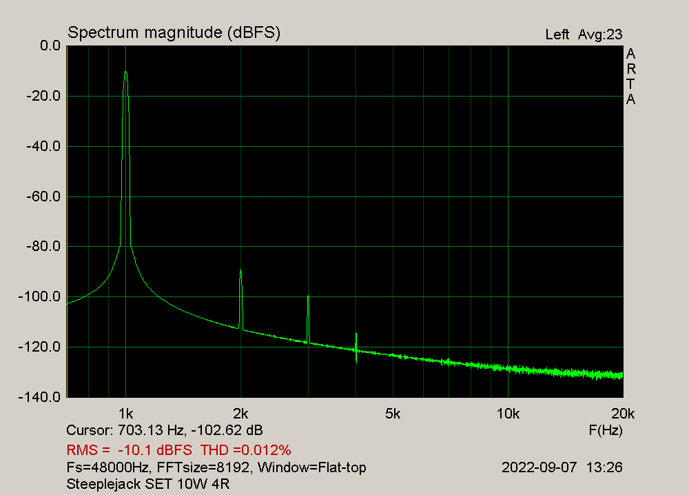

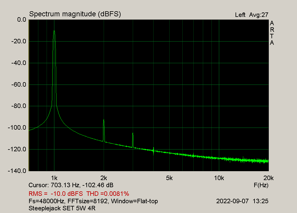

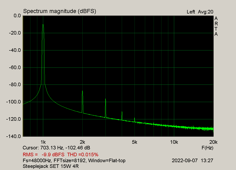

same, Load 4R
all in all ........ pretty good approximation of Scryer measurements, shown (starting from post #5) here: https://www.diyaudio.com/community/threads/scryer-or-how-f8-met-mighty-sissysit.388550/post-7078135
even if I didn't stretch my self for uncomfortable task to compare Scryer and Steeplejack SET directly, gone by always giggly auditory memory, but more by general feel of ease, measure of feet tapping and Dia of headbanging circle, these two are close enough
besides, pleasure being certainly enhanced with fact that I made another one, and didn't end in heap of Gray Smoke
