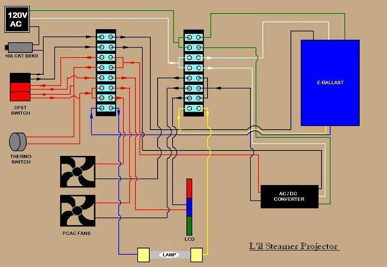

Had an interesting conundrum regarding my wiring. I plan to use 2 Evercool PCAC's for the system's cooling, and I found a 5A 12V AC/DC PSU, for laptops. I was trying to figure out how to wiring everything to one switch and have a temp controlled cooling circuit stay alive after shutoff. Every wiring diagram I found ar saw, used a DPST switch but was designed with 2 seperate power supplies for the 12V components, 1 for the LCD, and the other for the fan(s). I didn't have a lot of space to play around with. So I thought the single 12V supply would do. Long story short, the DPST switch was not going to work. Either I would not be able to isolate the LCD from the fan(s) or I would not be able to maintain power to the fan(s) without also powering the LCD. I came up with 2 solutions:
1) Get a seperate thermostat that would kill the power to the LCD, I couldn't figure the right temp that would let me do that right, or
2) use a 3PST (3 Pole Single Throw) switch and wire the thermostat and fans to the third pole, thereby isolating the fans from the LCD.
The only con I see is that there will be live power in the box after the switch is thrown to off, however I think that is the way all the wiring diagrams with a temp controlled fan circuit are setup.
Here's my diagram:

Steamer's Wiring DiagramLuca Brazzi said:Maybe Im missing something but why do you want to kill power to the LCD based on Temperature?
You are mistaken. I don't want to kill power to the LCD except by the switch, I am killing power to the fans based on temps. Blow up the diagram and have another look-see.
