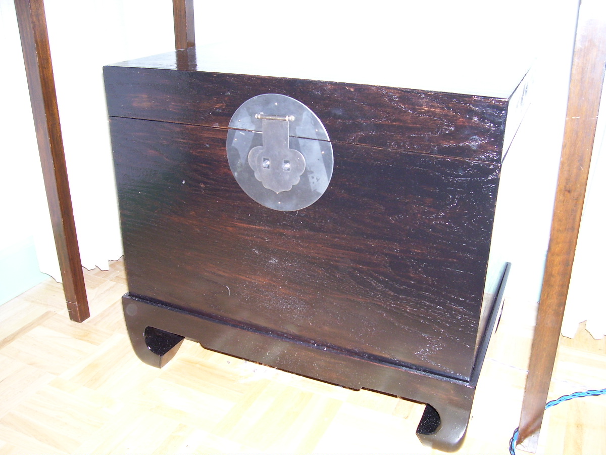

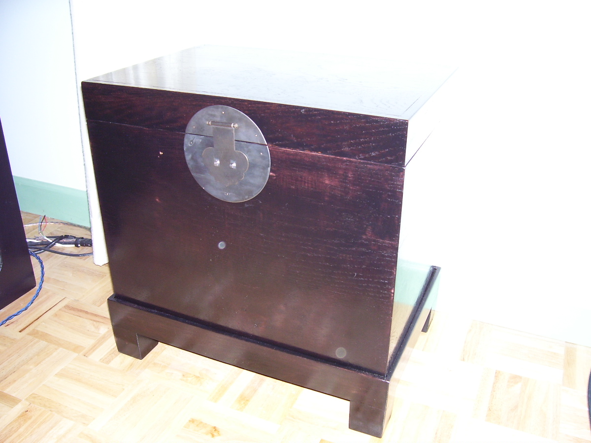

I completed my stealthy subs. They have been hidden as traditional Chinese chests. The finish was kind of a pain to make the semi-translucent old black lacquer by staining different under coats and dry-brushing black tinted poly with several clear over the top. In my decor, they hide completely. Being right behind the mains, they also blend very well. Very high WAF and still sound fantastic. Just a little creativity. Yes, they do not match.
Tech: Peerless 830500's in 60L sealed and tightly stuffed. Q of .59, driven by a Behringer crossover at 60 Hz and a Parasound 1200 amp.

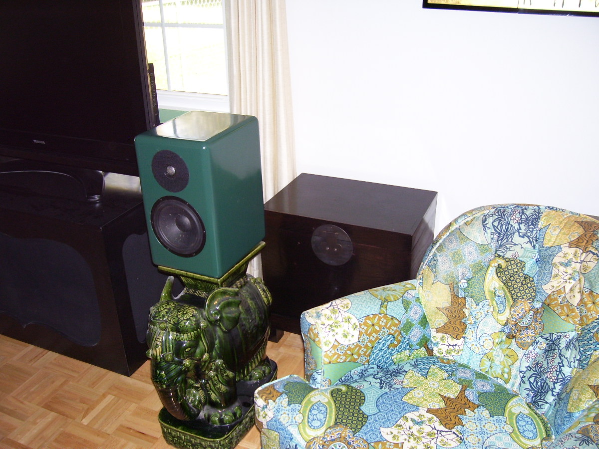

Nice! Got a thread for the little green two ways anywhere?
They are very close to the Zaph SR-71 but I used the metal dome tweeter of the same motor family and a felt ring around the tweeter. All 12 edges are 3/4 radius and the box is braced a little differently. Just a few tricks. 3/4 MDF, medium packed with wool. The baffle dimensions and radius are absolutely critical. A square edge prototype was unlistenably bright and harsh. I started with the soft dome. It is very good, but we found a slight advantage in detail with the aluminum dome.

The reverse hoof foot was a bit of a thinking challenge. Another bit of stealth, the taller of the two the top actually opens for a 2 inch space where my wife can hide a couple music sheets as the sub sits next to her keyboard. The shorter one is total faux.

I do hope you will do some serious bracing to those boxes. A trick I have used is to epoxy a ceramic floor tile ( 12 x 12 ) to the inside. Very rigid for not much space.

Yep, I'll brace the crap out of them.
Looks like Realistic Nova 7 components, also Optimus 4
Yep, they are realistic speakers and share components with the speakers you mentioned.
