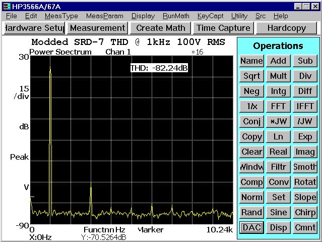

To further dispel the notion that these transformers are so poor as to be unworkable, here's harmonic distortion of the modded SRD-7 at 1kHz and 100V RMS output. A good result, I'd say. Going by the amp's volume pot setting, this is the level that I normally listen at, corresponding to ~ 99dB spl with the SR-X cans.

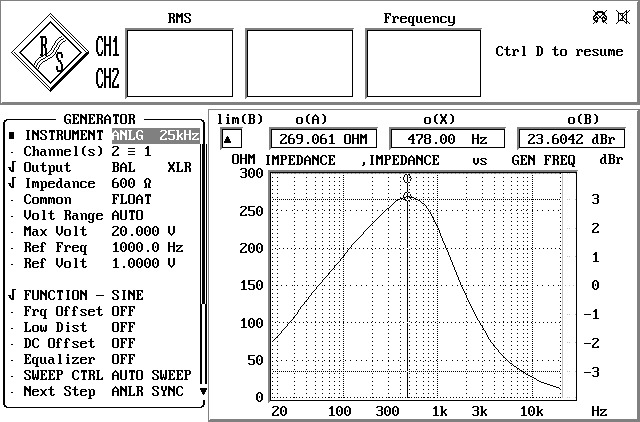

This is what I got when I measure the Input impedance of a STAX SRD-7 pro mk2, doesn't seem to match to what was posted here, hmm
Asssuming your measurement setup is correct, was the transformer output terminated, with headphones or 75-100pF ?
Check both channels to see if they are the same.
I'd check the impedance of the PTH. From what I've seen, they go high with age.
