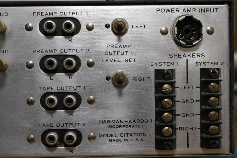

I stumbled across this post while looking to order another "Stax Style" plug.
I just got a "harman kardon citation eleven" to restore from a well known auction web site, it looks like its incredibly well made, but with capacitors that old I will need to replace them all.
The "Power Amplifier Input" socket is the same socket as a Stax socket and the "86-71-6S" fits perfectly, sadly my preamp has the screws missing from the speaker binding points.
I agree with what I read that it would be unwise to use more than 60/100W through the plug and switch though.
