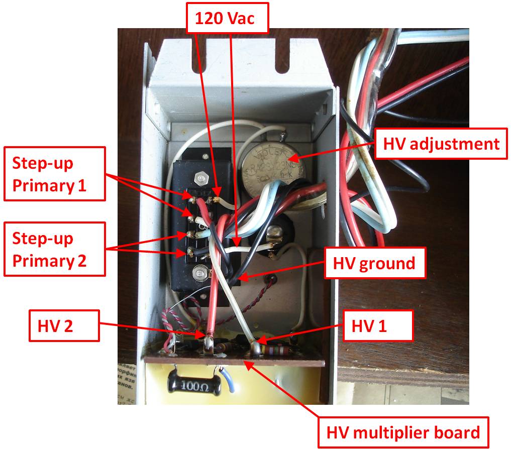

I have 3-band STAX ESS4A but regrettably without conecting cable which contain power and signal. I managed to feed the power but still having difficulties with signal: 2 pais of wires red-black and white-blue are joins input socket and tranformer. Transformers inputs are black-blue shows 0.9 Ohm and red-white shows 0.9 Ohm. They are plaing while signal fed to black-blue and red-white but very quiet. Probably I have to make a parrallel connection of any circuits? I'm afraid to make it wrong. Share your wise, guys, please. - How to feed signal the corredt way.

I have 3-band STAX ESS4A but regrettably without connecting cable which contain power and signal. I managed to feed the power but still having difficulties with signal: 2 pais of wires red-black and white-blue are joins input socket and transformer. Transformers inputs are black-blue shows 0.9 Ohm and red-white shows 0.9 Ohm. They are playing while signal fed to black-blue and red-white but very quiet. Probably I have to make a parallel connection of any circuits?

HV power
You say you have the power applied to the speaker. This should be 120Vac through the two white wires shown in the attached figure. You can use the knob on the outside of the box to adjust the level of the HV(bias voltage). The output should increase as the HV level is increased. You want to adjust it as high as possible without hearing hissing or crackling from the panels. There are separate levels of voltage fed to the bass panels( HV1) and the midrange/tweeter panels(HV2).
As Bear already mentioned, if you can't get much output from the speaker, the HV supply is most likely the problem.
You will need to verify the HV1 and HV2 outputs.
Audio Signal
The "A" version of the model 4 was designed to have 2 modes of connection:
1) low impedance mode for use with solid state amplifiers
2) high impedance mode for use with OTL tube amplifiers
This is done by winding the step-up transformer with 2 primaries windings.
Hook the two windings in series to get a high impedance load for OTL tube amplifiers.
Hook the two windings in parallel to get a low impedance load for transistor amplifiers.
You say you measured 0.9 ohm between the black and blue wires.
You say you measured 0.9 ohm between the red and white wires.
These will be the two primary windings.
If you are using a transistor amplifier, you should hook the two windings in parallel.
I would guess hook red and blue together for the (+)audio input, and hook black and white together for the (-)audio input.
The output should be about the same as hooking audio signal to just (red-white) or (black-blue) separately.
The difference will be the high frequencies will be better with both windings hooked in parallel.
If hooking the two windings in parallel as described above produces less output than one primary winding alone, reverse the connections to one winding. No damage will come to the amplifier or ESL by connecting the two primaries incorrectly.
