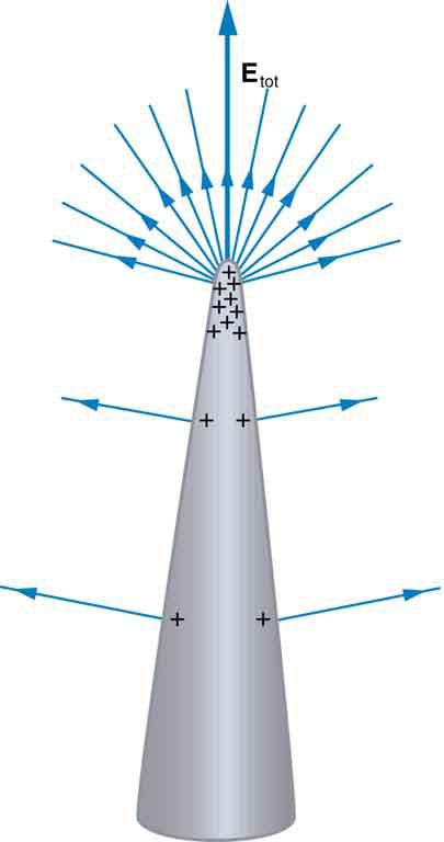

I find that touching a grounded surface with a conductive object like a key in your hand can lessen the pain of the shock.
I suspect this is because the intense electric field at the point of the key ionises the surrounding air molecules.
If we assume the person and key to be positively charged, +ve ions will be repelled away from the point, while -ve ions will be attracted toward the point - thus tending to neutralise the +ve charge on both key and person.
